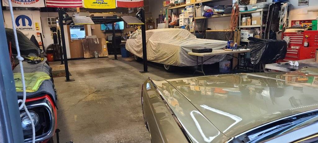

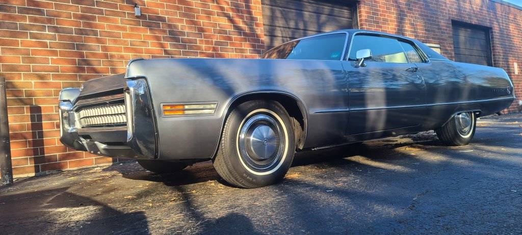

Took the NYer out for one more spin this year.

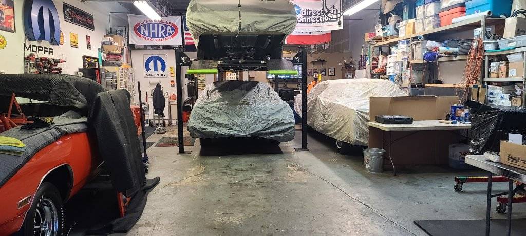

When I got back the the shop, shuffled the cars around and got them ready for their winter nap.

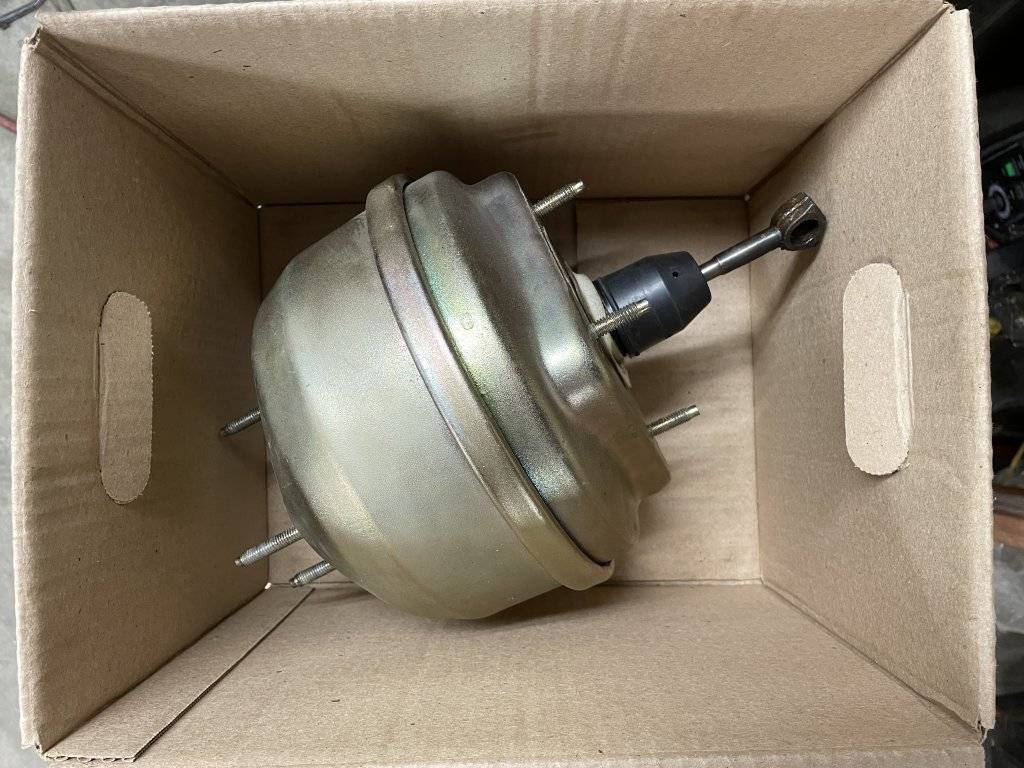

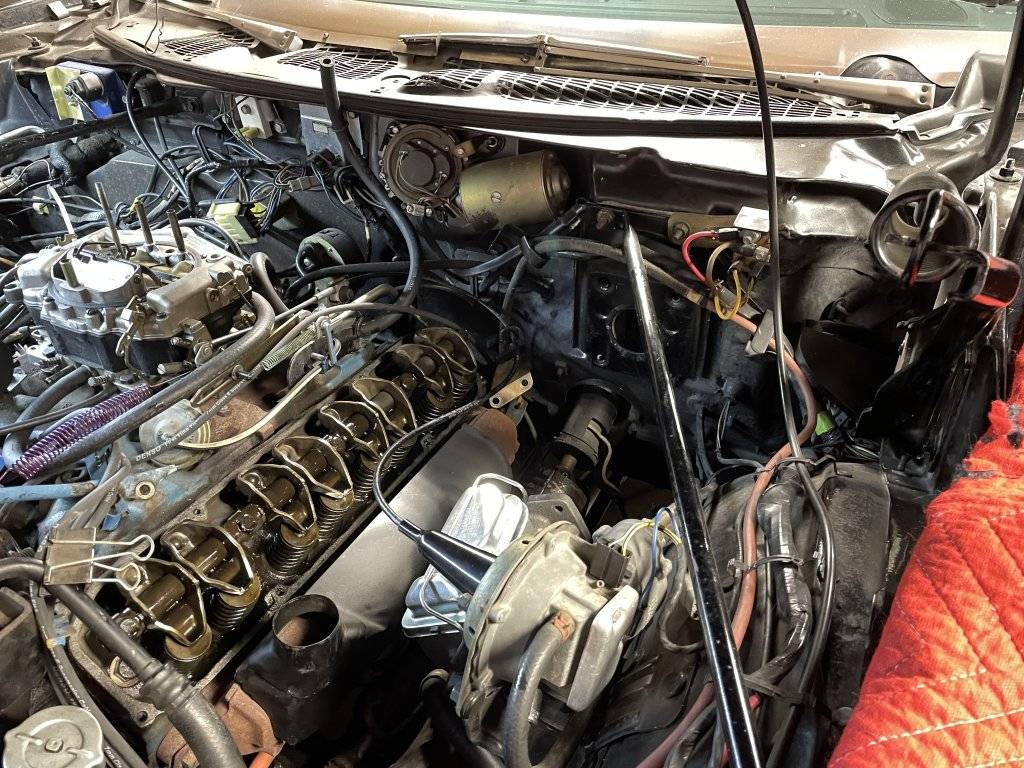

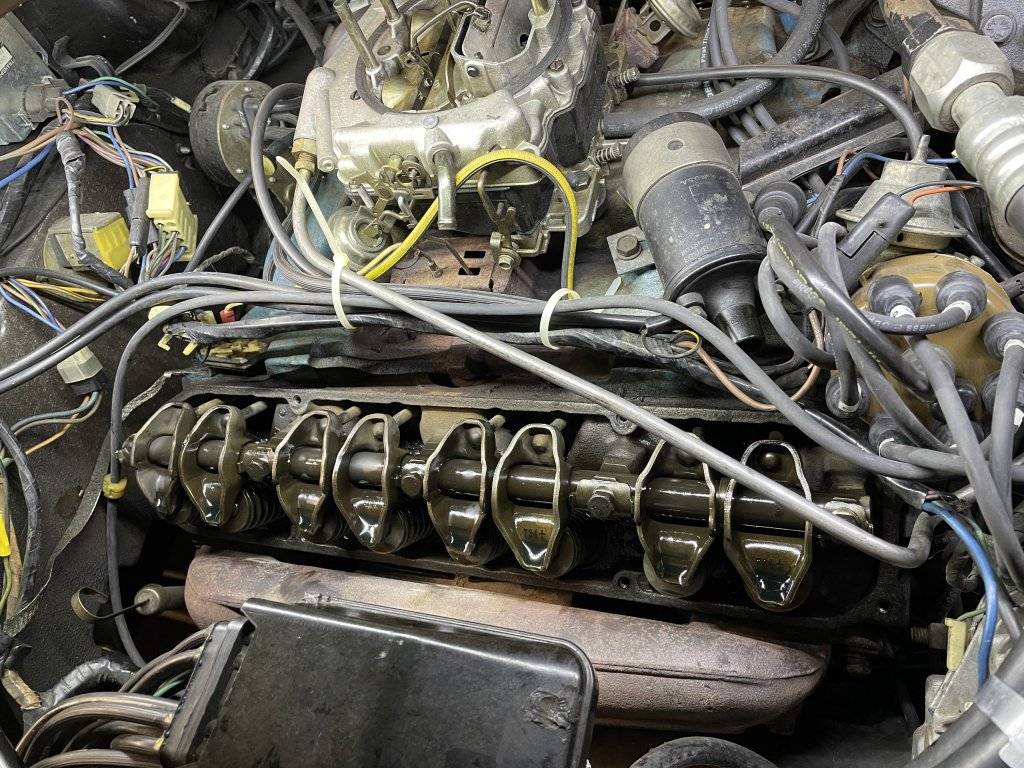

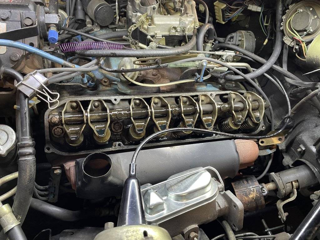

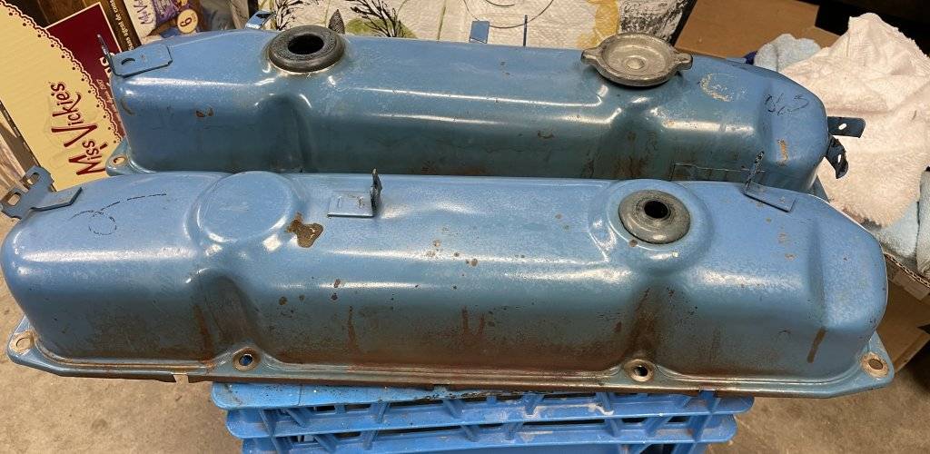

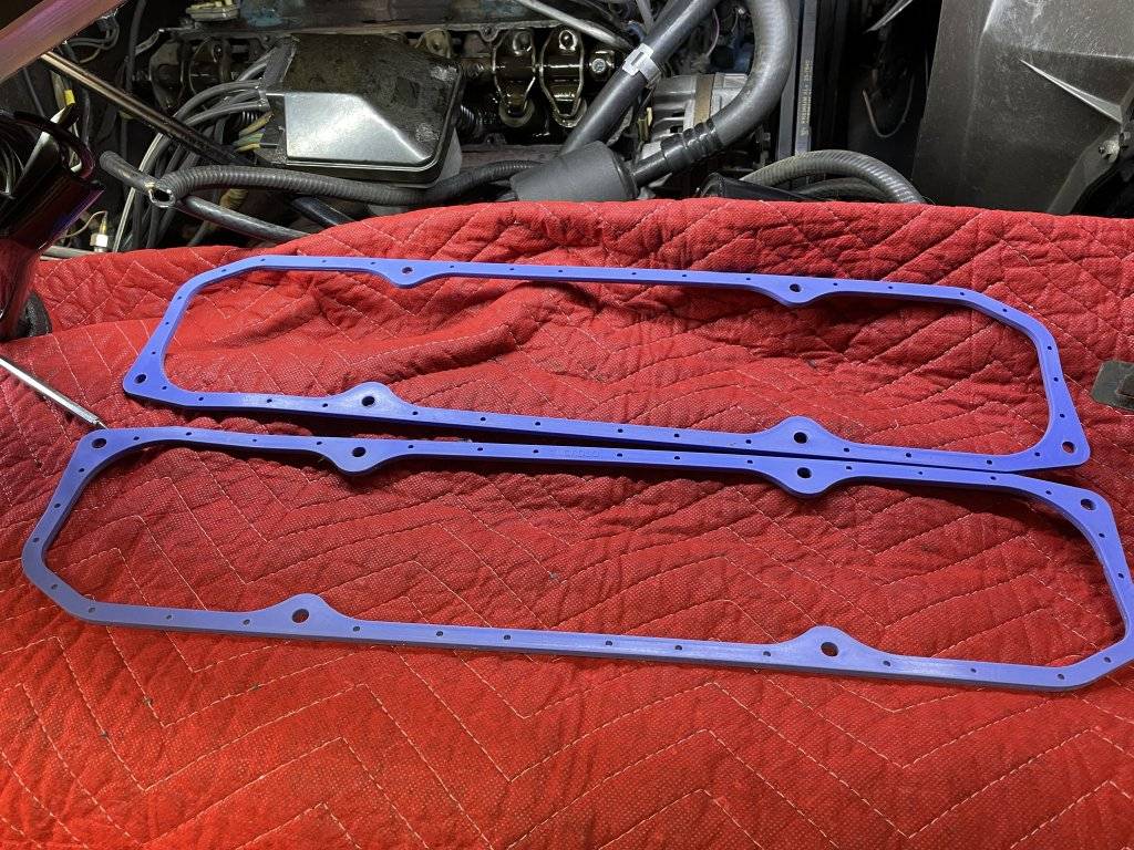

I pulled the the not so good rebuilt brake booster in order to return to rebuilders for them to have another go at it. Then I figured it was a good time to replace valve cover gaskets while I had the extra working space.
Hope this expensive fancy gaskets work.
I used the same valve cover gaskets on my 72 Imp.
No leaks and waaay better than cork.

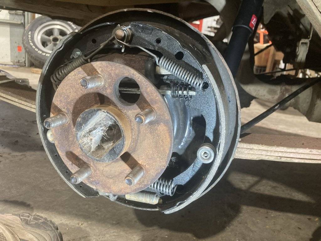

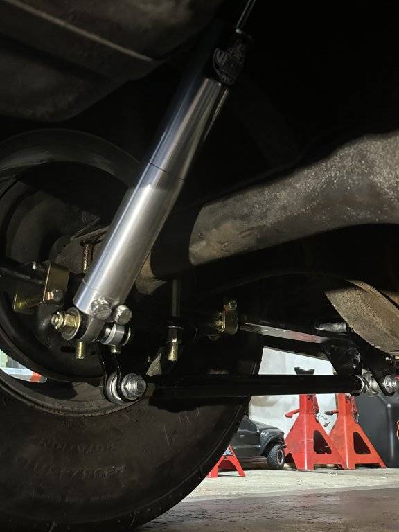

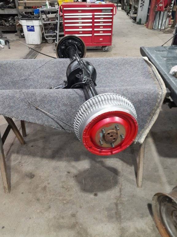

Pinion seal started leaking on the RR this summer so time for a freshenup. Added a sure grip, brakes, wheel cylinders, bearings, seals,and new Detroit Eaton springs, yah know since I'm already just gonna do the seal.

All buttoned up and went for a test drive, passenger side dry so far, drivers side leaking more than the original cork. Covers off tomorrow morn, see what is going on.

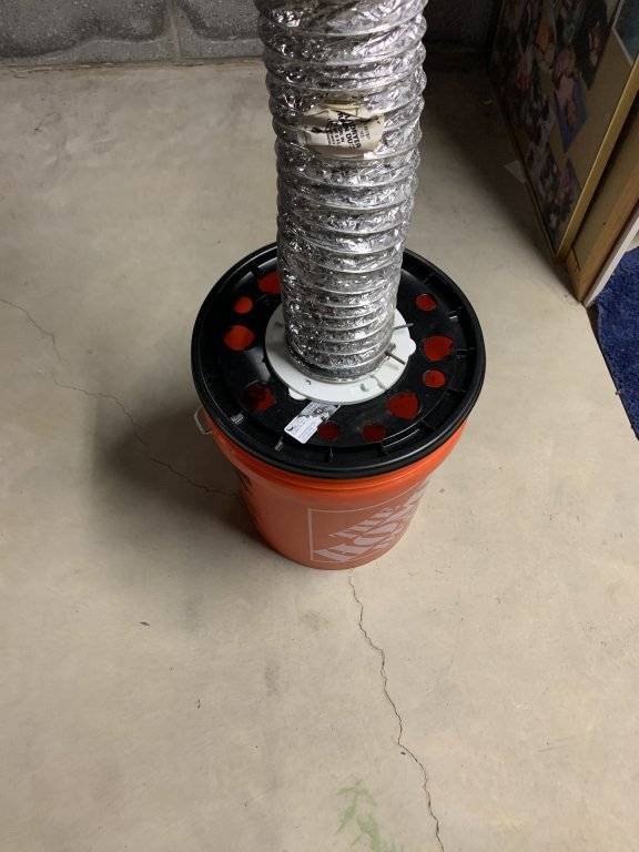

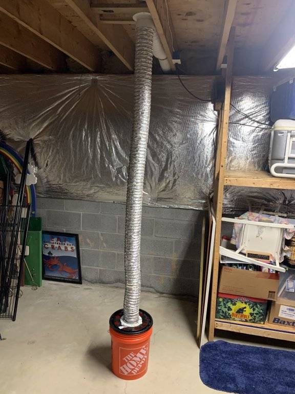

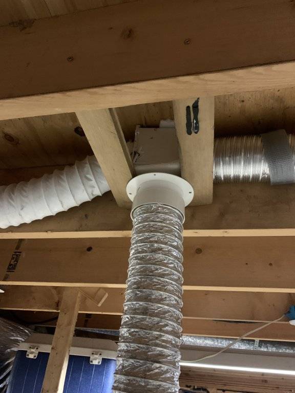

Put together a better dryer vent diverter to keep the warm moist air inside the house instead of wasting it outside. Lots of internet videos about this. I originally got the diverter box that just used the screen but that clogged quickly so took the screen off but that just coated everything with lint. This sends the lint into a bucket of water and the hot air escapes through the holes in the lid. Gotta change the water as it gets dirty and evaporates. The hardest part was adapting the diverter box to the 4" duct. I could have bought expensive T's but was determined to MacGyver it. So far so good.
I did the same years back when I had an electric dryer, works great. Can't do it if you're running gas.

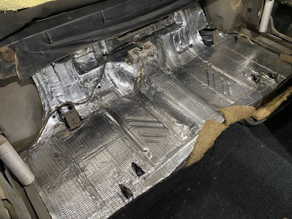

Spent a couple of days in the shop doing metal prep on the trunk, rear floors, and inside of the doors on my 300. Before the weather went for a crap, I got the trunk prepped, new body plugs and spackle painted and installed my new trunk mat. (no pics of trunk as is it full of Christmas presents, my secret hiding spot!) Took out the rear seat, door panels off as they need a bit of touch up and working on some power window stuff. New rollers on the way, hope they fit!
Devin has all my PW switches, and will assemble again when they get back to me. Used the wire wheel on the floor under the rear seat and on the inside of the doors, POR 15 laid down on the floor pan, and Siless sound deadener installed.
Only got the chance to rust proof the inside of the passenger door before the temp dropped too much to paint. Looks white but it is a pale grey color.

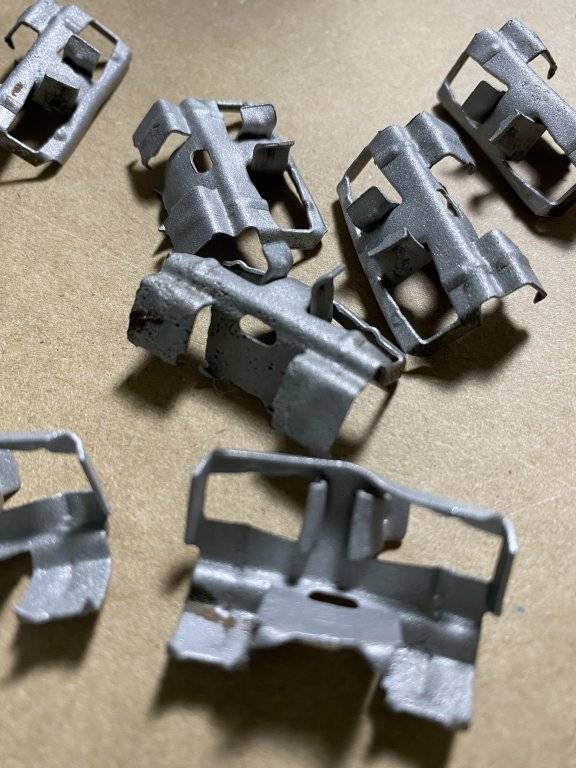

Ordered my new wind lace, and removed the old ones. Also managed to get all 10 of the old alligator style clips that hold the wind lace out in one piece, and media blasted them. Will paint them with rust paint when it warms up and attempt to reuse them when the wind lace gets here. I cannot imagine that anyone out there re-pops them! Next winter blast of weather coming this afternoon, we had 13 inches of snow on Monday - Tuesday, supposed to get another 6 inches tonight.

Nice.:thumbsup:
The doors line up perfectly with the grill too.

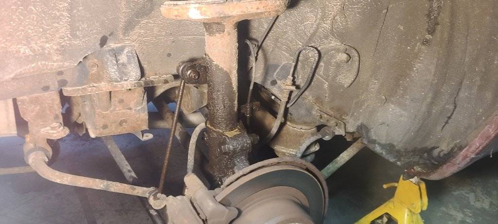

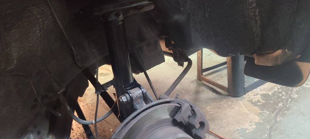

Xenon and I changed the rear struts out on his daily driver this morning.

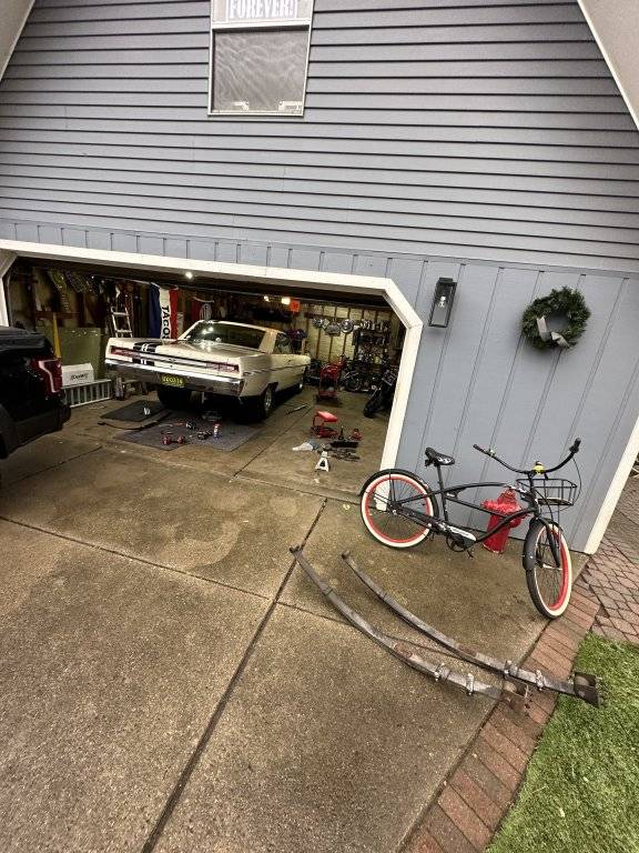

Took advantage of the nice weather and installed split mono springs, new hangers, shackles and Caltracs. it’s too wet and salty to test them though.

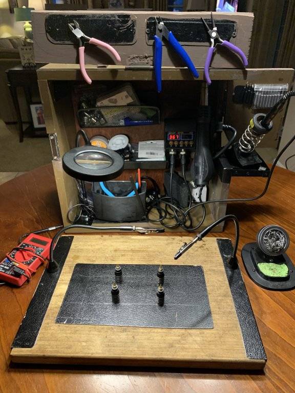

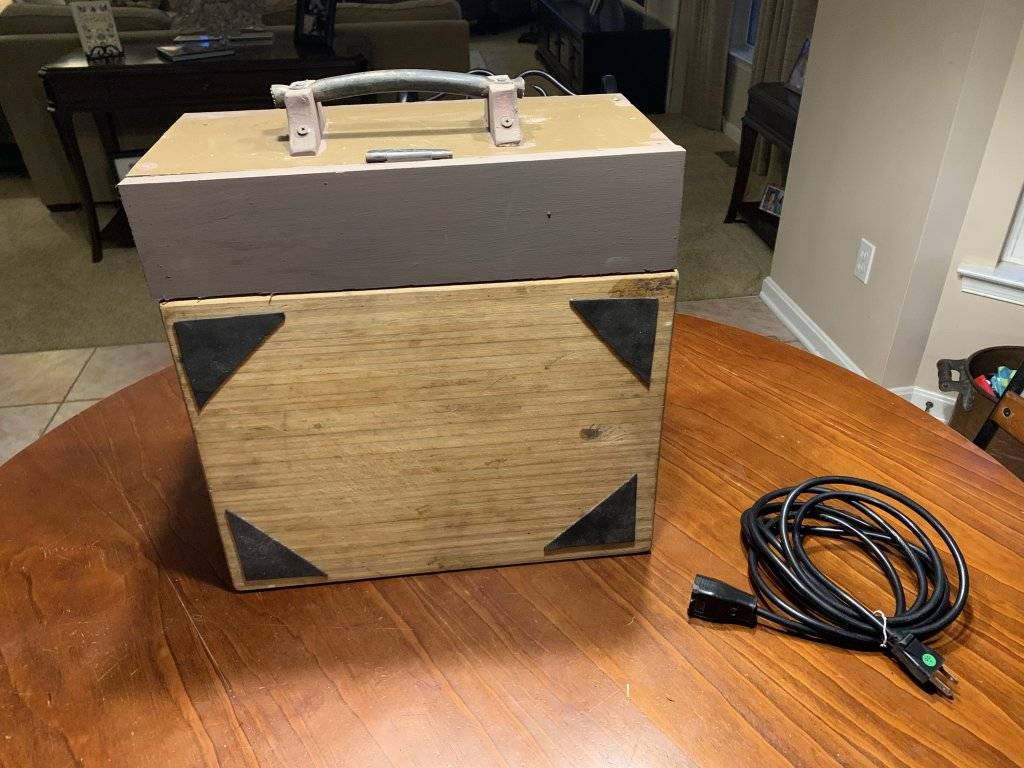

Finished my ugly solder station. Tried to use only existing materials (in my garage) as much as possible. Handle made from fuel line. So far I fixed 4 drill batteries and killed one old bluetooth speaker. woops.

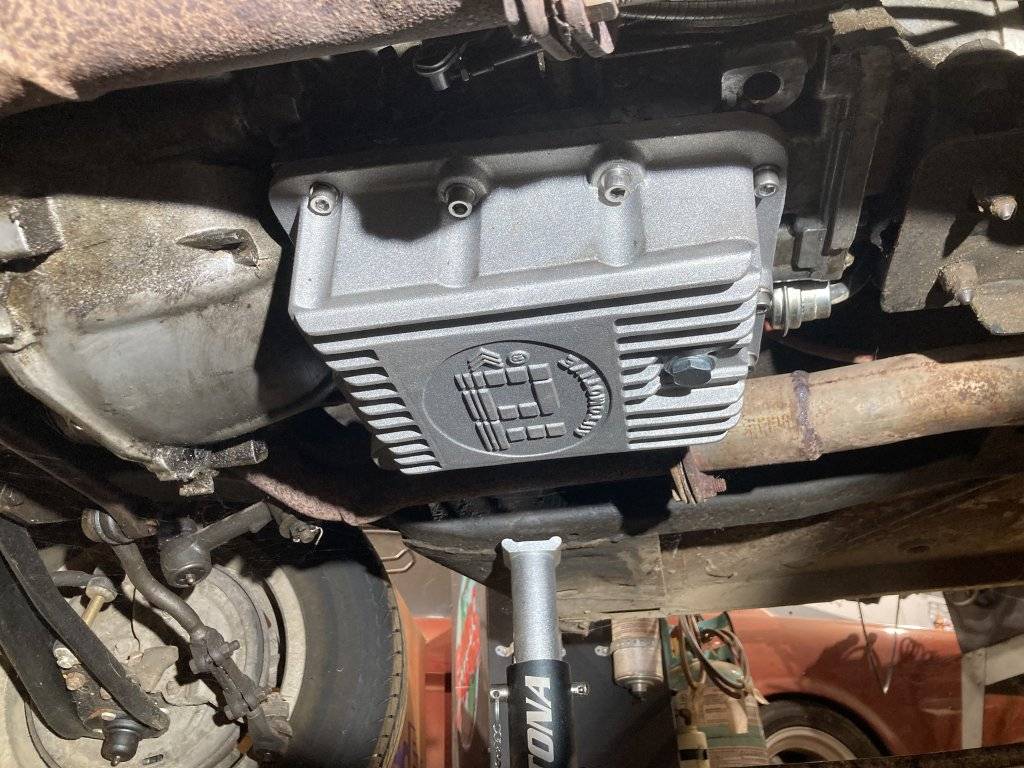

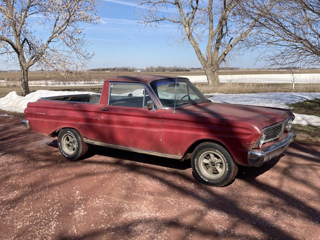

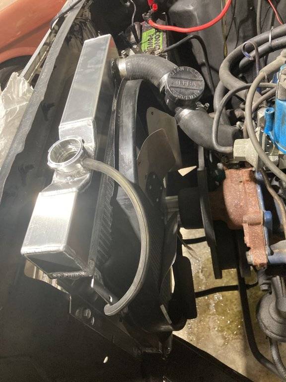

Over the past couple of weeks, I have been working on my 1965 Ford Ranchero - Ringo.
It had a giant transmission leak (C-4 automatic), ran hot, no parking brake and the tires were shot.
I replaced the transmission shifter/kickdown seals, put in a TCI aluminum transmission pan, Lokar kickdown cable (stock equipment was gone!), installed a complete parking brake system (stock equipment was completely removed!), new rear brake shoes (originally wrong and installed backwards!), installed a thermostat, aluminum radiator, Tefba cooling filter, a new set of BF Goodrich T/A radials, a set of KYB Excel-G shock absorbers, and have started adjusting the shift points by adjusting the vacuum modulator.
I have to replace the headlight switch and get the dome light installed and operational, adjust the parking brake and brakes, but the car is running well with a lot less fluid on the ground.
Love the wheels.
Love the wheels.
They are American Racing Torque Thrust 14x6 up front and Enkei 14x7 in the rear.
Once I get the vehicle more roadworthy, I may replace the rear wheels with Torque Thrusts.
However, I have a heater box to rebuild and several other things, before replacing the rear quarter panels and getting it painted. Lol
