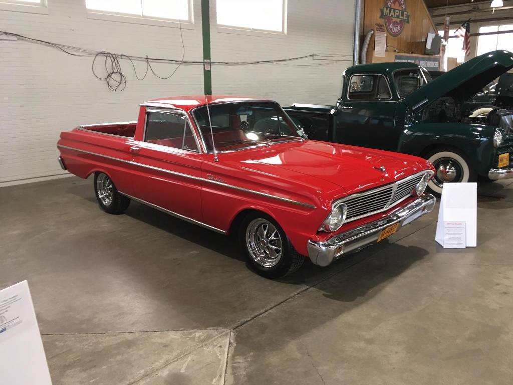

I have always wanted a 2nd generation Ranchero... especially a '64 or '65.
This one shows up at some local shows.

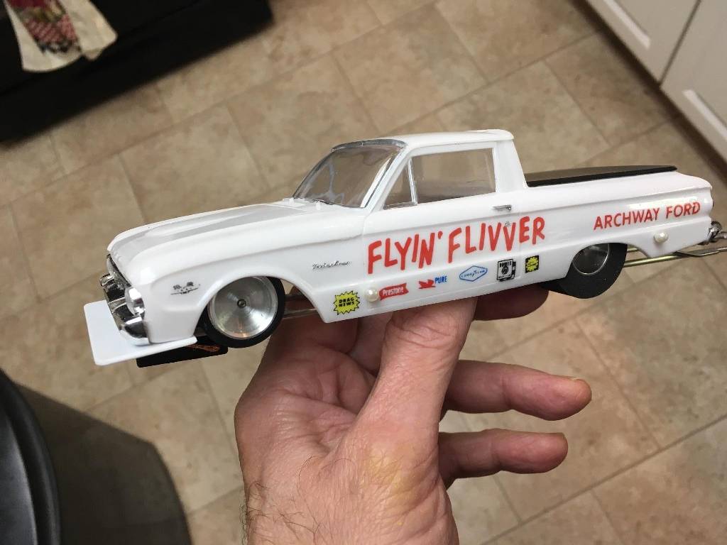

I built this slot car (drag) for a friend.

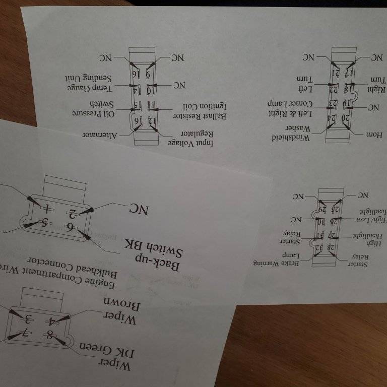

Finished CAD drawings of the underhood wire loom connectors. Deciding on making up new ones or sending out. Either way should help troubleshooting.

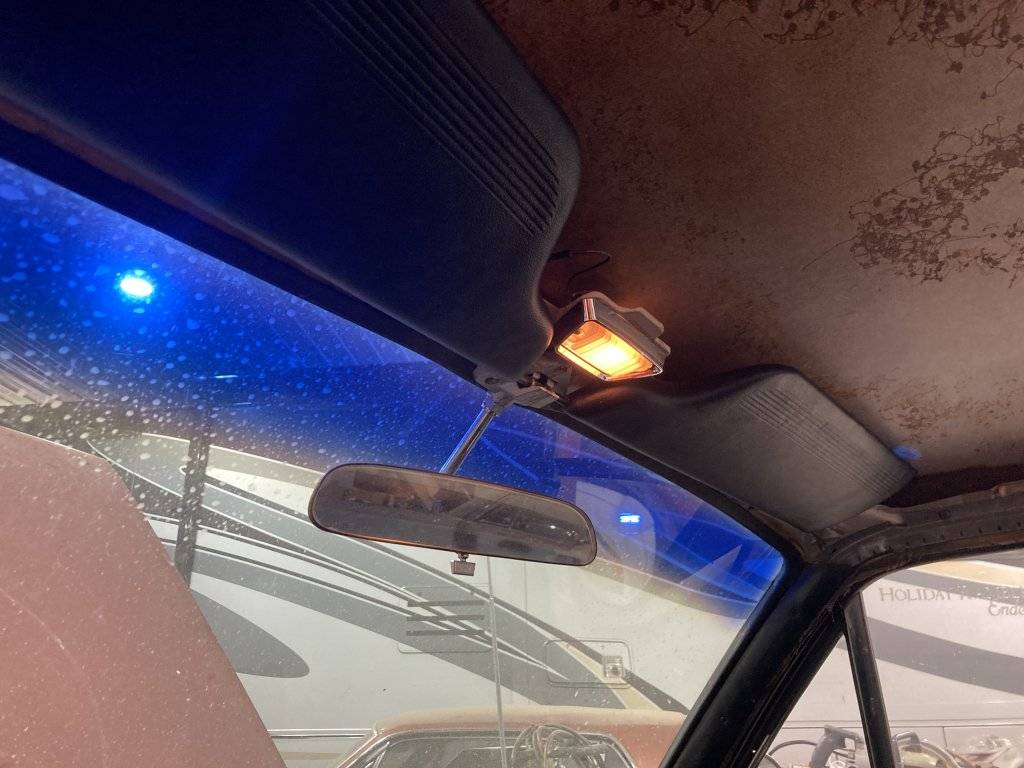

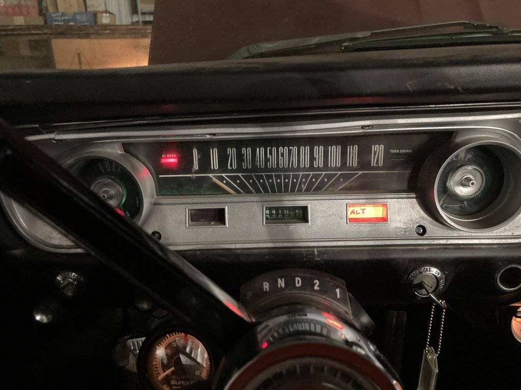

Got the dash lights and dome light working. I had to replace a wire from the fuse panel to the splice for the dome light power and reconnect the instrument panel lights and add a socket. Previous owner stole that wire for the under dash gauge backlighting.

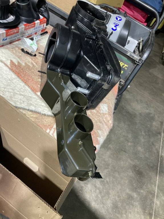

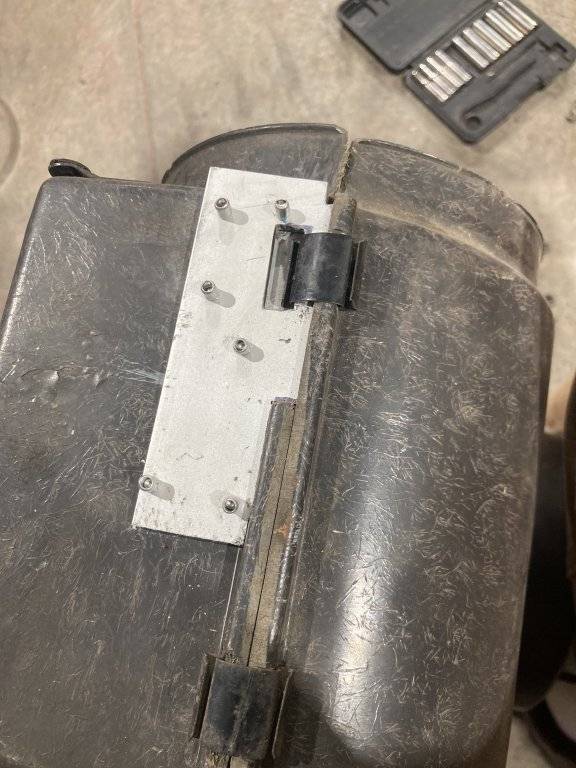

Pulled the heater box out and am rebuilding it. New heater core and seals. I have had to make a few repairs to the case, which appears to be made of a fiber infused phenolic.
I should have it back together early next week as I am waiting on some spray adhesive and a couple of spring steel clips. I’m soaking all of the metal components inside the heater box in an ultrasonic cleaner with cleaning vinegar. I will paint them and bake the parts in a shop dedicated toaster oven.

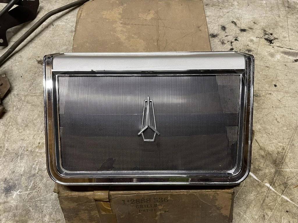

Scored this NOS speaker grill for the 70. Not sure if I can remove the Plymouth emblem and replace it with the 300 letters. Might not be worth the trouble, might just have to leave it for now.
Better than none. Use it until you can find one appropriate for the 300. OR, hang a 3 0 0 on that. True, it still has the Plymouth logo, but.... who besides We Moparians would know? I could lift that logo off, but don't recommend you do so.

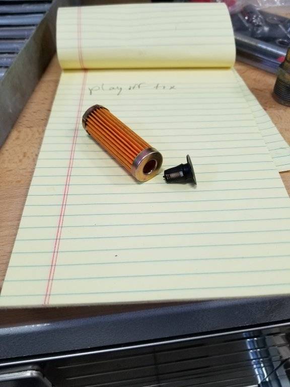

Beware of these restrictors in the new fuel filters! Take it out before installing the filter! Smash it in a vice like I did after losing WO acceleration in the car, then f'n around trying to find out why.

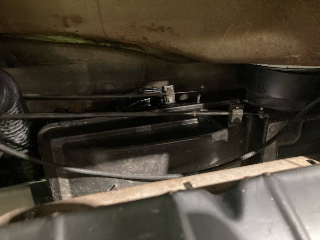

Finished up with the heater box reseal, installed it. I have a new glovebox and dash bezel to install, but have shifted gears to get Bruno, our 2010 Holiday Rambler Endeavor ready for a road trip. Changed the oil and instead of wrestling with filling the engine with a funnel and contorting myself, I made it a little easier by making a fill tube extension out of 3/4” schedule 40 PVC pipe and a couple of 45 degree elbows.

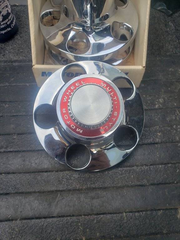

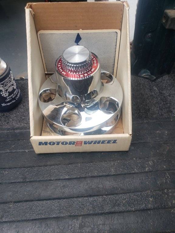

So found these at the spring fling, they looked close. Tried them on a wheel and you might be able to make them work. Were they designed for a particular wheel or just kind of a universal thing? Thanks
