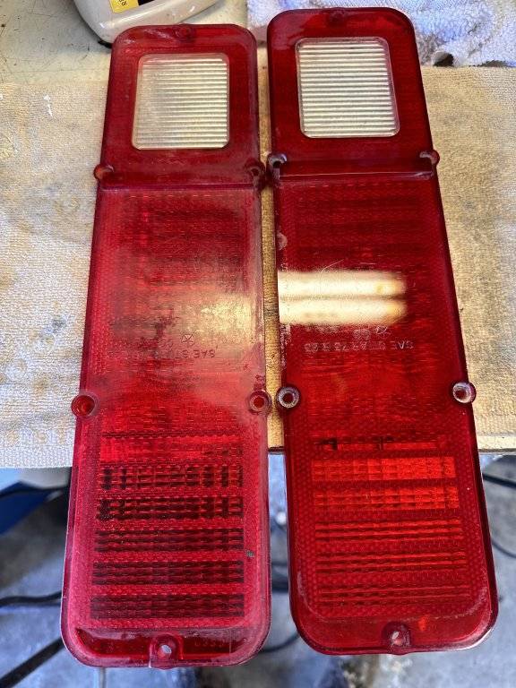

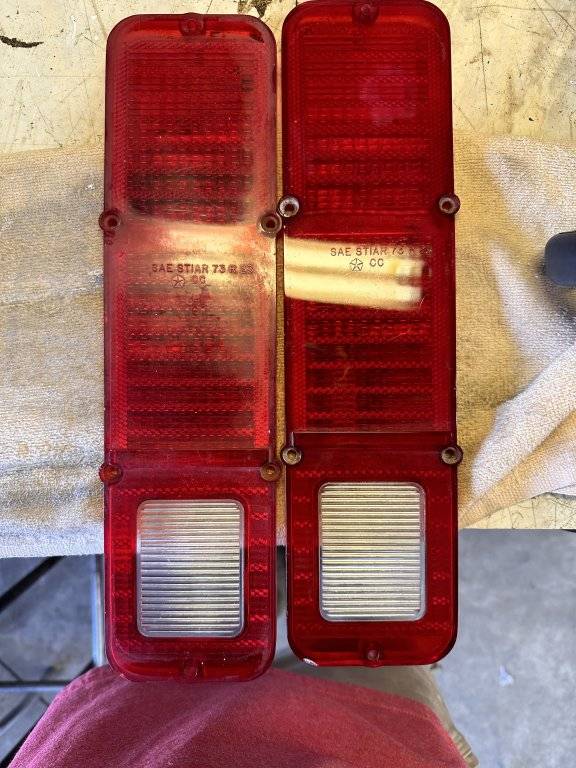

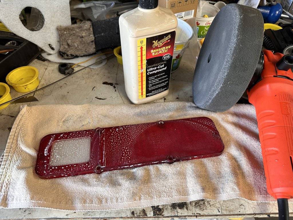

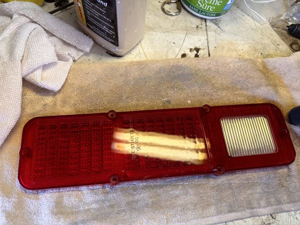

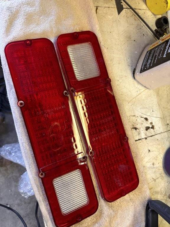

I polished some lenses for a clients car last night. Started with some deep cut polish, then finished with some 3M light machine polish. Another job the customer won't notice.

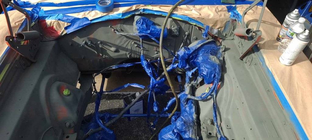

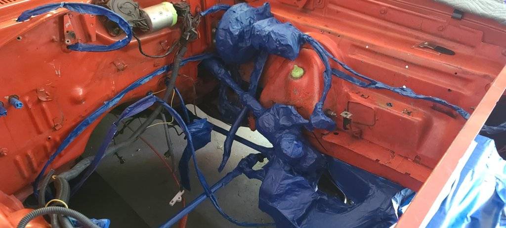

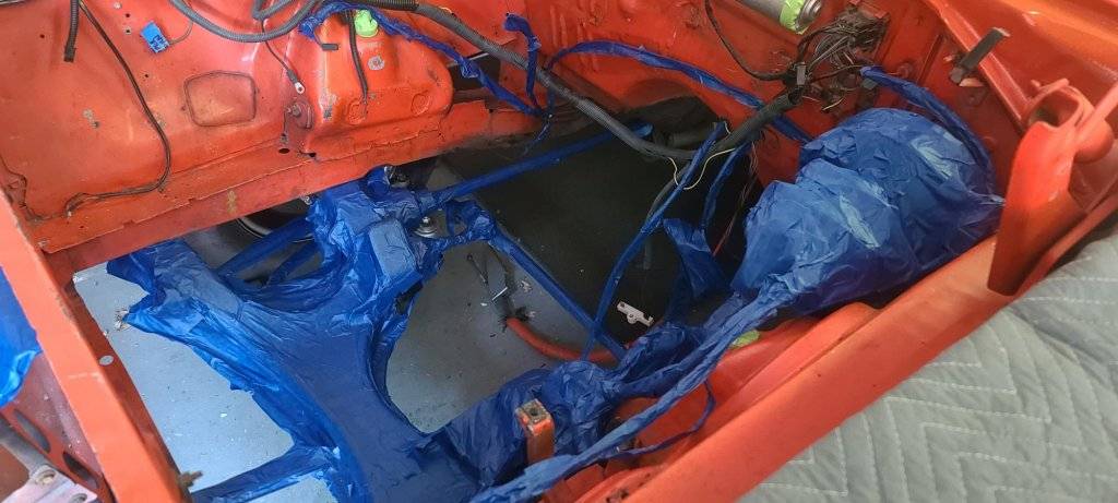

A little change of pace from the C body. Prepping the engine bay on the 70 R/T, getting ready to drop in the freshly built 440.
Lots & lots of taping...
After everything was masked off, the etching primer was applied and afterwards scuffed up with a scotch brite pad.

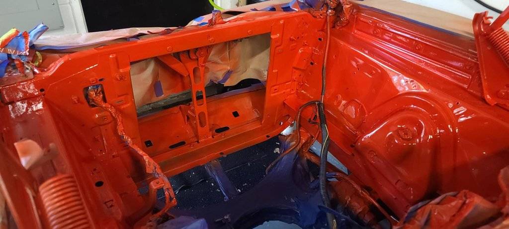

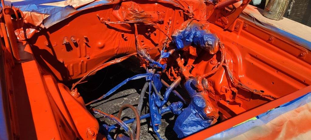

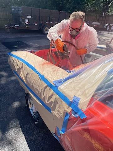

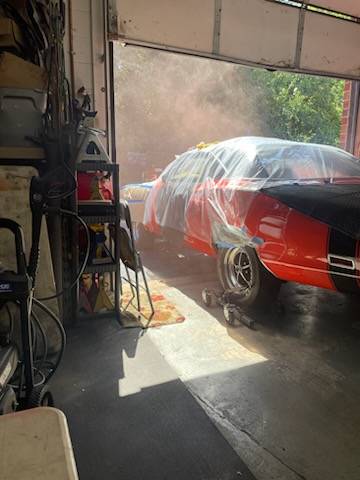

Then ti was time to spray the hemi orange paint....
Not to worry, all the C bodies and the Scat Pack were parked way up-wind from that cloud.

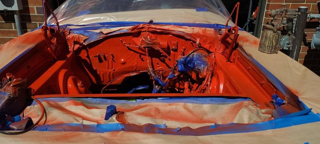

With the help from @Xenon mixing the colors (remember I'm colorblind) and pointing out the areas I needed to go over a second time, I think paint in the engine bay turned out super nice.
After the paint was applied, I went over everything again with the clear to give it that shiny, fresh paint look.
I left the wire looms on as much as I could to protect the wires from the paint, since new looms will go back on when the engine gets installed.
