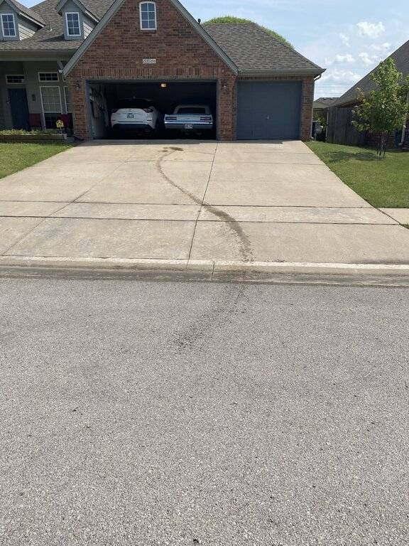

Well, after a mishap last weekend I finally got the high pressure hose for the power steering. It took less time to change the hose than to clean the driveway!

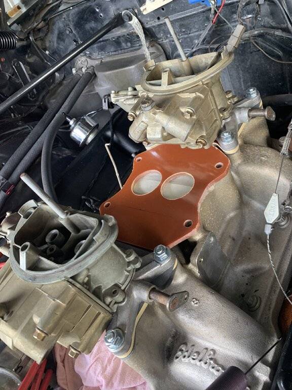

I added 1/4" phenolic spacers to my 3 carbs yesterday hoping to improve my fuel percolation/boiling issues after shut down. I definitely think my issues are made worse because of the big air cleaner. The center one I fab'd up to cover the center and rear bowls as well. Front carb bowl is not directly over anything so I left it as is. Center carb is the most important one. I would have gone to 1/2" but not enough hood clearance. I have some more work to do before I take it out to test.
Wow, that's cool! Did you make those yourself, or is that an off-the-shelf product you bought? If you did that, what kind of material is it?
If for some reason it still after-boils, maybe cover the bottom of the phenolic spacer with foil tape like what's used in ventilation ducts. Just a thought. Wouldn't add but a hundredth of an inch to it and might be enough to deflect the heat that your fuel won't boil out & evaporate on shut down.
Not as many choices with 2 barrels and it was all I could do to resist the $8 heat shield gasket but in the end I got a 3 2barrel kit with longer studs and gaskets. But since I like the idea of shielding the bowls I got a sheet of phenolic resin to make my version of the most important center carb. I didn't like the brown look of my bigger spacer so gave it a spray of cast aluminum. Looks good now. Not really noticeable. I had to make another 1/4 spacer for the choke coil. That was wood and metal sandwiched to get the 1/4". I have put a layer of reflective heat shield on the underside of the big air cleaner. But I still have some tuning to do. I figured the phenolic spacers I would do anyway so jumped on that while I was under the hood.

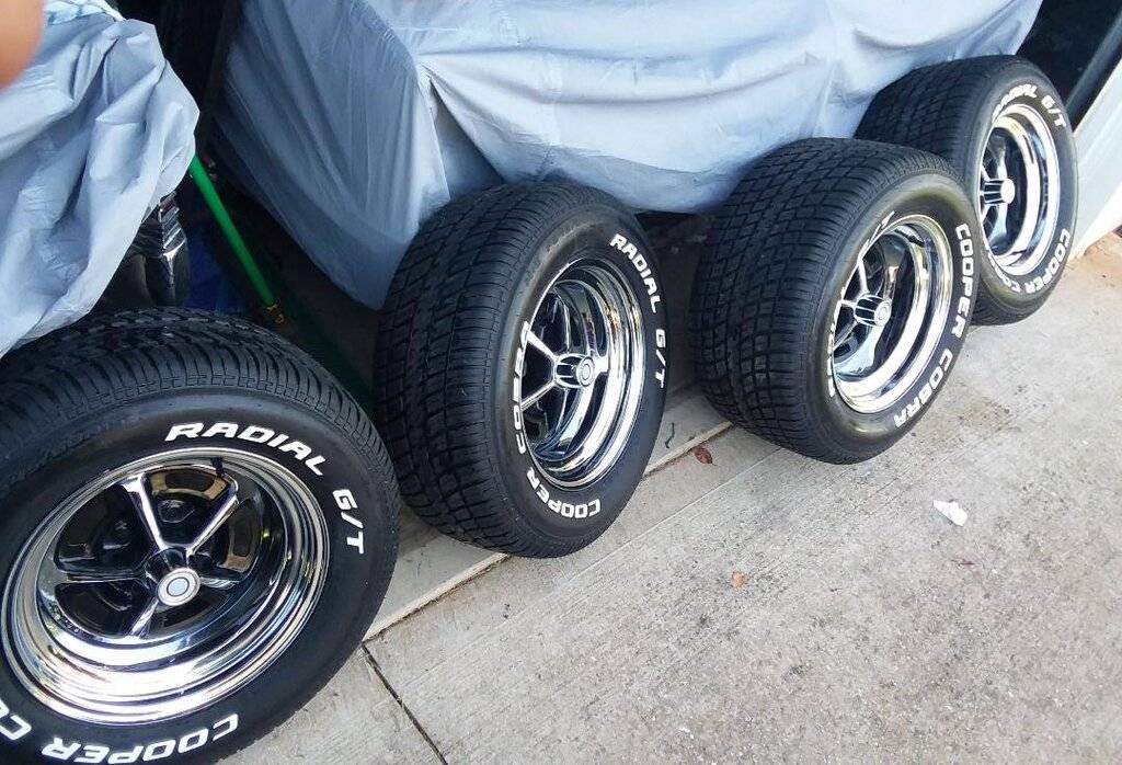

New shoes .. 245/60-15x8. 4.5 bksp, in front, 295/50 -15x10. 5.5 bksp, out back.
Rear leafs moved inbound about an inch to accommodate a 12 inch wide rear tires (otherwise you cant get this setup out back in a slabbie without some skillful modification to avoid interference)

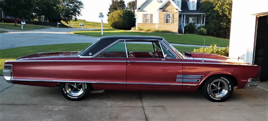

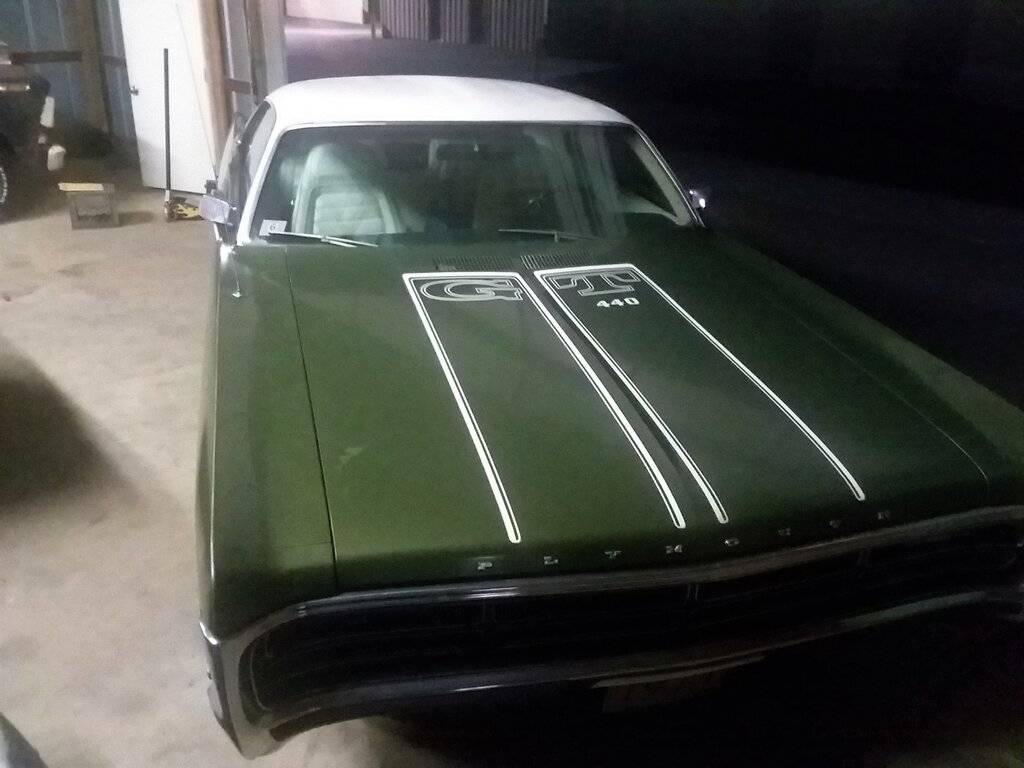

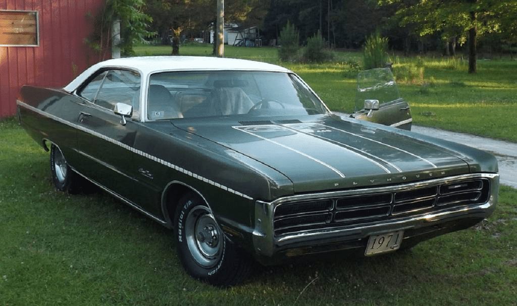

1971 Plymouth Sport Fury Gt
It went out to get its vinyl top replaced last week.

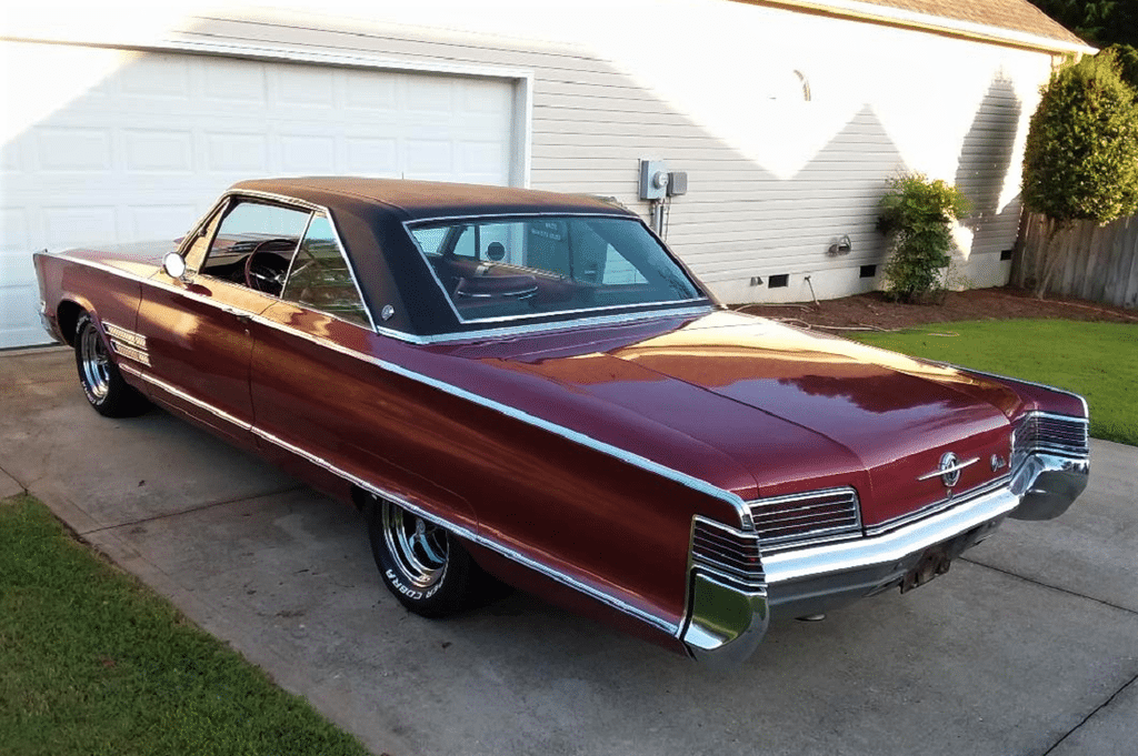

I will add it to my forum "garage" here when I am finished touching up a few things. All tributes to the builder -- @Wollfen (hope all is well brother)

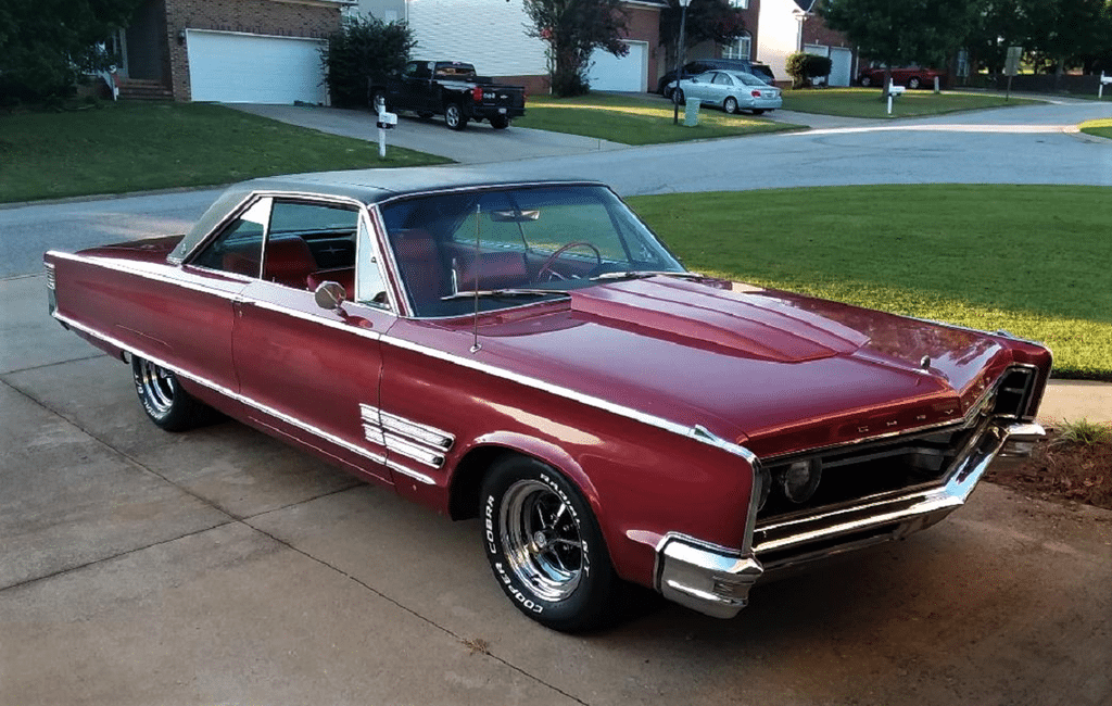

Almost ready to put her back together!
Just one more weekend working with my dad and should be back on the road. Neither of us ever really worked on cars before this one but she's real easy to work on. Good times.

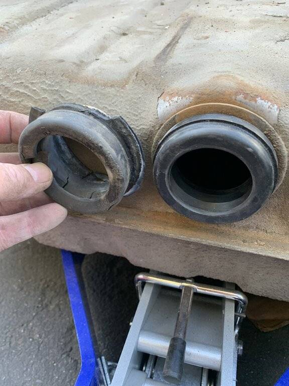

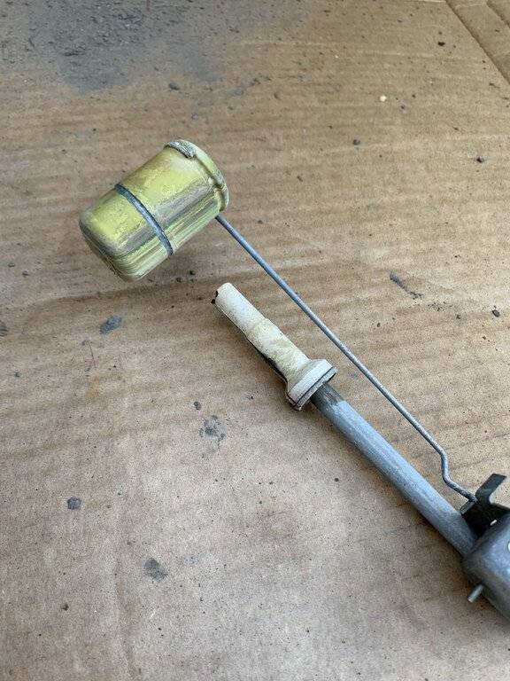

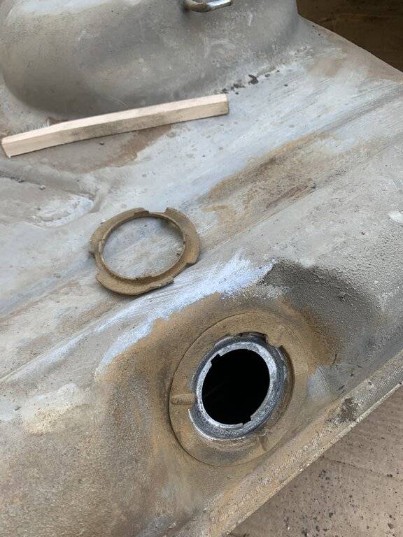

Ok for all you Formal Driveway Warriors. My 77’s fuel gauge only read 1/2 when full. Decided to yank the tank and replace the sending unit. As you’ll see! It needed to be done even if the gauge was reading as it should. The filter was gone / desolved. No sign of it in the tank. Tanks is remarkably clean for having never been removed.
Outside of the tank was in “As expected” condition.. NO Broadcast sheet as I had hoped since there wasn’t one IN the car when I pulled the seats, carpet early. Oh well! Maybe under headliner when I have that done. Also replaced the filler neck grommet. As you can see it needed it.
Couple more pics.. the filler neck needed to be cleaned, Took a piece of scotch bright and just cleaned off the crud, ready to reinstall.
and a few under shots in case you guys wondered what your Formal looks like without a tank in it.

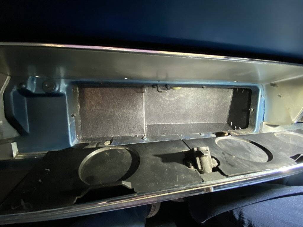

Got a repop glove box liner for my ‘68 300. The old one had a gaping hole in the bottom.
out with the old:
In with the new:
