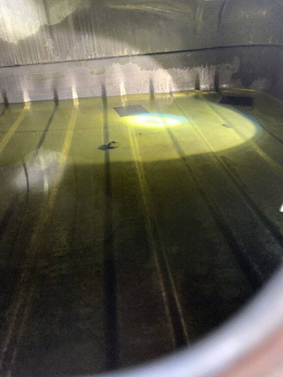

Pretty sure the inside shot of your tank shows the remains of the sock/filter. Those two squares are it, it must've split at the seam and unraveled. It's held at both ends by a plastic piece, one of which appears broken off the old sending unit and is also still in the tank. Mine was the same.

I thought the same so I’m gonna poke at them and see if that move, if so I’ll dig them out.. I got both grommet and sending unit from eBay.. the seller is a Mopar guy and has lots of Stuff. I’ll put the tank back in today and report back once done.

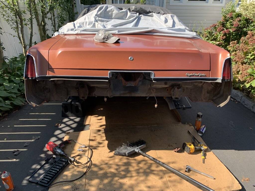

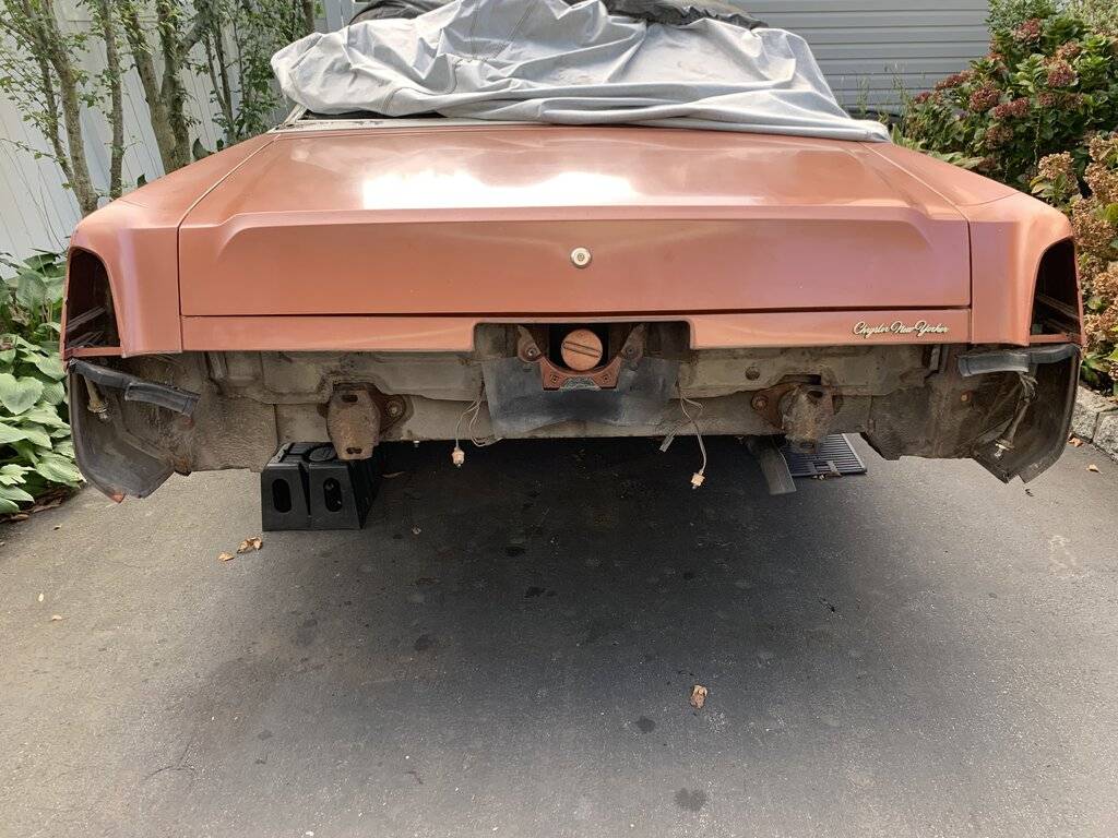

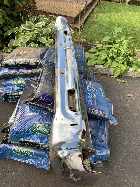

Well the tank is back in, and the new sending unit is exactly was needed. Although I haven’t filled the tank up, I did exercise the sending unit and my gas needle went to full as it should. But of course! One small job turns in the something much bigger. While I had the back of the car up, I decided to pull the bumper and everything associated with it. And give it a fresh up, I’m disassembling the bumper completely and having all the raw bumper supports and brackets and bracing sent out for blasting a powder coating. I already have a recurring true bumper which I will reinstall if everything goes back, I’m also sending out all the shiny bits to get polished or chromed.. it never ends with these Ol girls.

I always thought there were baffles in the fuel tank to keep it from shlawshing (is that a word) around.

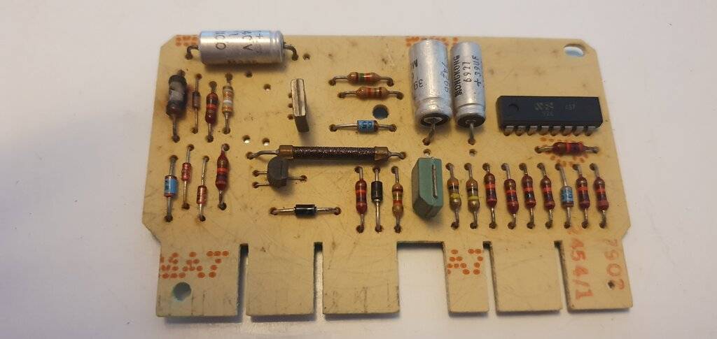

Finally finished up work on the 727. Had two small leaks that needed some attention, one was the dipstick seal and the other was the NSS, but both are dry now. Managed to tighten up my shift linkage with a couple washers and some grommets. Haven't been able to test the new valve body with PTK yet though. Something decided this was the time to break resulting in a no crank issue. Traced it back to something with the seatbelt interlock since both relais and nss are good, but I ran out of time. Will work it out coming weekend. Gotta love electrical.
Found my electrical gremlin! Turns out I have the green seatbelt warning box, p/n 3501500, so no actual interlock only warning light. BUT there was a single burnt out resistor preventing current to the starter relais, upper left in the picture.

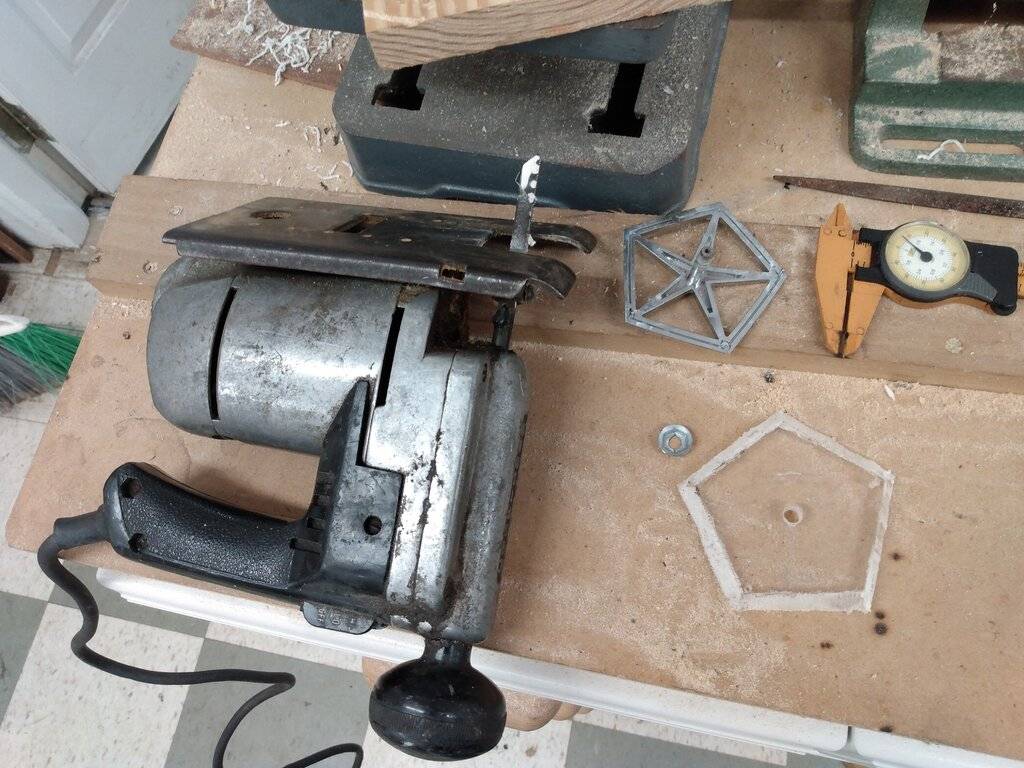

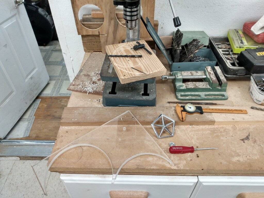

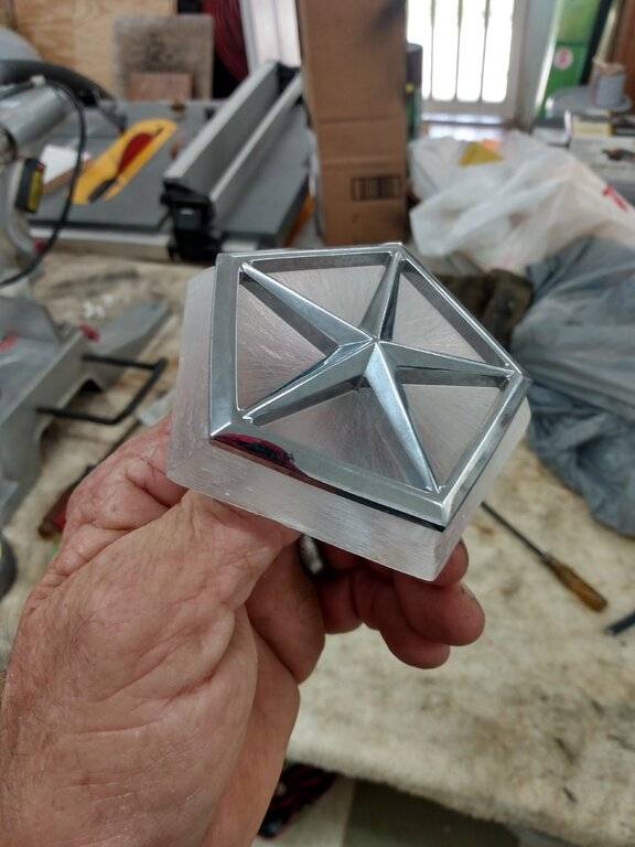

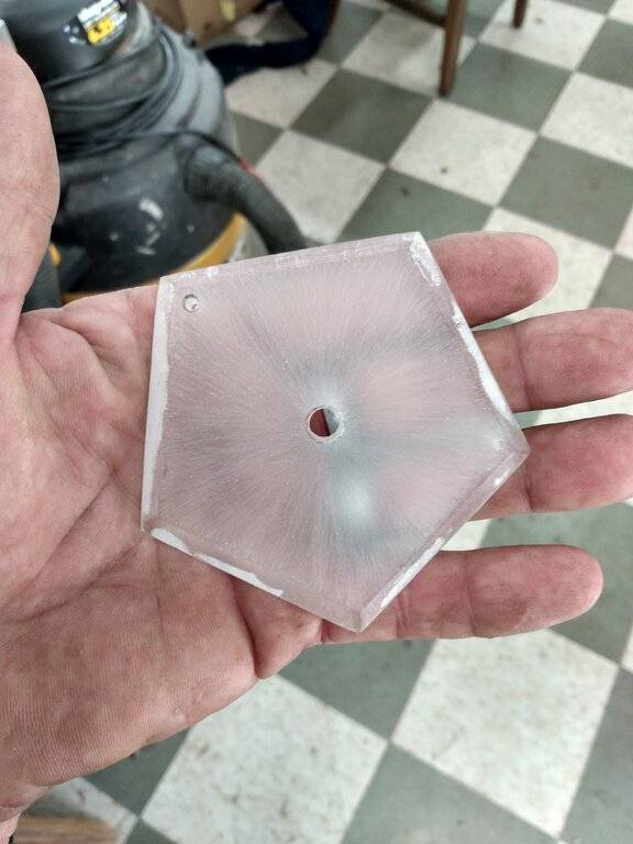

I have seen illuminated Chevy bowtie emblems and lit up Ford blue ovals before, even Toyota emblems adorned with LEDs. But not Chrysler pentastars. No glowing glory for Mopar exist in the commercial aftermarket realm. So I decided to make my own.

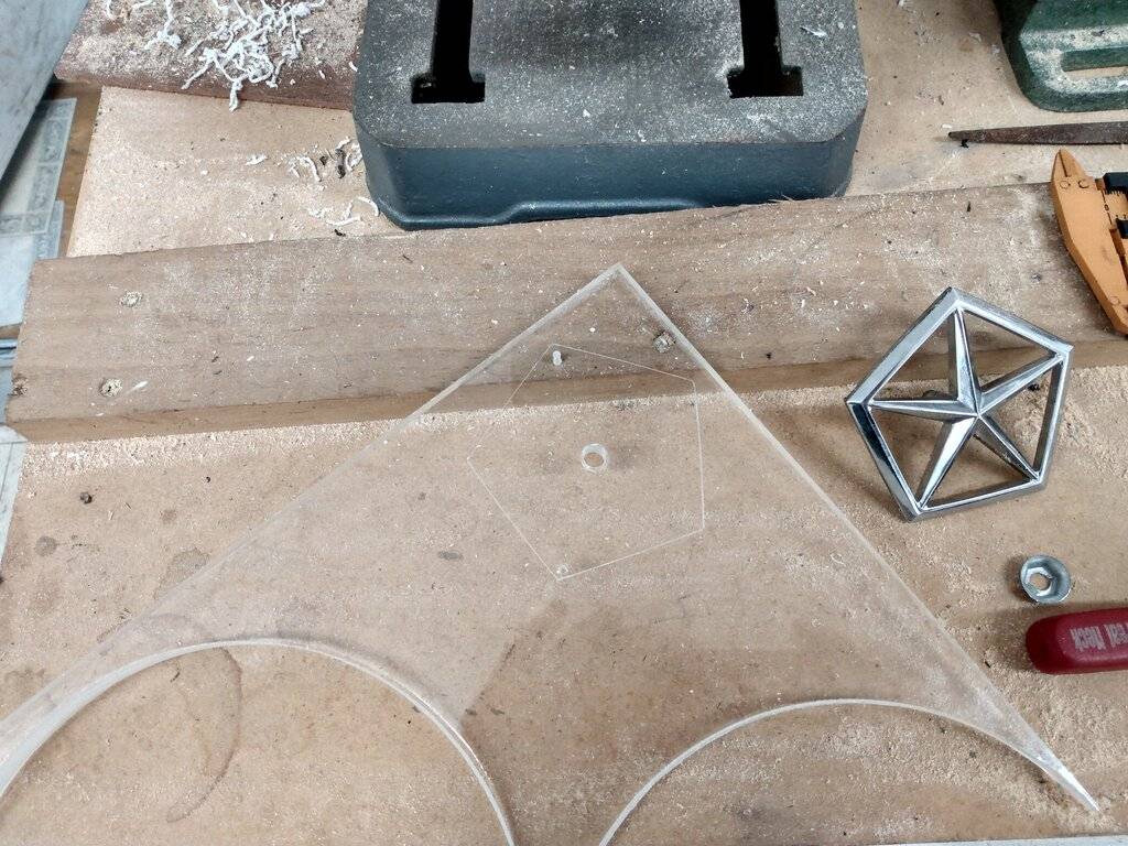

Using the acrylic scraps from my light up speaker rings I made, some spare orange LEDs, sandpaper, power tools and a dash of ingenuity, I present to you my latest custom adornment for my mighty Mopar.
Drill a few holes to locate and center the emblem, scribe out the outline to cut.
cut along the outline at 45° angle with a jigsaw.
So far so good.

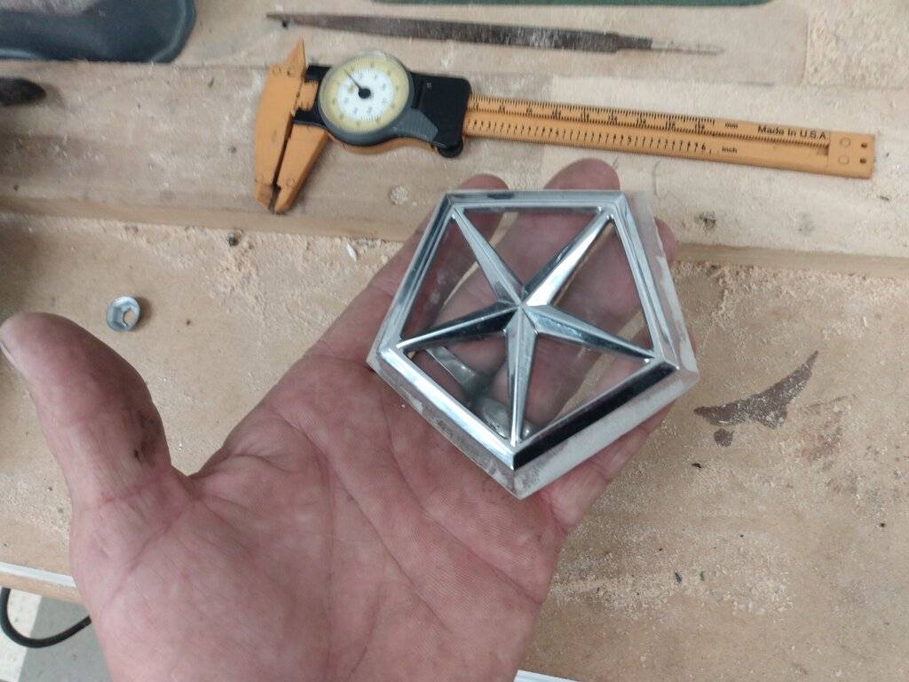

Hand sand from the center outwards for that "starburst" appearance. Helps to diffuse the light.
Hand sand the edges to get rid of that raw rough cut left by the jigsaw.
(No, that's not blood, that's a reflection of my hat in the chrome.)

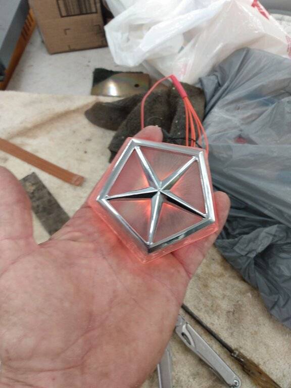

Add lights, test with a 9 volt battery
I think it looks cool. And as far as I know, I have the only one! If I remember to, I'll snap a pic of it tonight when it gets dark and post it here.
