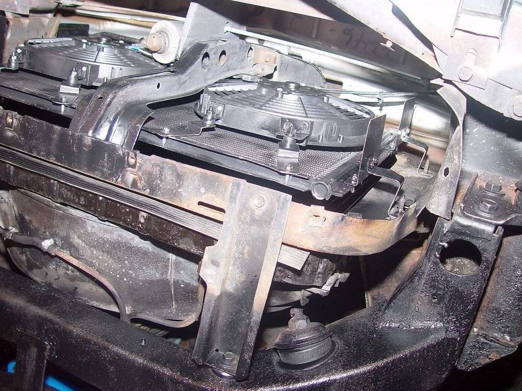

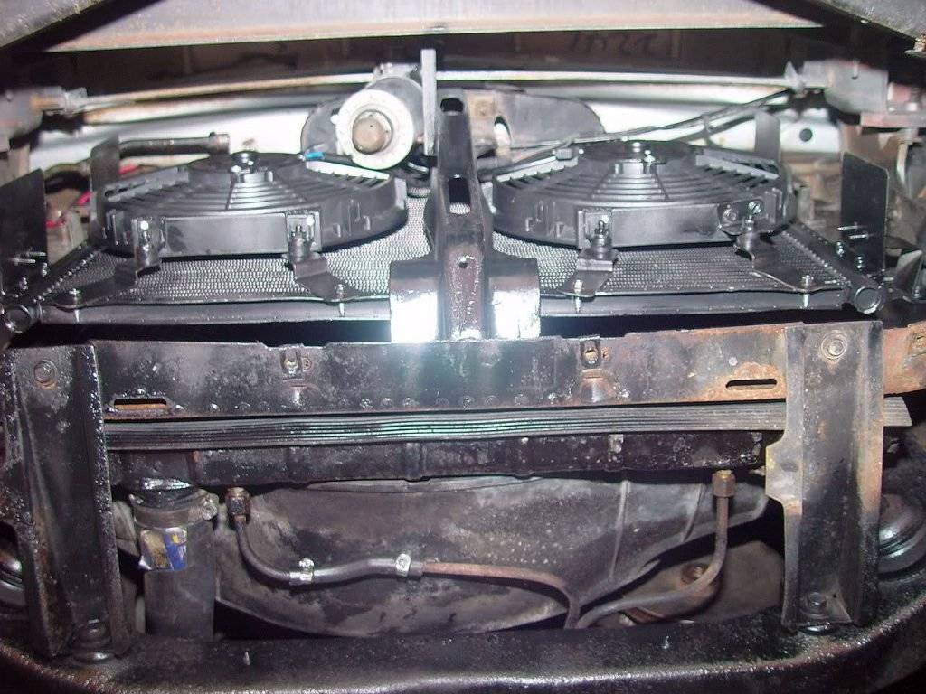

When it comes to replacing the condenser, the only ones I see available do not have the notch on the bottom passenger side to clear the bumper bracket & both high & low lines attach on the same side. How are you guys adapting to this? I've gone through two RV-2 units in the last few years, they were 4 Season remans which I think are just repainted used compressors, so I was thinking of going with the Sanden retrofit.
I didn't replace my condenser when I went to the Sanden style compressor. It cools very well for as hot as it gets on the gulf coast in the summer. The pressures are right in line with the info gotten from Classis Auto Air. I'll see if I can find the paperwork and post it.
Make new hoses.

I removed the original clutch fan and replaced it with a 7 blade fixed fan 1/2" from the radiator. Have never had an overheating issue.
