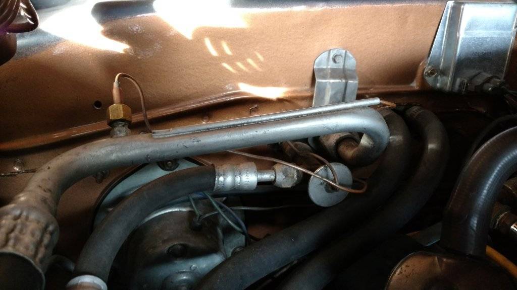

@ John Live4theking follow Big John's pictures if you are going to eliminate all the factory hard lines because the 844 valve will not go on new/made lines if you were going to use you original hard pipes at the firewall use the original type valve.
here is mine, the suction hose far left is new on old hard pipe, high pressure hose going to valve is original.
I should have noted that all the underhood A/C stuff was MIA on my car. If the factory hard lines had been there, I probably would have tried to use them.
