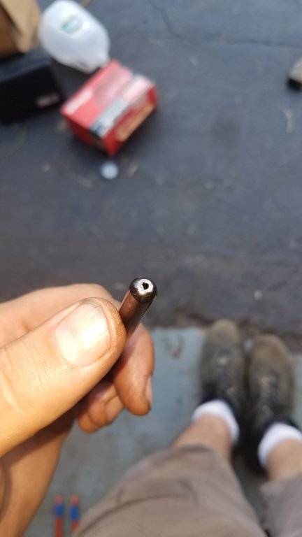

Hmm that's interesting ... they had a hole in them
That's... ummm... Interesting.
To me, that sends up a huge red flag about the shop. Wrong pushrod, so what else did they do wrong. It also doesn't look like a uniform hole, so that would make me look at what else is messed up.
There's a lot of things that can go wrong with cam break in. Did the engine start right away?
Nope , the shop did the disassembly & handed me back all the stock parts when I picked up the completed engine.
Did they replace any push-rods? Do you have the old ones? Also pre Magnum engines DID NOT have holes in the top of the lifter. Do you have your old ones?

I did contact them ( after I cooled down a bit). Originally I thought it was just #3 exhaust. The one that came out of the rocker the lifter was like a plunger (able to push down very easily)... He called me almost immediately (even though hes on vacation) they said they would get me a replacement lifter and pushrod .. Then I pulled the intake to see more of the damage & contacted him again he gets back to work tommorrow I'll see what he says...
