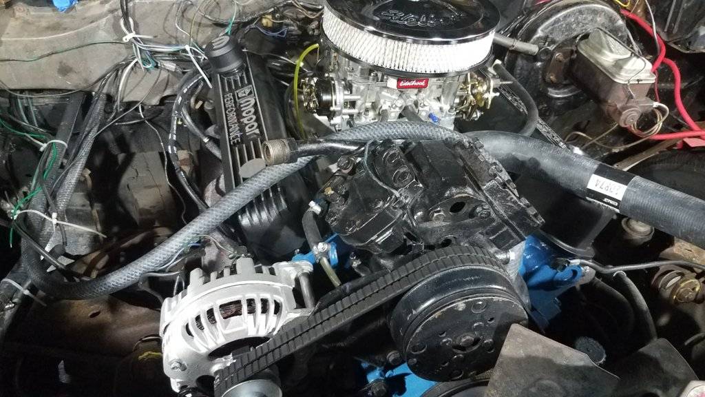

For anyone wondering. I picked up the engine complete on Friday morning and broke it in Saturday morning. The shop I used SK speed in Lindenhurst was extremely helpful and I couldn't be happier with their support this far. I was extremely concerned when that 1st cam smoked. Out of pocket for them to tear it apart and essentially rebuild it again in 2weeks was about 450 and 375 of that was upgrades... Break in went smooth and it sounds healthy.
