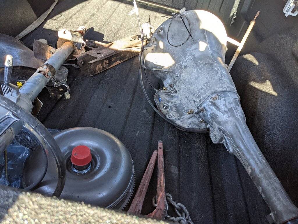

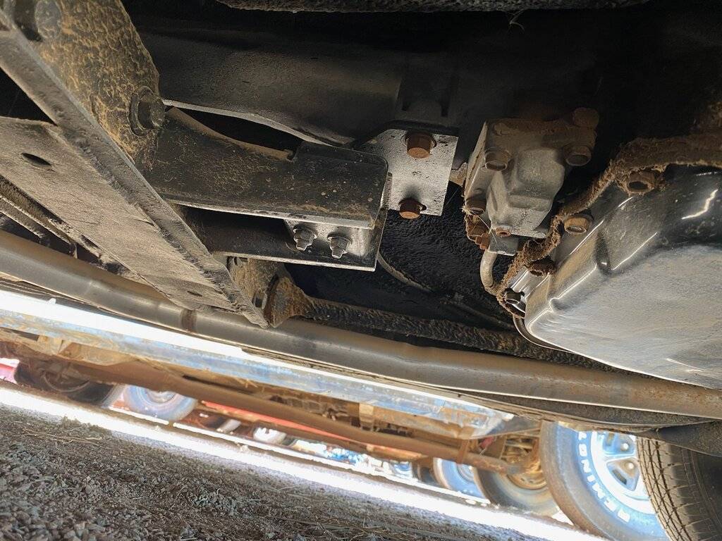

I picked up this 65 Fury that came with a freshly rebuilt transmission. I thought it was the original one that came out of it. However the mount and crossmember aren't even close to lining up. Also the new mount I bought from RA doesn't match the holes in the transmission case. Here's a picture. Anybody know what this transmission might be out of? I pretty sure the crossmember is the original.
The new mount is for a manual transmission. The other mount has the "bracket" built in - it's part of the mount itself. You can likely make an adapter plate if you absolutely have to use the manual trans mount.
I was going to say what is PK #, but looks like you have it sorted out. That mount looks like a earlier style mount (not a later spool/manual mount)
That my friend looks to be a pushbutton tranny possibly from 62-65, since the one I have in my 64 NY looks exactly like that with both the parking brake cable and shifter gear cable with the adjusting wheel. Also has the speedo gear hole in that 1st pic.
