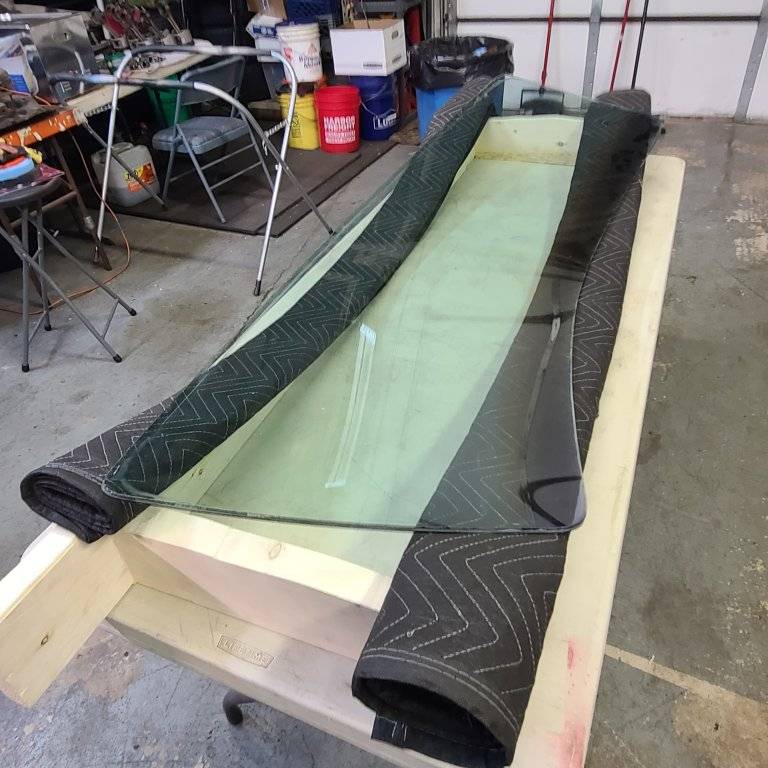

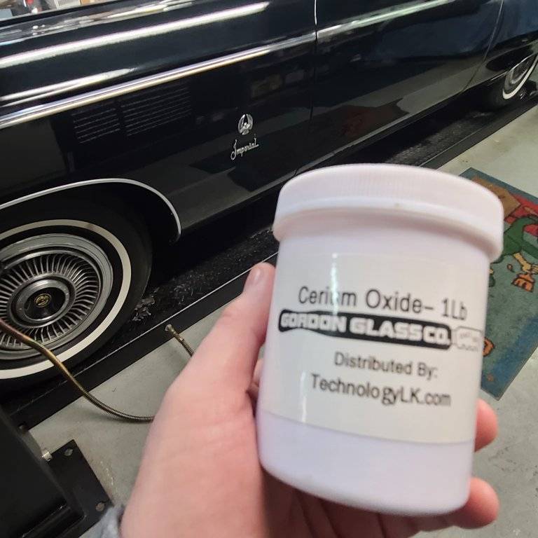

Rather than waiting any longer on the backorder on a new windshield from Classic Auto Glass - Windshield Glass, Back Glass, Door Glass, Vent Window Glass and Quarter Window Glass - Chrysler New Yorker, 1969, 1970, 1971, 1972, 1973, 69, 70, 71, 72, 73 - Catalog Product List Page I found a windshield at local swap meet. It wasn't perfect, since it had a scratch on it that would've been direct view when sitting behind the wheel. But thinking the scratch wasn't too bad, it was worth a try using @david hill suggestion on polishing glass using Cerium Oxide.

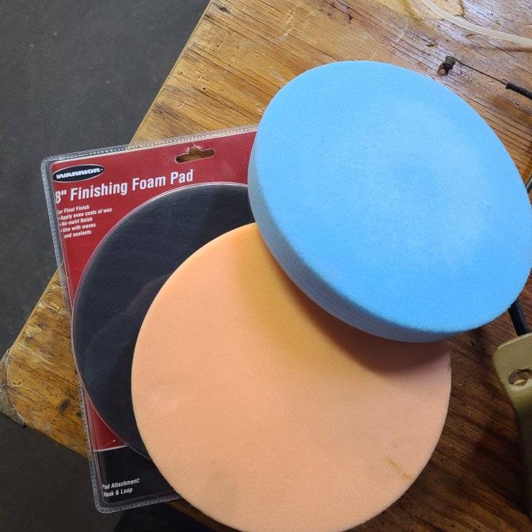

After receiving the product found online and then building a stand for the windshield to hold the windshield in position, a mixture was then made with the Cerium Oxide with water to bring it to a pasty composition. It was applied with a clean damp micro fibre towel, first by rubbing the compound in small sections to the area that needed the attention. Once the paste was applied, the polishing was done using a power orbital buffer, and various foam pads (not coarse) to slowly remove the scratch. Besides rubbing the Cerium Oxide onto the glass, it was also applied to the orbital pad.
This is a slow process as the windshield will heat up very quickly. To prevent cracking the windshield, be sure to have a spray bottle with water nearby and spray the glass periodically while using the buffer. It takes a while for the glass to cool down, so taking a break in between stopping to add another mixture of the paste to the windshield would be in your best interest.
After the scratch was gone, the Cerium Oxide was applied to the rest of the windshield to polish the remaining glass.

I probably asked earlier in the thread, but as you drove it more did you notice if the polishing caused any weird view like you cut a prescription into it?
I brought the windshield over to the body shop where the New Yorker has been a few months back after it was cleaned up. The old one had been taken out and this one had already installed when I saw the car this week.
No drive time to report on yet to give a real assessment, but it was a concern of mine too.
While the windshield was still at my shop, @Xenon was using the buffer while we had it up on a table outside. When we were done, we held it up on the edge of the glass on the table while it was outside and looking through the glass, I didn't see any distortion or waves.
I suspect if a coarser buffing pad had been used, the process to remove the scratch may had been faster, but most likely would have ruined the glass beyond repair.
