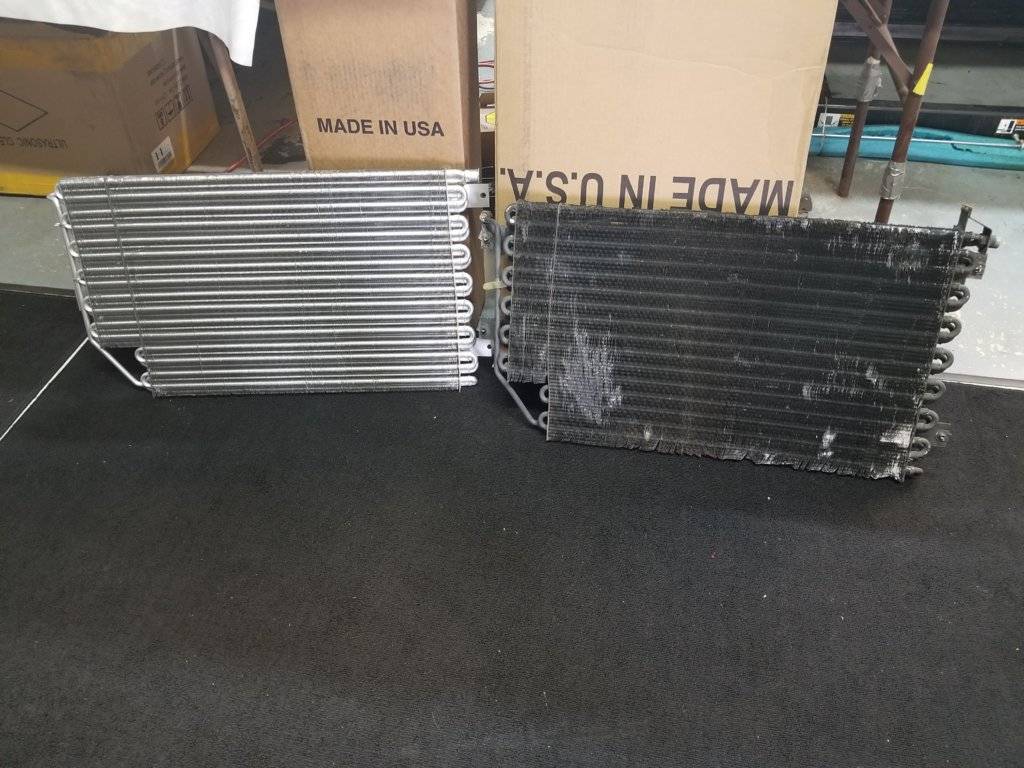

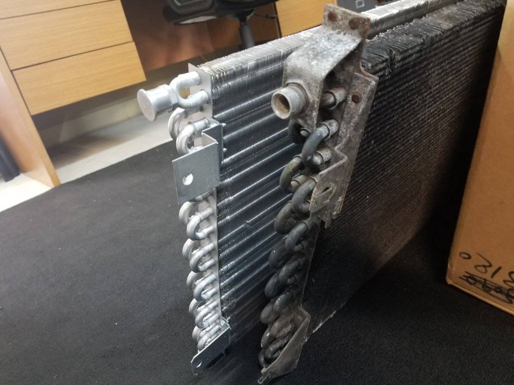

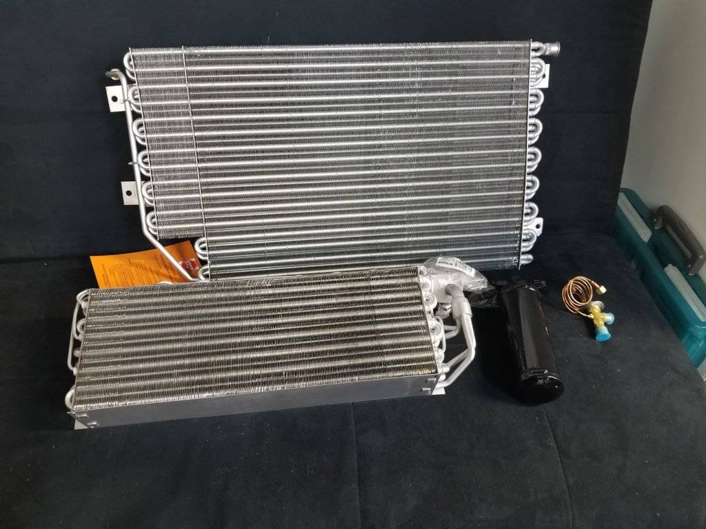

The new AC kit from AC Global arrived today.
The condenser mounting brackets are slightly different than the OEM equipment, but I'm thinking it'll line up fine.

Yes, that extra support bracket for the incoming line was on all C bodies after 1969, but it rarely helps in preventing that port from breaking off when trying to get that conection loose with a rusty condenser. Just be sure to use two wrenches when you tighten the fitting and there should be no problem. It should mount up fine though.
