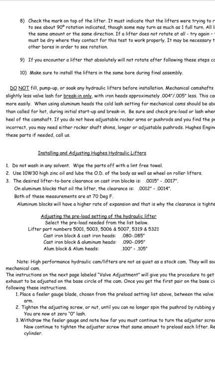

All it says is, "Use 10/30 high zinc oil and lube the OD of the body as well as the wheel on the roller lifter", and that's in the installing and adjusting lifters section! I don't see any **** elsewhere else that say to use zinc?
Yes flat or roller you only want oil on the body and lifter bores. The cam break in grease or moly lube only goes on the love and flat tappet face, not all over the damn place.
Better wording would be to have left the roller example out of this write up.
It is about flat tappets, they turn/rotate.
If a roller lifter rotates it is bad!
ZDDP is zinc
