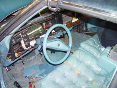

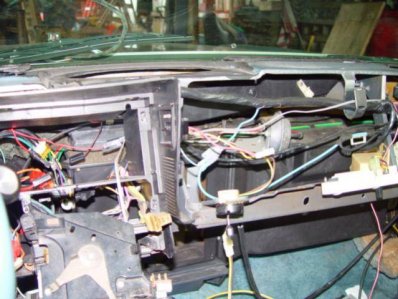

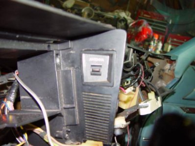

Here's a few pictures of my dash torn apart....
First time was pretty intense. Easy as pie after that. Just labor intensive.
The manual heater A/C box looks like this (picture of A/C box courtesy of Stan) and is on the right side of the 2nd picture. So the conversion is quite a job. Not to mention you'll also have to change all of the wiring and controls also. To me ....a conversion is way more work than I'm willing to deal with. Easier to find a nice manual A/C car to begin with...

#1 PROBLEM WITH ATC II ON FORMALS:
The dashboard. If anything goes, you cant get to it.
I have an ultra rare test box where you plug into a connector at the front of the heater box. You cant even get to that one connector without having to disassemble the dash.
I call working under the dash of a Formal The Bowels of Hell.
Wait till you try to replace the brake light switch!!!!!
I work on the 67 Newport and it is a walk in the park.
Yet, I still think a Formal is the ultimate C-body. If something happened to my NYB, I would have to replace it immediately! with a low optioned Sedan equipped with manual a.c. this time around. And I would be willing to pay insane top dollar for a perfect one right up front. Much cheaper.
One last thought. Once you take apart a Formal dash, it will never go back to being the way it should. I have no clue how the assembly line workers could stand it.

I had a couple extra screws when I was done.....and lost the trip odometer twisty thing.
I've seen so called professionals miss half the screws... you did just fine in my eyes... first dash you take apart is always intimidating... and always gets a little better with practice. Stan's reference to never going back together quite the same... can't tell you how many times it took 3x's as long to try to get an old dash back together after everything has shrunk a little. and no plastics age well. I can't tell you how much this has helped me adjust my perspective... thank you. I'm still prone to buying atc system...but it greatly changes what I know going into the transaction.
