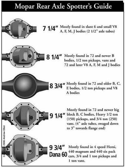

I have a 12 bolt rear end in my 76 new yorker.Im familiar with the 8 3/4 rear ends but know nothing about the 12 bolts.My question is this, keep the 12 bolt or swap it out for something else? Eventually i will be doing a mild engine build and upgrade the whole drivetrain.Any info or opinions are appreciated.
Its not a 12 bolt. Should be a 9 1/4, some small motored c bodies did have 8 1/4. You will not break a 9 1/4 but sure grips are weak except for new tru trac.
He'll never get enough horsepower to break that rear.
His problem is that more than likely it is a 2.73.
The 12 bolt Chrysler 9 1/4 rear axles are very strong. That's what trucks have used for years. Taken care of it will do fine in your car.
