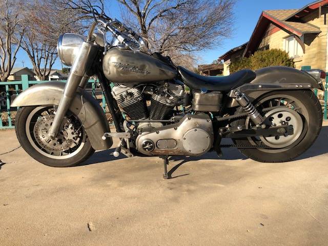

A badass machine but you're going to frighten a lot of seniors on this board with images like that!:rofl:
I made that grille out of two factory pieces....put a lot of work in on that...but could't see with the lights in the grille and bumper..so I went back to stock.

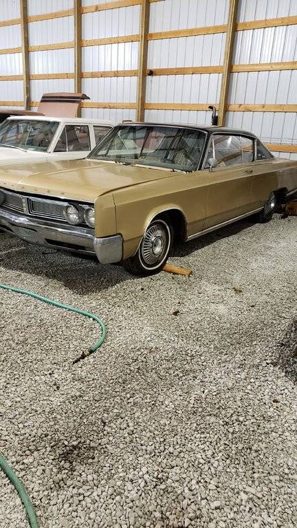

I have an original 67 manual steering chrysler Newport, and it drives remarkably easy.
granted the car came with 15x6 rims and bias ply tires, so a lot of the drivability issues today comes from radial tires with squatty sidewalls. I stay as close to stock as possible, no over sized tires on the front here.I have owned it 24 years,
and sitting still on gravel I can easily turn the steering wheel.
did 15's come stock? Mine's on 14's and it looks like a roller skate. Are there such things as 300 wheel covers? I want to keep a stock look but man I hate those little wheels!
