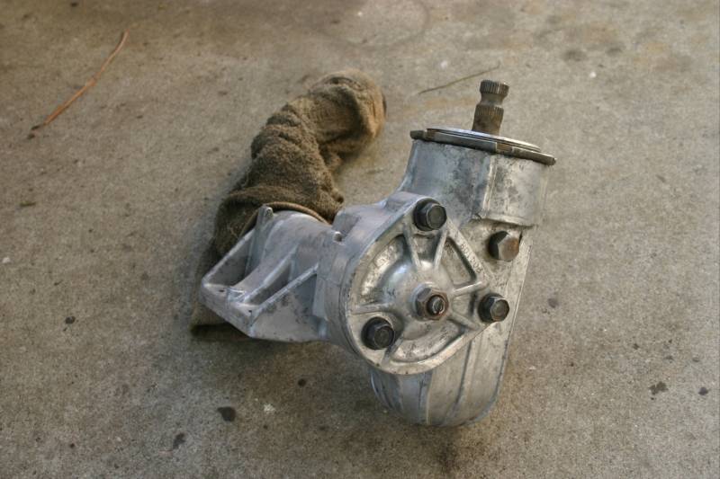

Update! Got the manual brakes swapped in. Guys...there is simply no need for power brakes on these cars...It was just a marketing ploy. Just look how happy this little guy is! Uses all correct parts.
But...if any of you nellies (nice ad campaign...insult your target demographic) want to swap to power, I'll sell the whole kit for 200 plus shipping. That's exactly what I paid for the manual stuff.
NOW BACK TO STEERING: I'm more confident than ever that I want to swap to manual steering. It's clear to me that the column itself is the same, but the second section forward of the u joint is a couple inches longer. worst case scenario is I'd have to cut, sleeve and weld that but I'd really rather not. I'd like to find the correct piece. Steering boxes are readily available, but that shaft section and Pitman arm are my hold ups. No rush...the power unit's doing fine and leak free.
Looks like the idler arm is the same- power or manual. National Moparts lists the Idler and pitman arns NOS. Thier used part department will be able to supply the longer lower steering column shaft.
Pitman arm should be no big deal, mopar P/N 2269398
https://www.ebay.com/itm/NOS-Mopar-...254036&hash=item53e197a1d7:g:c88AAMXQiNdRc~3f
Has anyone here ever separated a shaft there? I haven't even looked under that sheetmantal cover to see it. I'm guessing it's a U joint with pins or (hopefully) bolts to separate it?
It should be a rubber biscuit ~ 1-1/2" thick that's bolted to both the upper and lower shafts.
