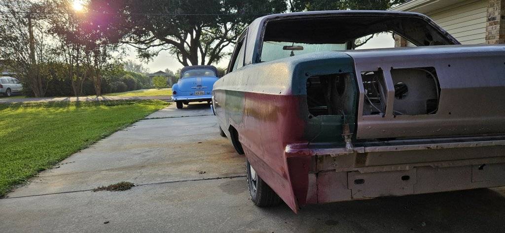

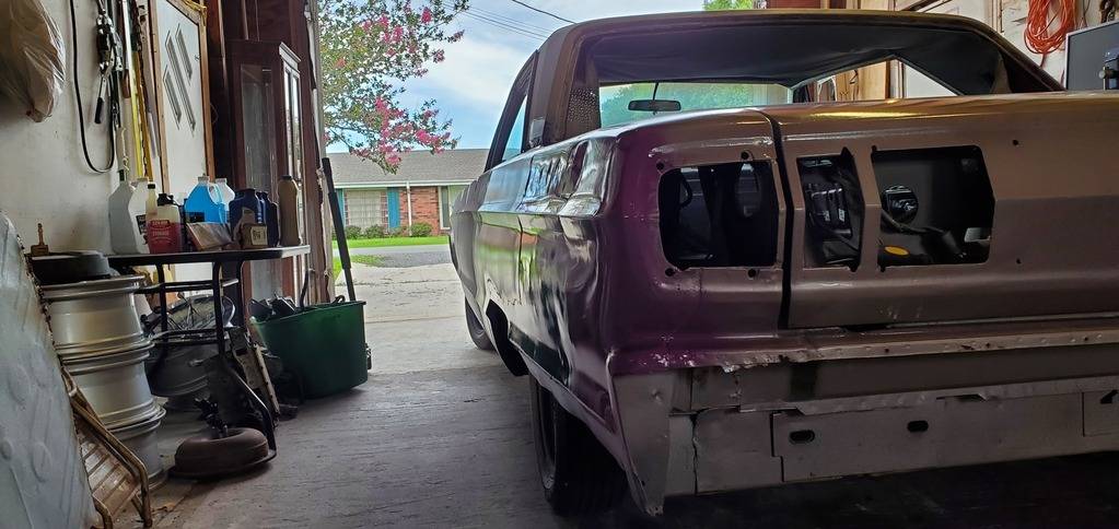

1966 Fury III - Unfinished Project
Tried to catch the same angle. Definitely an improvement.

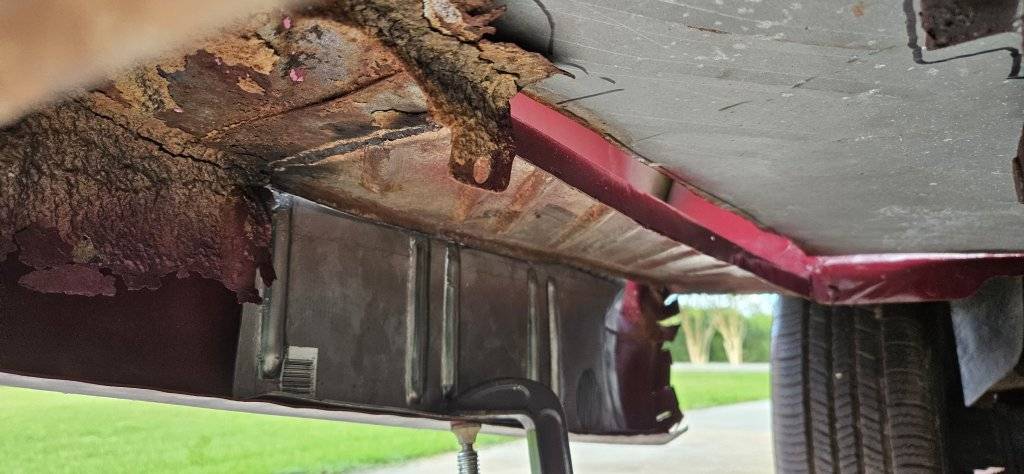

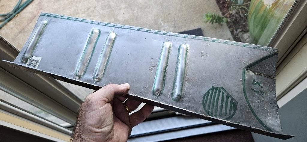

First of the inner panels to go on the inner edge of the quarter. This one's measured correctly.
That's from the end of the floor to the upkick panel. Using the outer quarter template to measure up.

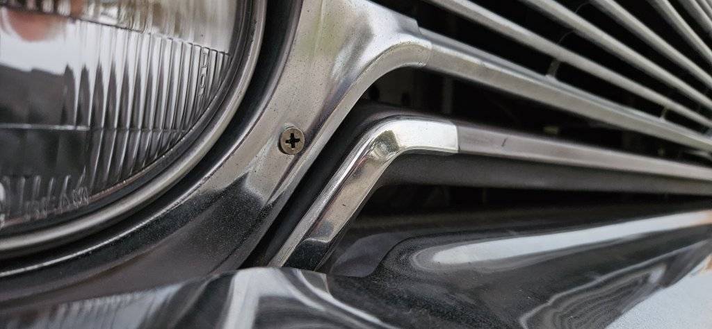

Surprisingly, this aluminum trim has remained shiny, despite being bare polished metal
I think the rest should tolerate being cleaned up. I need to get some paint thinners to strip the paint off the trim.

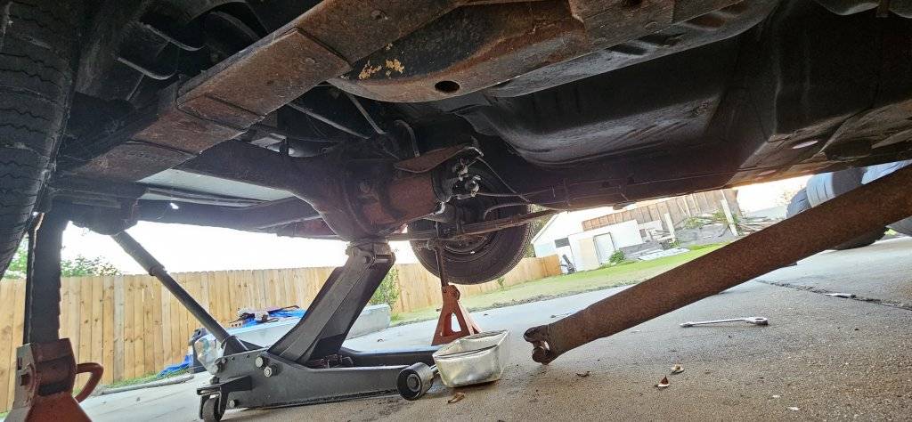

Well, help me understand.
Pulled the pinion carrier off.
Undid the nut, knocked the back of it one side then the other until it came off the splines.
Knocked it back on to keep it sealed but now it's wobbly. And it leaks.
Will the pinion nose bearing pull out that way?
Phil
Phil
I guess the first thing is why did you remove the yoke. Need a bit more info.
Not sure if this diff utilizes a crush sleeve to maintain preload. If it did there is a good chance it’s not tight enough. Also you may have damaged the seal when you did this procedure.
The yoke has been hogged out on one side and has half a screw stuck in the other. It is u/s and needs replacement.
The seal is still ok; the pinion now wobbles about, it didn't when I started.
Yup, looks like I've smashed the preload sleeve. Superb.
Guess I'll get a bearing if it needs it, seal and redo the nose of the axle while I'm at it.
Phil
Phil
Usually if you over tighten the nut it will squash the sleeve and the end result will be too much preload on the bearings. This will result in a very tight pinion not loose as you describe. I suspect you didn’t tighten it enough. I always check the number of threads showing prior to removing the nut. On reassembly I check the threads and rotate the pinion to see if it is getting too tight.
It's flopping about like the bearing has collapsed. I'll pull it apart again tomorrow if I have time and get a flashlight in there to see.
Phil
Phil

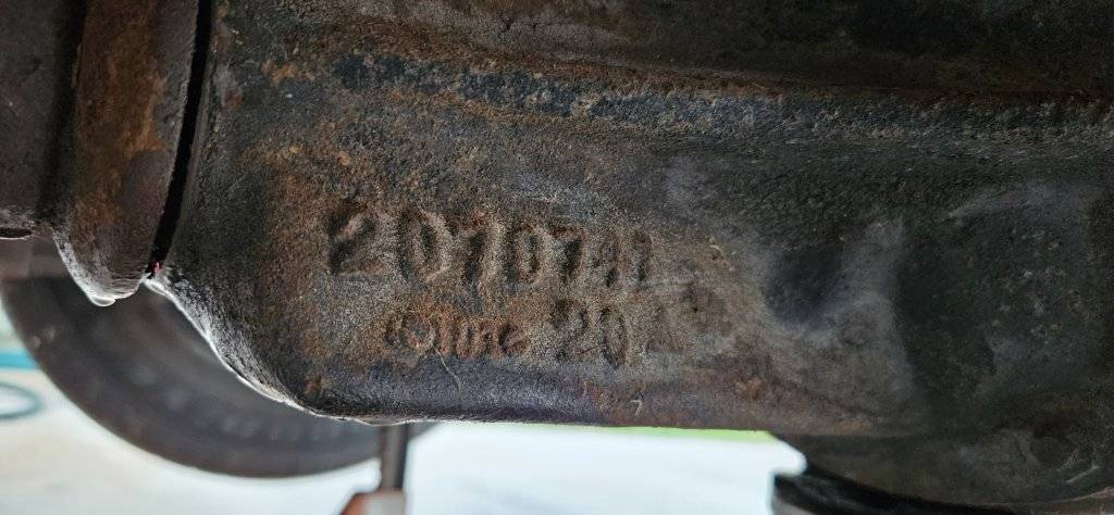

489 case is the only one that uses a crush sleeve. 741 & 742 cases don't.
Okay, so it's a 741, which matches the spec of the car.
So that means the pinion preload is set internally with shims and the yoke bolt just does up to a static lb/ft figure?
