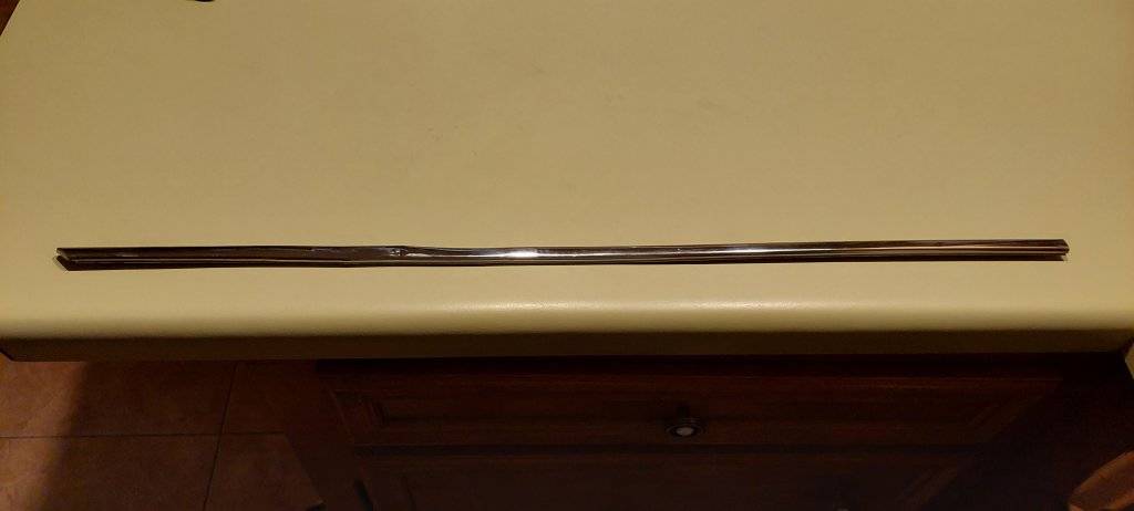

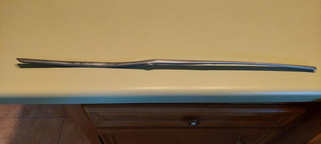

Little by little, piece by piece. It stopped raining long enough today to get the bodywork hammers out and straighten the drip rail out enough to be able to refit the trim.
The line (more or less) follows that of the other side, which is straight down following the window trim, and then curving gently in towards the back.
Next task, one I don't look forward to, is to try straighten the trim that came off because it snagged on the rail.
Looks like someone caught a signpost or gate or something with the drip rail and bent it all out of line, then a replacement trim was just snapped over it.
Phil
This is about the limit of my expertise.
I think that will clip on and stay on. Don't want to hammer it on because I'm afraid it won't come off without twisting again.

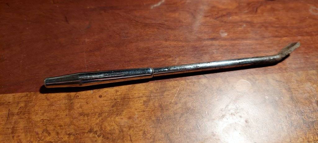

Oh... I didn't notice it's broken... welding that will melt the turn signal switch unless you can get the remaining bit off before welding it...
If I couldn't find a replacement, or remove the end bit easily from the turn signal switch, I would make some sort of a sleeve that encapsulates both halves, fill it with JB Weld, and stuff 'em togther. A McDonald's shake straw comes to mind...

Next up I'll see about taking the turn signal switch apart. Looks like there's screw threads down the center of the fractured portion.

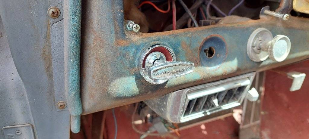

I found the handle for the parking brake release. Funnily, the parking brake still works.

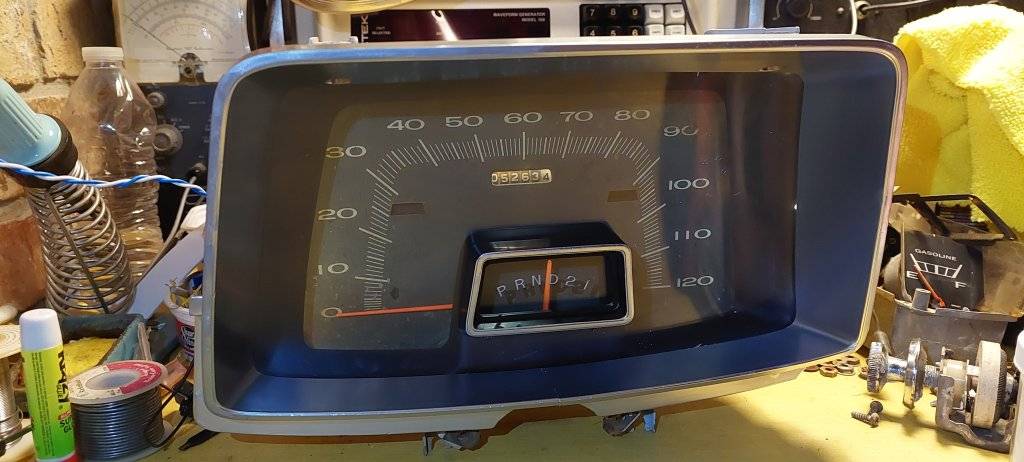

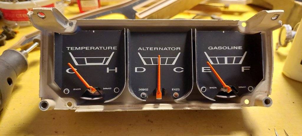

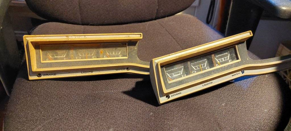

Because I'd pulled the gauges out to get at the mechanism, I decided to clean them up.
The ones in the car were dirty, the spares ended up submerged in rainwater during the storm.
I tested the gauges. Surprisingly, they all worked, including the ones that had been under water.

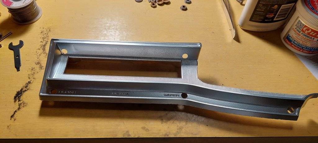

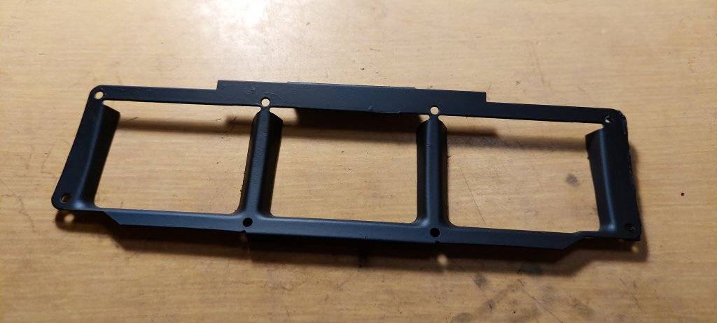

Cleaned up the PCB and repaired a couple broken traces.

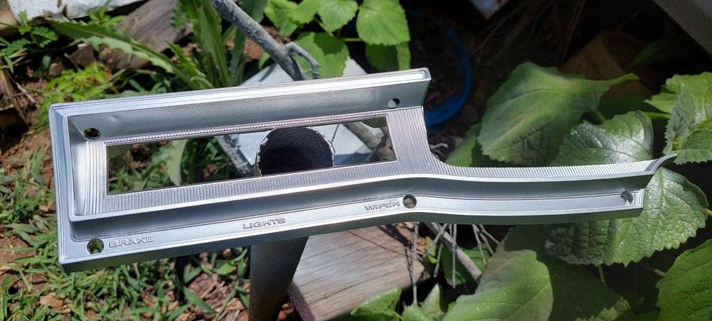

Wire wheeled the rust and paint off the mask, repainted it flat black.
The chrome was all gone, so the next best thing in budget- the shiniest "metallic" silver they had in a can. The area around the words, originally dull silver can go back pale gray. The fluted section in the middle, back to flat black.
Hopefully that'll look nice.
I found a brighter silver paint, even has a fair bit of reflection to it.
I'll wait for that to dry, it's very slow- then do the detail work on it.

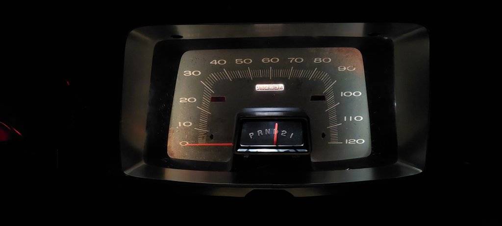

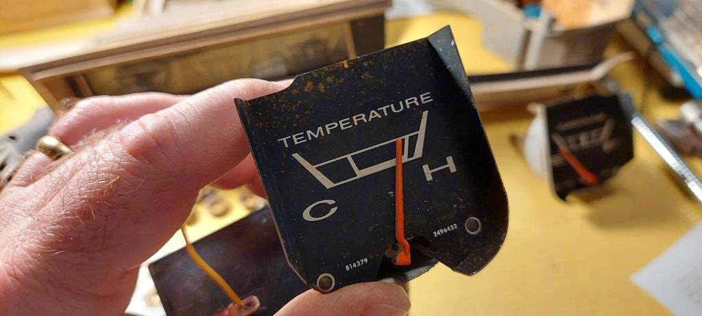

Between times I dug the flooded speedometer out of the storage.
It's a little worse for wear, having been submerged in rainwater for several weeks. The mechanism is rusted solid.
Still, it cleaned up nicely. The surround is cracked and the plastic lens is crazed. The inside edge of the bezel needs to be painted pale gray, it's a little bit too shiny.
The PCB cleaned up though, and the lights work. Neat design that the light shines through the odometer hole to illuminate the gear position indicator.
