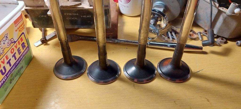

Welp, these valves are pretty mediocre now. 2 left on this head and then I'll lap them in.
They've recieved do-or-die reface. I'm surprised I had any compression at all.

Lifted the other eight valves out, I'll tidy those up over the next couple days.
This head is less bad; that, however is relative. It's still bad but I've a little less work to do.

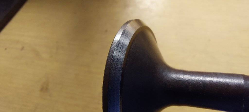

With just a gentle skim of the sealing face you can see just how badly these valves have burned.
Faced down smooth and flat. Correct angle takes a steady hand.

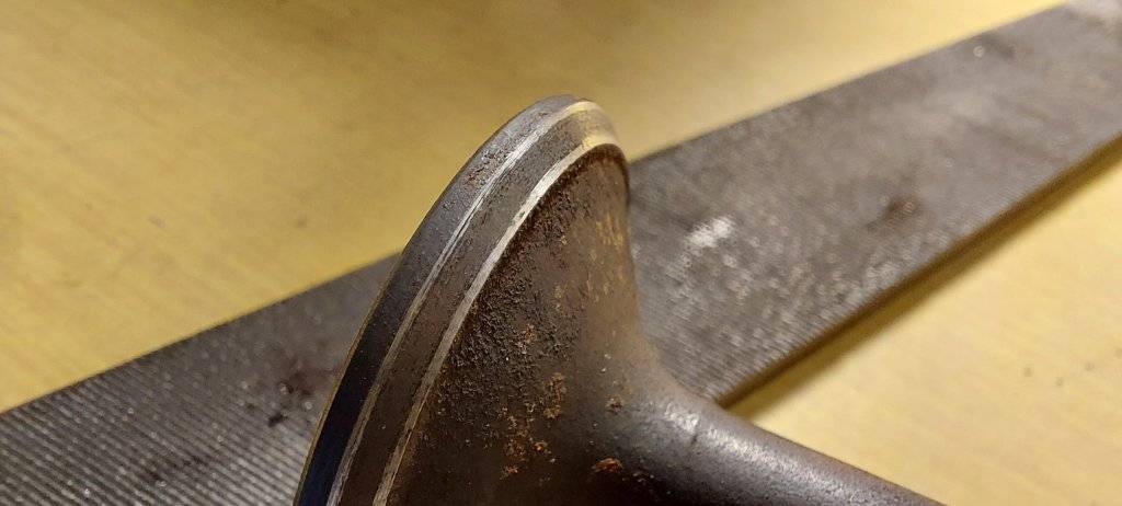

Repeat. Got the intakes to clean up next, then the head and those will then lap in.
We'll see how they last. Ha.

And the same, but cleaned up. I'm going to claim golf ball physics on this being better than stock. The random pattern of dimples on the surface will cut down on boundary layer shear and allow better gas flow into the cylinder. It's a high performance part.
The others on this side weren't so bad. All faces cleaned up.. okay. Those can grind in to the seats tonight if it doesn't rain.

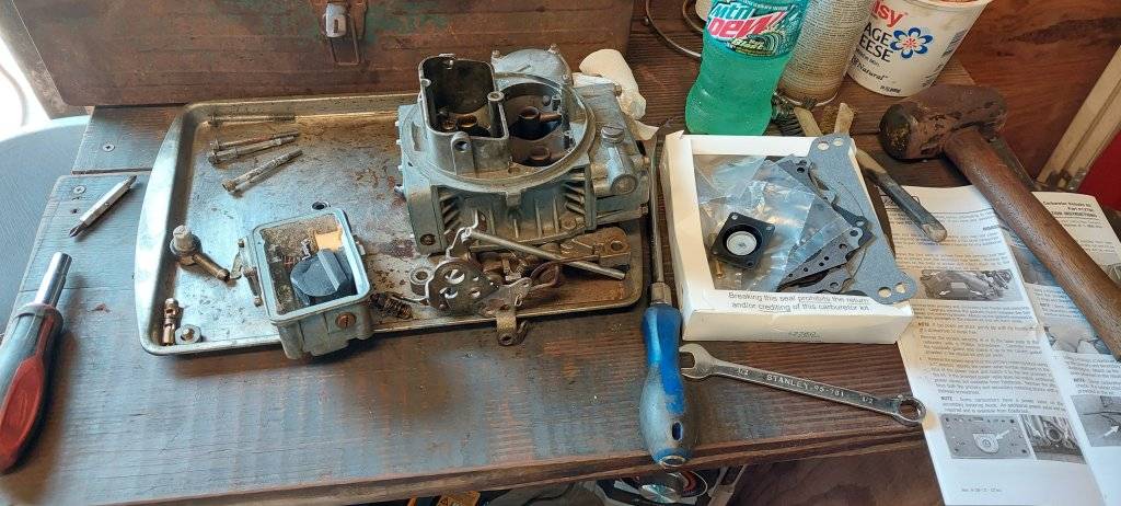

Compression is good, carburetor sucks but there's fuel there, ignition shows fire at 5° ATDC on plug 1.
All it did was cough and sneeze and fart fire out the carb a few times.
It's liking to backfire and sneeze back out the carb a bunch. Put rebuild kit on the carb, float keeps getting stuck.
Annoyances.
