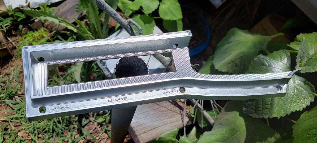

I found a brighter silver paint, even has a fair bit of reflection to it.
I'll wait for that to dry, it's very slow- then do the detail work on it.

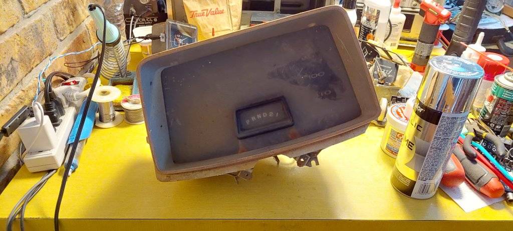

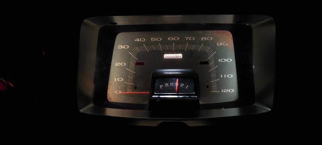

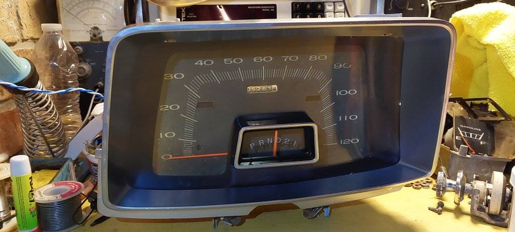

Between times I dug the flooded speedometer out of the storage.
It's a little worse for wear, having been submerged in rainwater for several weeks. The mechanism is rusted solid.
Still, it cleaned up nicely. The surround is cracked and the plastic lens is crazed. The inside edge of the bezel needs to be painted pale gray, it's a little bit too shiny.
The PCB cleaned up though, and the lights work. Neat design that the light shines through the odometer hole to illuminate the gear position indicator.

Source of brighter silver paint?
O'Reilly Auto Parts. Dupli-Color Chrome finish.
Doesn't say for plastics on the can- I have a feeling it'll make some plastics go soft.
It is far from a chrome finish, even on polished metal (tried it) but it is the shiniest of all the "metallic" paints I have bought off-the-shelf.
I know there are some mirrored finish paints but this is close.
This stuff ^
Phil

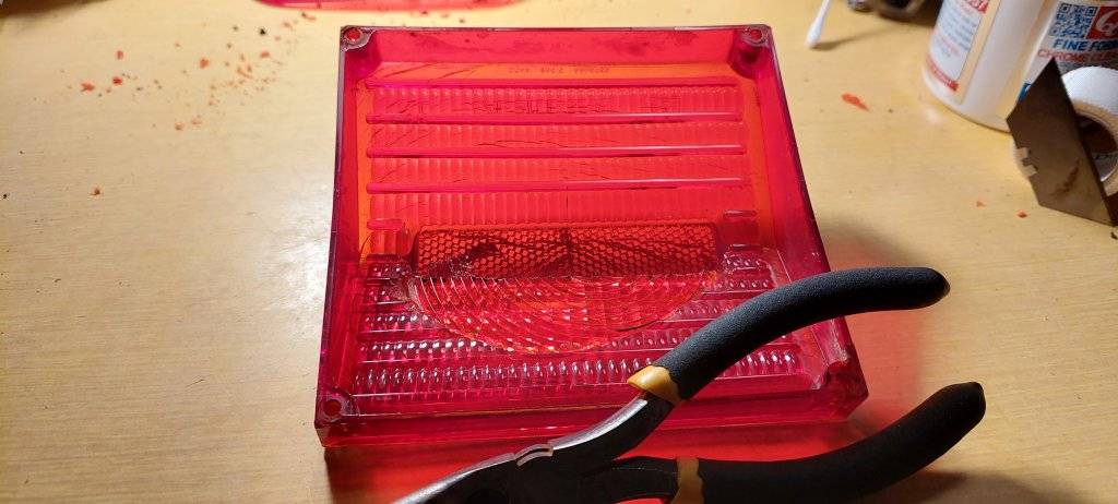

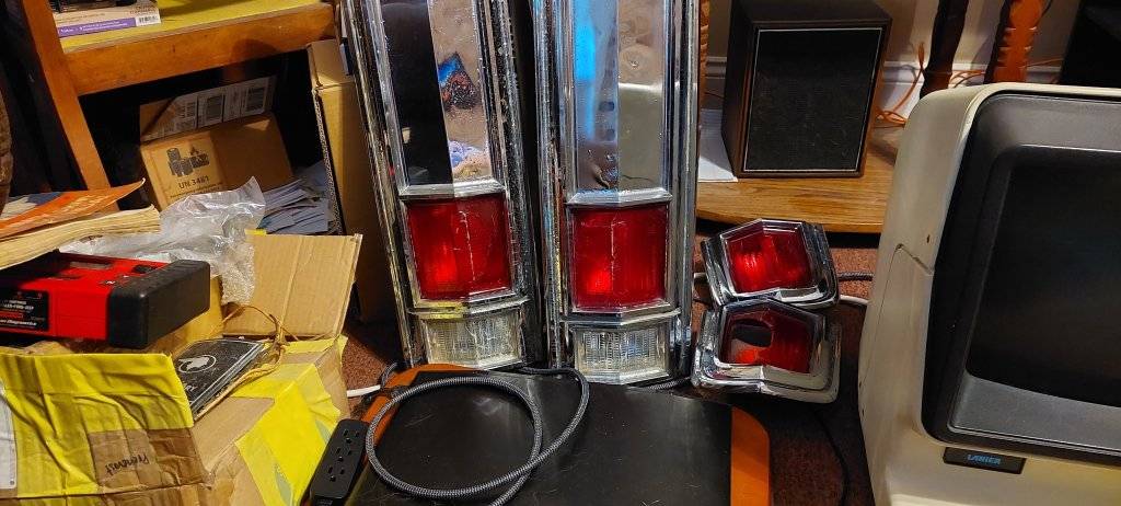

I bought a cheap red lens at the auto parts store with intent on cutting it up to make repairs to the center two red lenses.
The plastics have done the usual thing and dismantled themselves, so I chopped up a couple of pieces and put them in.
Imperfect, yes.
Ok from 20 feet and not going to let the water in? Yes.
Phil

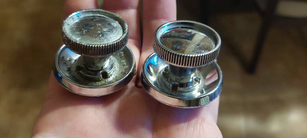

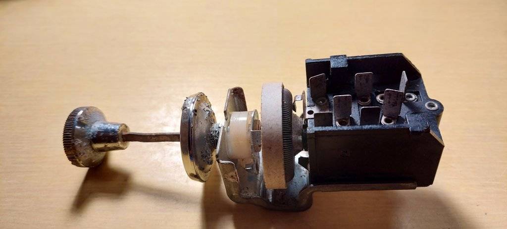

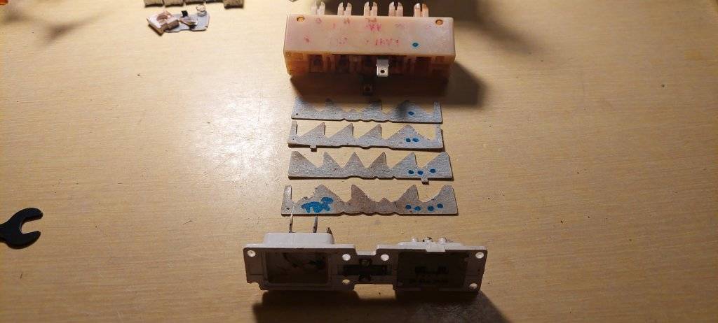

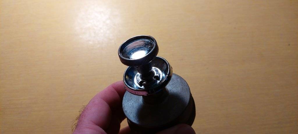

I'm not sure this light switch is much more good.
It makes clunking and pinging noises, has no detents and the knob will not pull out.
Time to get the drill warmed up.
Phil

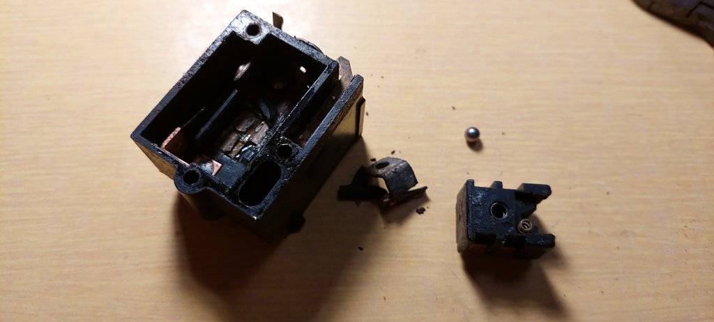

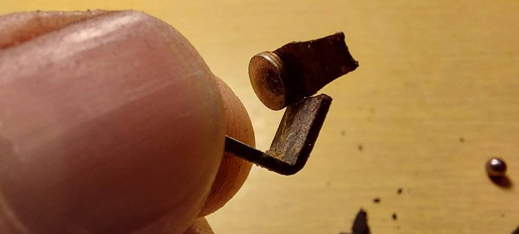

Nope.
That's half of the bimetallic circuit breaker arm welded to a piece that I'm not sure where it should go.
Either way, that's beyond economic repair, new switch time.

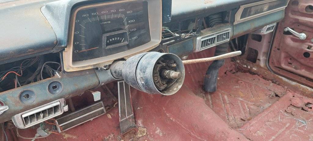

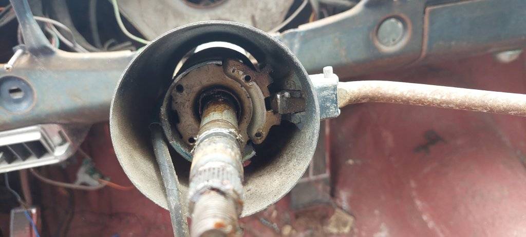

Fought with pullers and eventually got the steering wheel off.
Naturally, the turn signal switch is broken. I sense a recurring theme with this car.
I need to look in the manual to see how the column and switch come out. Feels like there's a clamp holding the turn signal wire in place.

While I haven’t pulled a turn signal switch on a 66, on Shamu, my 69 Fury III vert, I had to de-pin the connector at the base of the steering column. The FSM will aide you, if nothing else, the schematic will.
Oddly the manual doesn't have an exploded diagram of the column, just a few random images showing how to remove the steering shaft circlip, amongst a few other actions.
There's a moderate amount of slack- I pulled the speedometer out and that gives better visibility to the wires.
Digging in the dash is going to be fun, there's mud daubers making a nest in the defrost tubes.

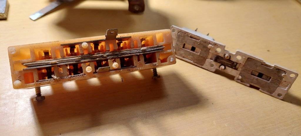

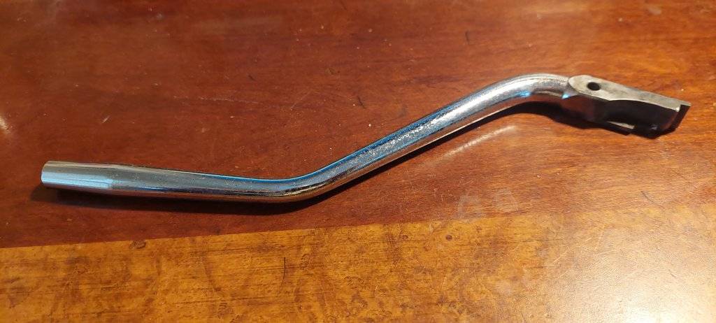

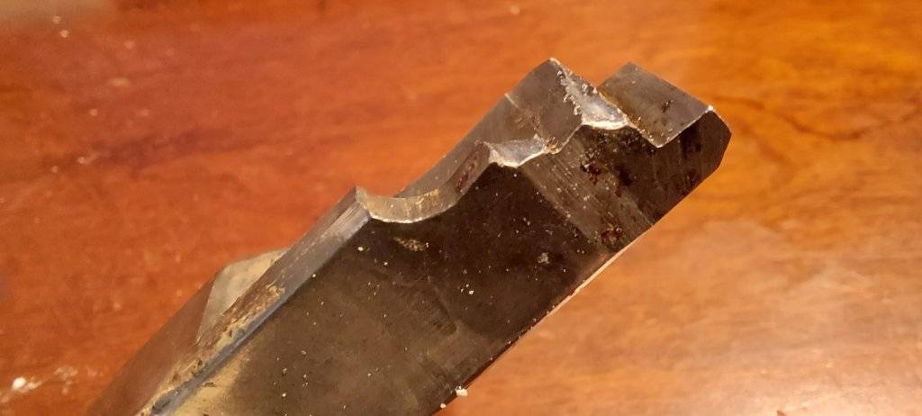

Turns out if you pull hard enough, anything comes apart.
Selector plate is loose. Next investigation point there.
The plate fork is worn away, that'll need building back up with a bit of weld and grinding back to shape.
Cleaned up ok in the end.

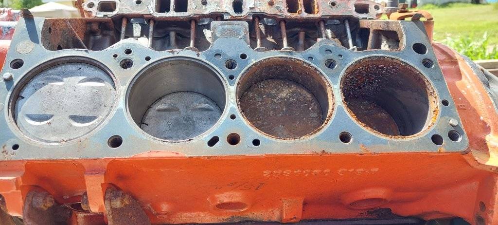

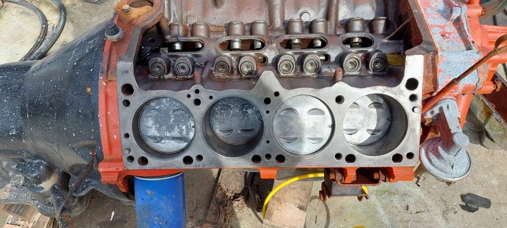

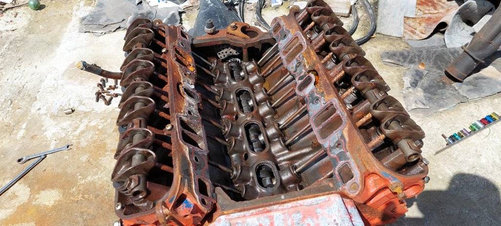

Started on pulling the engine apart today.
That's pretty nasty. Wasp nest in the oil gallery is a nice touch
All four rear cylinders are bad. Oh well.
Genuine Cuban rebuild (wire brush).

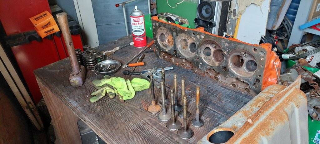

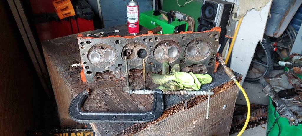

Started on the valves. I'm just going to clean that up, lap the valves in and reassemble. Good enough to get it running.
Phil
Couldn't find my valve spring compressor.
Bought a new tool at AutoZone which is more work but still works.
