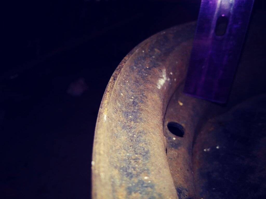

Here's one of the correct style rims. It's very shallow in the center where the lugs are.
This one is a 5-1/2 incher:

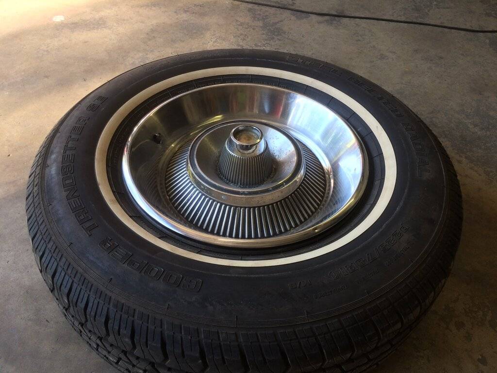

Deep dish installed:

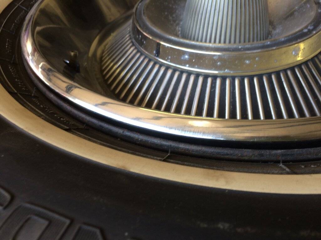

The covers don't sit tight to the lip of the wheel. Chrysler left lots of room for wheel weights.
Next up is the same wheel cover on a 6 inch rim.
6 incher has the same gap at the lip.

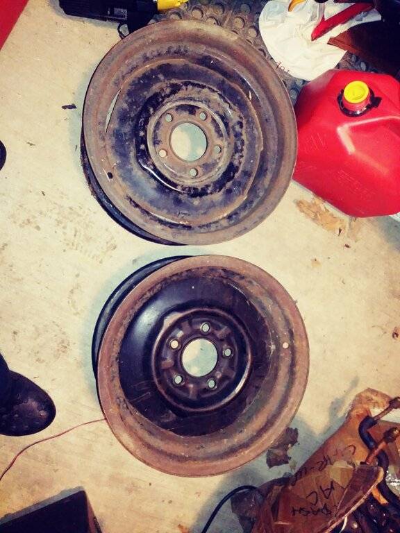

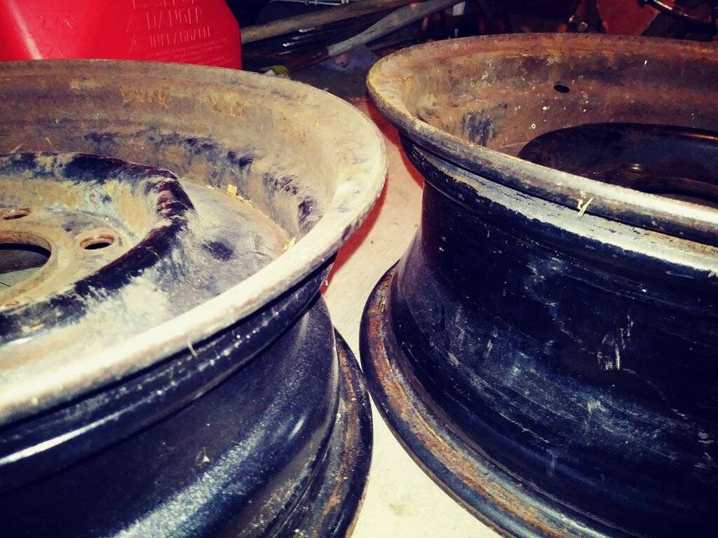

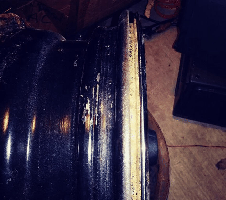

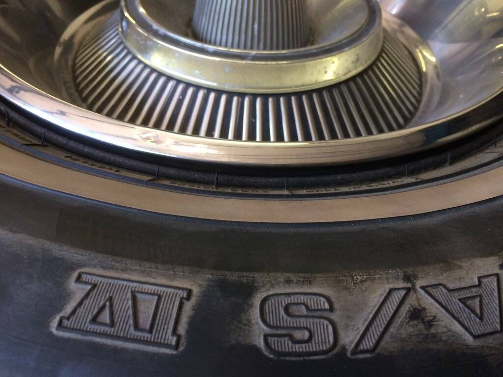

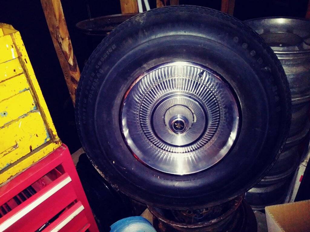

I broke out my rims and test fitted a driver deep dish. Both on a 5.5 and 6 inch.
They do stick out more on the 5.5 compared to the 6 inch...5.5 shown
My point is they sit better with the correct rims. Yes they will work on 5.5 but will stick out.

These two 14" rims are from slightly different eras. The 5.5" is a safety-type with four hubcap bumps. The 6" is likely closer to what would have been available in the mid 60s, except it has the smaller hubcap.
Proper wheelcover fit is best established with the wheel on the car, and checked on a front wheel to make sure the hub clears.

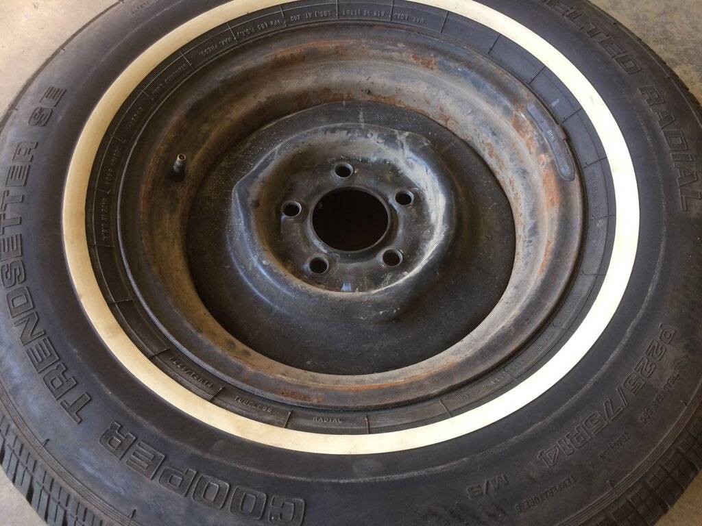

My wheels appear to look like this dimensionally
by appearance, the "depth" of my Newp's wheel would seem to accept the "deep dish" turbine wheel cover. giving the "look" below
ostensibly, my '66 14x5.5 has a similar looking face as the 14x6 cbarge shows.
boiling it down, and Gregg48203's astute observation, the wheels on my car fit fine and with little doubt are original to the car.
i therefore should try to swap covers on my existing wheels using bigmoparjeff's experience. that does NOT mean i would NOT also wind up with this problem the cbarge shows -- because eyeballin' my 14x5.5 wheel isnt accurate enough
