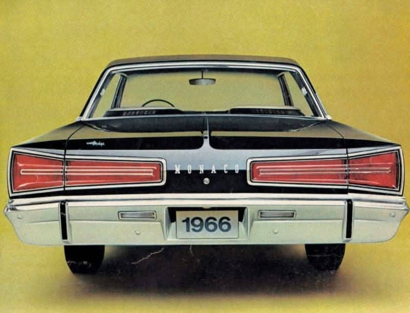

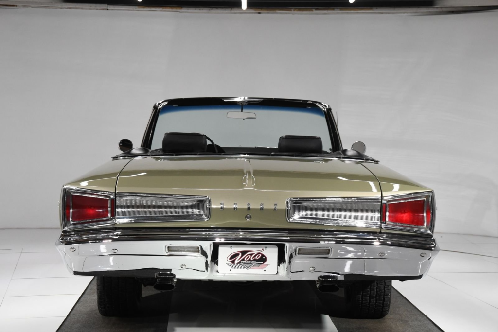

1966 POLARA rear
1966 MONACO rear
As far as I know, the Monaco outer tail lights will bolt into a Polara, and vice versa.

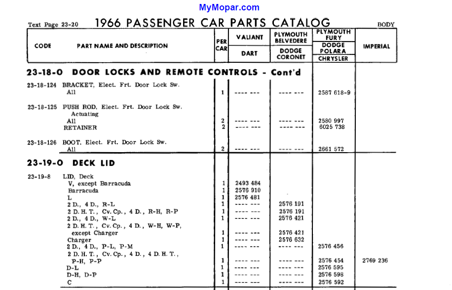

The caveat is: the INNER tail lights for a Monaco may NOT bolt into a Polara trunk lid. The trunk lid (deck lid) has a different part number between Dodge Low line (Polara and), and Dodge High line (Polara 500 and Monaco) and Dodge Premium (Monaco 500).
Dodge Low line 2576 595
Dodge High line and Premium 2576 598
This may be due to the various lettering differences between them, but I believe somebody told me once that there is a slight difference in the deck lid with the Polara's filler panels and the structure behind them, and the same area on a Monaco where there needs to be room for the full tail light buckets. I could be wrong.
