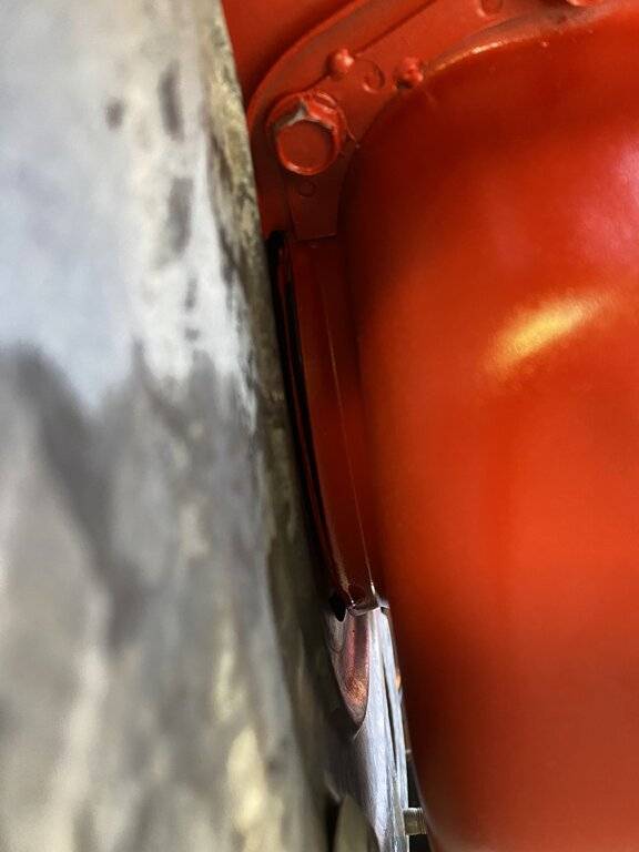

Polling the people. Still have this slow drip. Fresh rebuild. Do I proceed with my first fire just to yank it later or do I take it back out now?
View attachment 433029 View attachment 433030
I really can't quite see a oil drip other than the lower part of the oil pan gasket seal. Now if this is a leak from the 80psi oil prime as I take it you haven't had the engine fully up and running? Rear main seal on these old engines can be problematic. I remember the old original seal that were white rope type material the tip/instructions were to soak the halves in engine oil before installation. This is also a aid when you replace the seal with the engine in car as it helps the rope slide into the channel. The later black colored (graphite?) and even rubber half type seals don't need any soak just a pre-lube with oil or grease. Also gooping the corners and round oil pan rubber gasket with sealer is important (your choice) ie not dry assembly. Both front & rear.

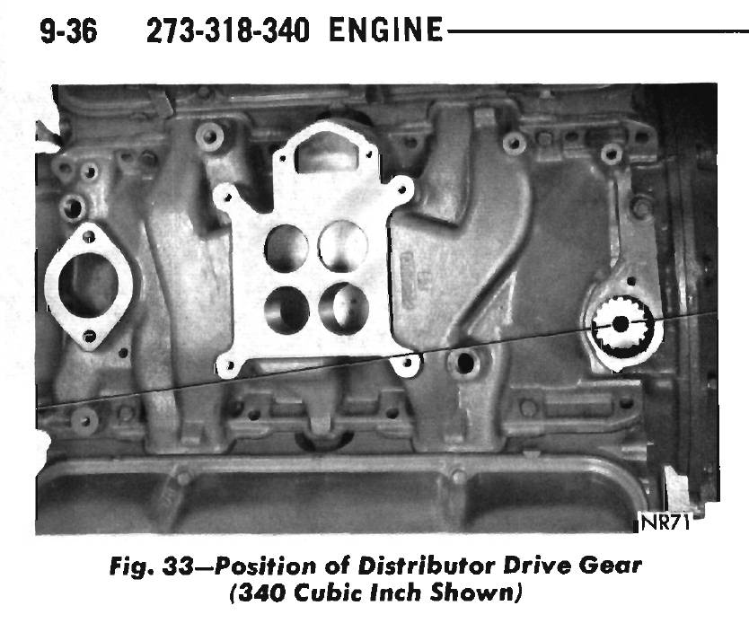

I took a picture of how the oil pump drive gear was oriented prior to removal. I inserted the 5/16 hex rod and spun with the drill. I was reading just under 80 psi. I replaced the oil pump drive gear in the same orientation as it was prior to removal. Replaced the distributor with the rotor pointed in the same direction, towards #1 cylinder.

"replaced the oil pump drive gear in the same orientation as it was prior to removal" Was this engine ever run up as in was the cam broken in?
Maybe you are 1 tooth off right from the git-go on the gear, refer to the Factory Service Manual it is your friend and best resource.
Your gear in proper orientation to FSM.
Factory Service Manual for 318/340 block:
Also your picture shows a awful lot of 'Carbon Crud' on the top of the drive gear IMO. It should be not shiny but of a lighter color as in bare metal. How well did your re-builder clean this old engine? Also I just now realized this is not the original 1967 engine but some 'Magnum' engine? So all that I posted from the FSM for 67/68 maybe moot.

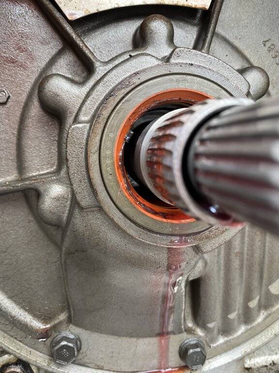

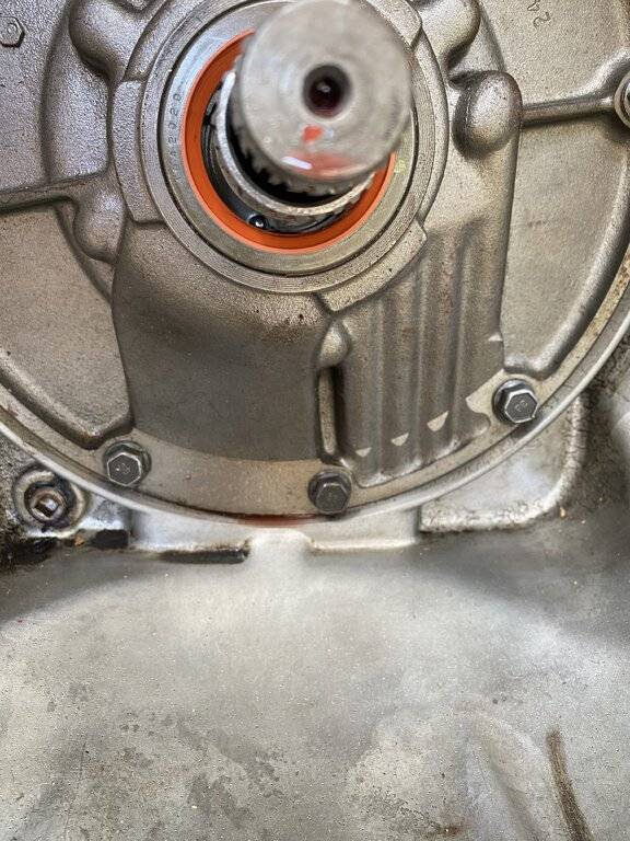

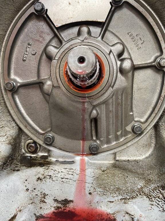

Also, my transmission is leaking fluid as fast as you can pour it in it seems like. It's leaking out of the bottom of the bellhousing where the dust shield is. The transmission was supposed to have all new seals put in. I don't know what's happening.

I just got caught up on this thread. Some of the leaks can be fixed in the car, but it may be easier to pull it and fix all of them at once. Trans leak from the bellhousing is probably the front pump seal, so either pull the trans or pull the engine
Definitely going to have to pull the transmission. It's aggravating because the transmission didn't leak like that before I took it out of service for the engine rebuild. While I had it out I figured I'd have all the seals replaced. Then when I fire it up, it's in worse condition than it was before I took it out.
Took the transmission back out today. I believe my front seal is leaking. Had fluid coming out when I removed the torque converter. I wiped everything clean and there still seemed to be a slow leak.
