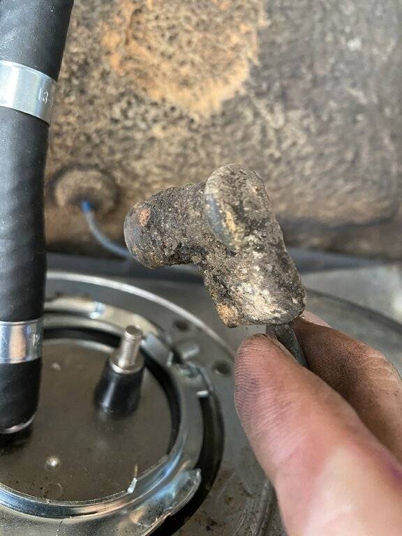

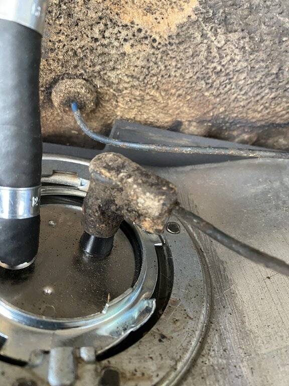

Quick Question: does the electrical connection just press on the the fuel sending unit?

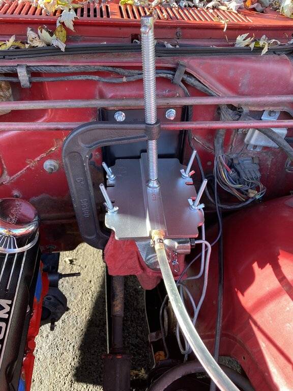

Attempted to bleed the front passenger wheel cylinder - Ran thru a lot of fluid trying to get the bubbles out. Ran out before I could keep bleeding. So basically I only got the rears done. I was using the motive products power brake bleeder

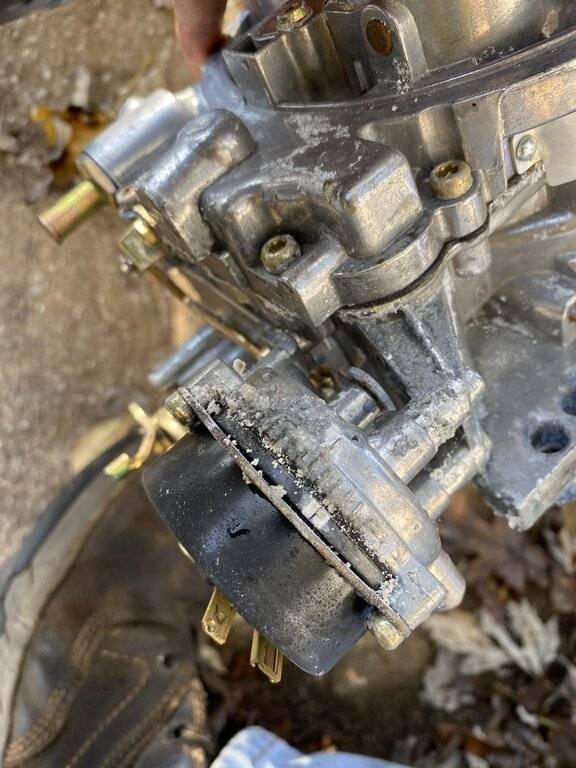

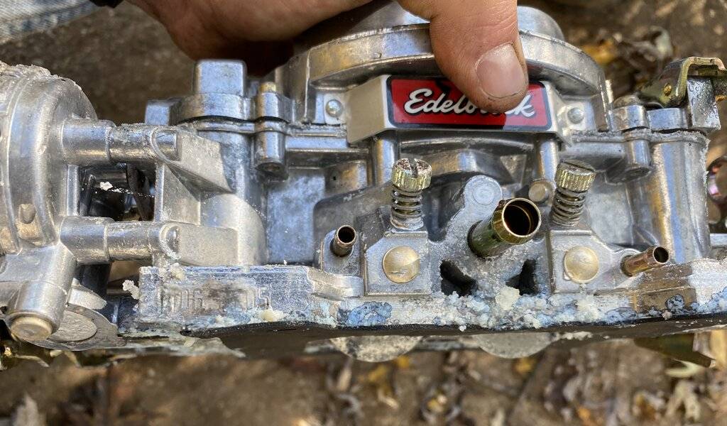

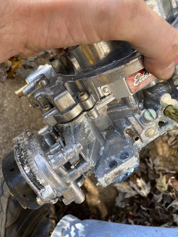

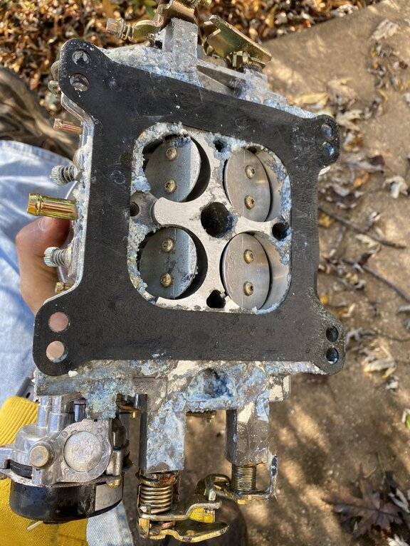

Frustrating moment of the day. I have been storing some parts in an outdoor storage shed. I have to keep everything at my parents home and I feel bad taking up all the inside space. No garage. For a year everything has remained dry. Well I checked this weekend and the inside was soaked. My carb looks like it has been wet for a while now (it was boxed and wrapped in the plastic packaging). Not sure what I want to do. I bought it from a guy who stated he had only used it briefly. It looked brand new. Now it looks like crap. Might just say heck with it and buy a Holley Street Avenger 570???? I don't know.
Push the lead for the sensor on as far as it will go and it should be good, yours looks to not be on all the way. The carb is a mess. Try soaking it in a bucket of diesel, that should free it up and release some of the crud. It may have stuff on the inside too so figure on taking it apart for cleaning. A brass brush should remove the worst of the stuff on the outside after the soaking.

Finished bleeding today. I guess I just needed more time on the passenger side front. All good now. Front driver side is done too.

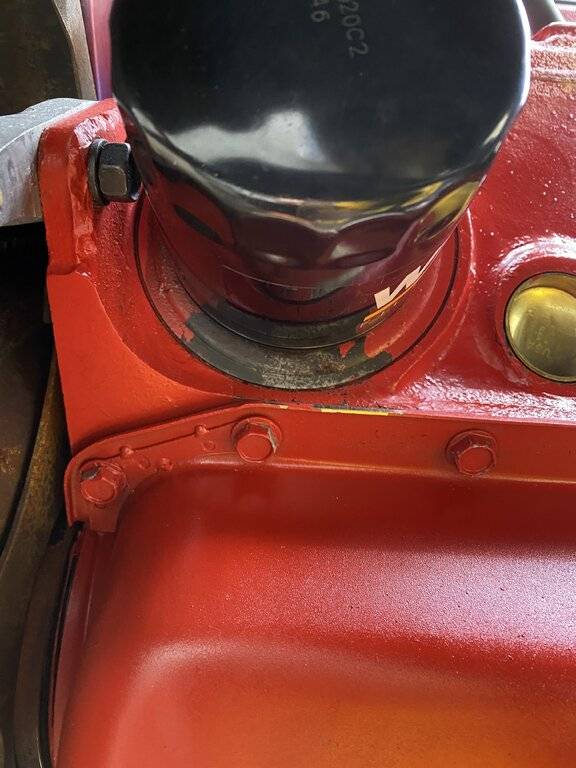

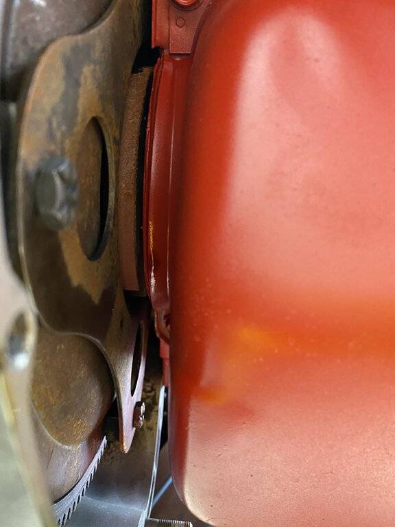

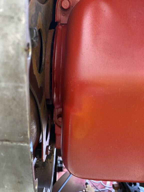

Well this project just came to a screeching halt. Looks like the pan or something is leaking. Ugh now I don’t know how I want to proceed. There is a slow small drip.
Is it possible for oil to leak from that big outer circle around the oil filter. It looked a little wet around that area so I wiped. No only was it wet but I guess from the moisture of the oil the paint wiped right off too.
I think if the oil is leaking from the filter or that large outer circle that’s how the oil ended up on the rear of the pan. I’ve had the front of the car jacked up pretty high today and is could have rain backwards. Pretty frustrating day. I’ve been buttoning this thing up and getting it ready to try starting for the first time and then I see this!
I took the oil filter off and it’s dry as a bone around the gasket and such. I don’t know where the leak is coming from. About to say F it and take this daggon thing out again.

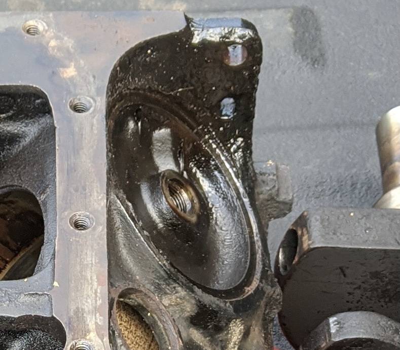

View attachment 422099 Is it possible for oil to leak from that big outer circle around the oil filter. It looked a little wet around that area so I wiped. No only was it wet but I guess from the moisture of the oil the paint wiped right off too.

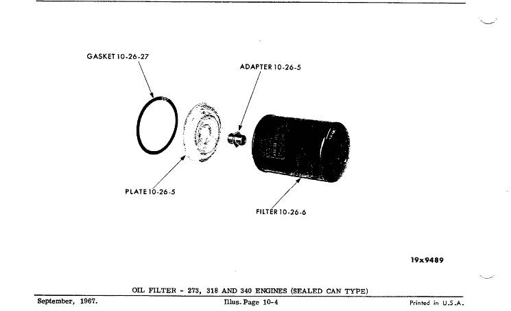

aaaYep there's a gasket under the plate, part number 10-26-27.
From the 1968 parts catalog 318 engine.
Bummer.....this has been coming along so well. Frustrating for sure. I know you were working on the carbs too. Is it running yet? I figure before removing the engine that you try to run the motor to build up the oil pressure and can see where it may be leaking from. If it is not running...I also wonder if you are able to “prime” the engine using a drill to help build up pressure too. I think others in the forum can talk about how to do this technique. Definitely some YouTube videos to show how. Good luck man.
I was making progress today. Put on the carb. Hooked up some of the linkage. Torqued some other bolts I hadn't torqued yet. Fooled with some wiring. I was making decent progress today and then I saw this leak...

Wow - Who knew. Didn't even know that came off. Now the next question...where does one find said gasket? I'll start googling.

It comes with the overhaul gasket set, check to be sure the new one is not still in the box. Not the first time a rebuilder forgot to change out the old one.

Good call! If I don't find it, is it called an oil filter adapter gasket?
1967 PLYMOUTH FURY 5.2L 318cid V8 Oil Filter Adapter Gasket | RockAuto
Yes and the 318 engines all probably used the same one. The early poly 318 engines had a cartridge filter, most of these were later adapted to the later spin on filter using the Fram adapter kit. If all else fails, you could always use the gasket from a cartridge filter under the adapter plate. You might also want to check to be sure the adapter is tight on the block.

Well I just had a quick spin through your photos and the picture of the block in the back of the pickup it looks like the adapter is off but the plate is still there.

(edit) oh and also about your parts store ie carb corrosion... Condensation is a *****!

Is this the picture you are referencing? Are you saying the gasket is found under the layer that is there?
