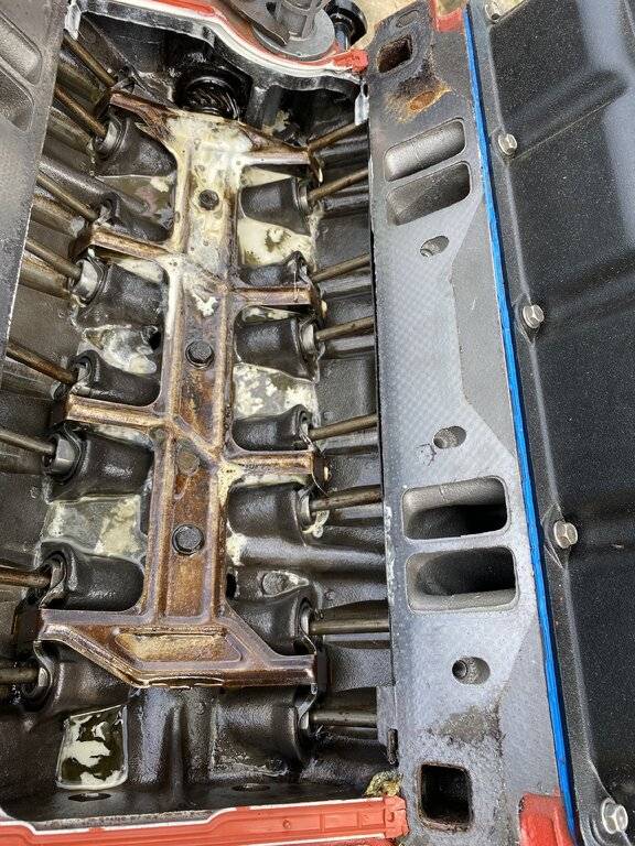

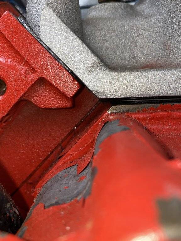

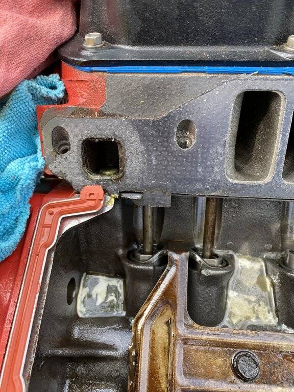

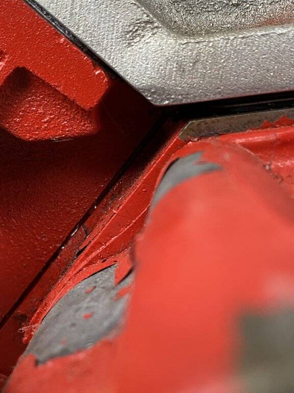

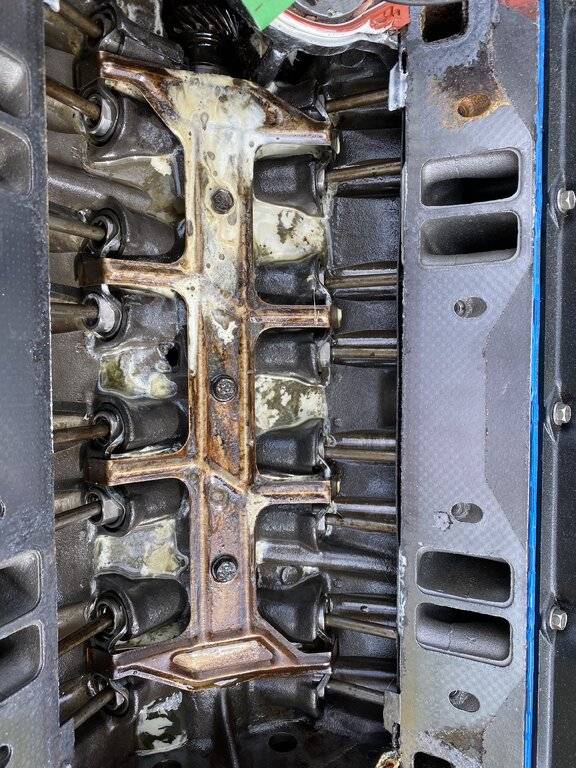

Pulled the engine again. Took the intake off. Looks like maybe they didn’t use RTV around the water jackets and each corner.

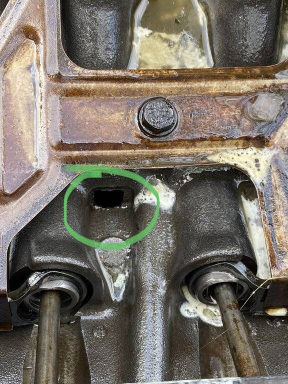

Also are the two holes in the valley area normal? This is a 95 magnum engine.

View attachment 456972 View attachment 456973 View attachment 456974 View attachment 456975 View attachment 456976 View attachment 456977
That is a oil drain back hole to keep oil from collecting in the valley, so yes normal. Looking at your water ports, I am not sure they are the source of the coolant leak. Check the intake manifold coolant ports, does the one above the rusty port at the rear of the engine also have the dark spot on the sealing surface? If so, that could be the leak source. If the head and/or the block was surfaced, that will sometimes cause an alignment problem getting the coolant ports to seal. Do you know if the engine builder used steel shim type head gaskets or the modern blue coated ones? A lot of old liners still haven't figured out that you can never use sealant on the blue gaskets, they will always eventually leak if you do. Check your spark plugs, if a cylinder is pulling coolant, that plug will usually be discolored.

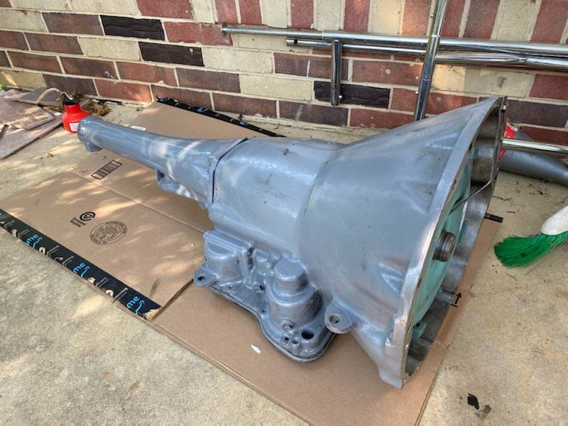

So I have been M.I.A for a long time. Prior to two weeks ago I hadn't touched the car since May 30th.
When I pulled the engine and transmission the second time, I did take the transmission to be rebuilt. I went to Annapolis Transmission on Margaret Ave. I told them I am running a stock motor and just looking to have a cruiser. My service sheet is out in the car but I think they installed a TransGo TF-1 kit, among other things, if I recall correctly (I'm probably wrong, that was back in May. I'll double check).
I installed the transmission at the end of May, but only had time enough to get the transmission up in place.

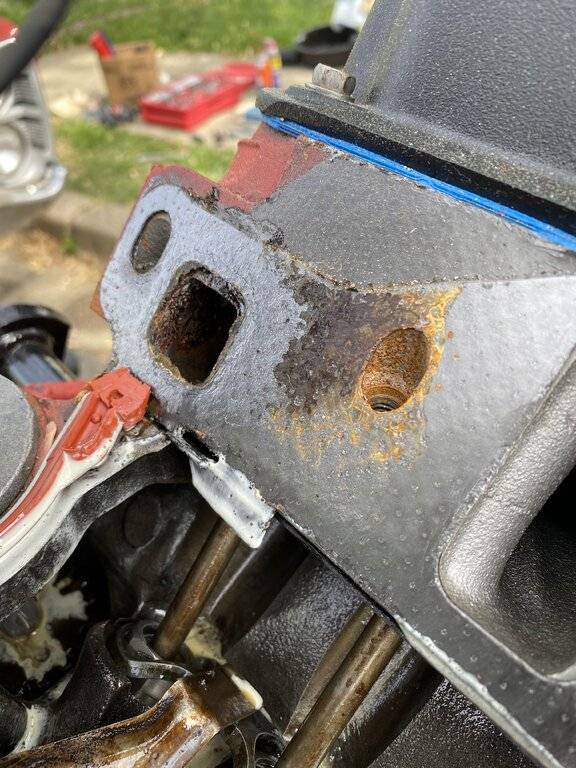

Question - I was prepping to start up my fury again today. I filled up the radiator with water and not long after, I’ve got water coming out of the exhaust manifold bolt holes.
Do the exhaust manifold bolt holes go into the water jacket? Or does that mean I have a bad seal somewhere else internally?
Again, this is a 95 5.2 magnum. I had t started it yet, only filled up the radiator.

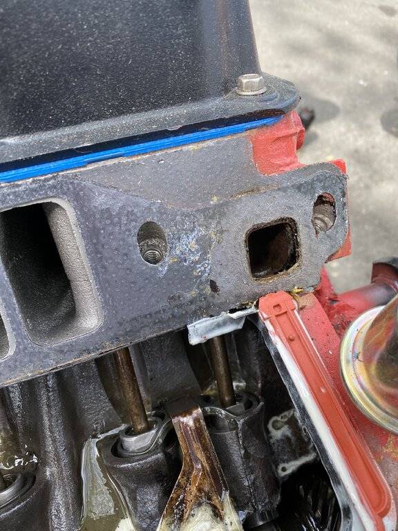

Well, not only is it leaking from the manifold bolt hole, it looks like it’s leaking in the corner again where the head and intake manifold come together.
Seems to be some water in the oil too. Without even starting it. So for now, the question would be how so I leave the motor sit for now until I figure out my next move. Obviously it water in the internals that will lead to rust. Should I drain the oil that is currently mixed with water and then pour oil back in and leave it sit in that state?

I would drain the oil and the cooling system (radiator and block). Put oil back in it.
