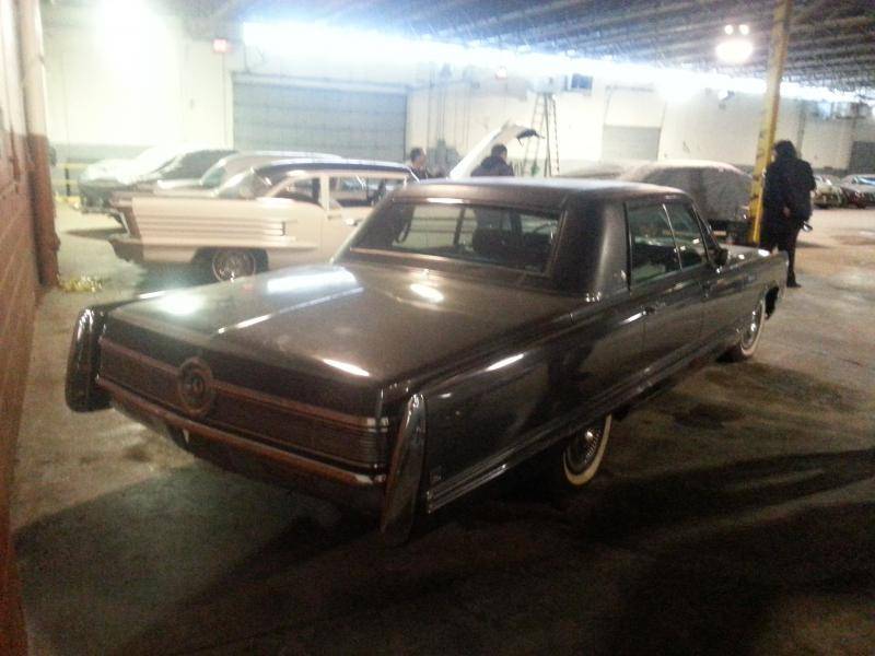

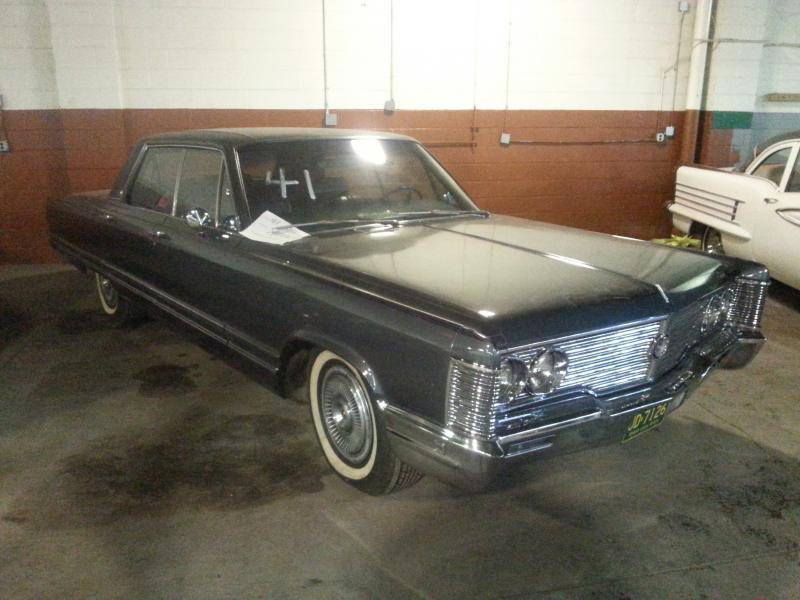

My book says charcoal gray metallic. Nice car Hemitheus. What was it like dealing with the family who owned the collection?
Real good. The gransdon, Blake, is a real good guy. Down to earth. I was expecting a lot more pretentious. Fortunately there was none of that.

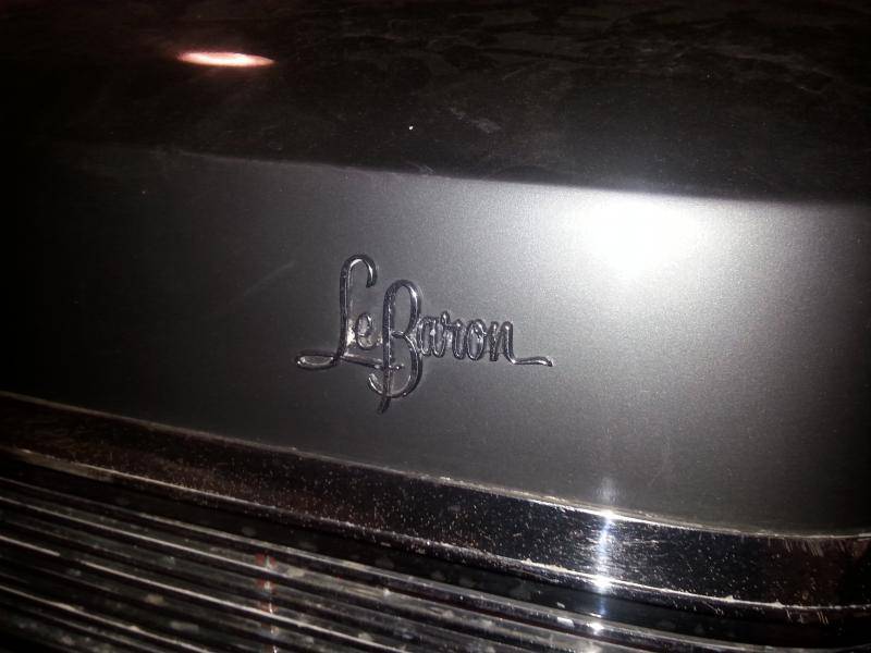

Does your book reference the color code for Charcoal Gray Metallic? the name is spot on. Fender tag says 551. Odd that I cant find that code anywhere in the internet. THe most I could find is "5" which is close-ish I suppose.

It is just that, 551. It basically means that the whole car is that color or it is monotone.
Cool, thanks. Is it an uncommon color? google search has yielded little results. I like the color a lot.

Nice car. Its technically a D body, nothing else rides like one.
D body? Imperial only?

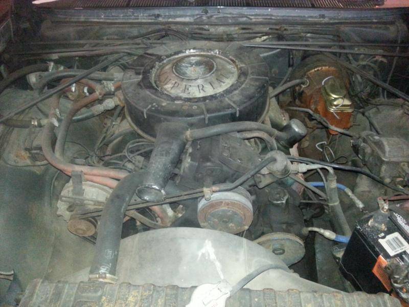

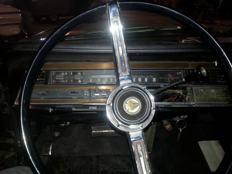

Nothing electrically works on the car except engine function, the radio and the window motors. The Check gauges light is on. No headlights, no taillights (but I do have brake lights) no signals, no interior lights, no dash lights or A/C Heat.
That's not good. Start checking bulbs but I'm guessing you're in for a rather expensive electrical headache. A tilt/tele turn signal switch for these cars can be hard to come by and expensive when you find one, you'll probably need to have the panel dimmer rebuilt, etc..

Might be as simple as no power getting to the main fuse block. If the cars been sitting our buddies (mice or vermine) could have knocked something out. Or dirty connections. The starter etc won't run through there. Just a thought.
This is somewhat where I was in my thought process. You know. As I am laying in bed trying to go to sleep but all I can think about is the new Imperial. HAHA

The "Check Gauges" light comes on when the oil pressure is low or when the fuel is low. I don't think it comes on for engine temp.
I think there is a separate oil pressure switch for the "Check Gauges" light, so your oil pressure gauge could be working properly but you could still be getting a light.
The most common reason (based on my anecdotal reading of the Imperial Club archives) is that the gas gauge isn't operating properly.
As for some of your other questions, Imperials had special striped tires, which could be one of your codes, electric antennas were options as well, so that's possible, even likely. Tilt/tele is also a common option, so you probably decoded that correctly as well.
There's lots of info out there on the turn signal cams. As Matt said, they're a pain. I think they're also a GM part, so they're currently reproduced, but do require some fiddling to get to work right in our cars. This info can be found at the Imperial club. There's also a Yahoo! Group for Imperials. Lots of good people there (mostly the same as the ones on the site).
