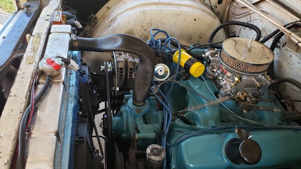

Should be a PCV on the passenger VC, oil fill and vent to air cleaner deal on the driver's side.
I would run a larger air cleaner if I were you too. That tiny thing you have is better suited to a motorcycle, or lawn mower lol. A decent 14" x 3" air cleaner will have room for the vent to attach to the underside of the filter base too.
PCV should come into the back of the carb.
c-sick thanks for the comments. I don't intend to hook back to the aircleaner base - I was wondering if I can cap them off or connect them to each other etc. are you saying undo the pipe plug at back of carb and route both to there?

I would run a PCV valve to manifold vacuum. On the other valve cover you can just run a combination breather/oil fill. If you don't provide a way to eliminate crankcase pressure you'll end up with oil leaks at every seal.

so - the pulleys on this motor were all for A/C - and i removed the A/C compressor. has anyone done an A/C delete? how did you deal with all the belt routing with no A/C pulley?
