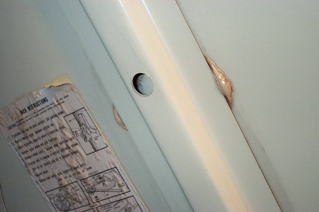

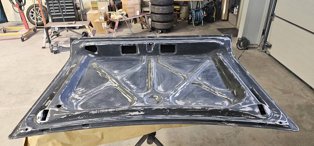

Isn't there some space between the sandwich of the inner frame & outer sheet metal? That's the way all my cars are built. Depending on how much space there is & how hard the material, you may be able to just physically cut & release. On one of my cars, a previous owner removed the original caulk material on the hood which caused it to flutter at speed. I bought some 3M stuff & injected it in the spaces where the original material was. While it doesn't look like the original, it solved the problem & did not expand or contract which 3M claimed in their specs.
Your work to date is awesome.:thumbsup:
As Alan correctly stated, I unfortunately don't have that option on my Trunk Lid. Other than the Hood, it's one continuous panel without openings. I even had to drill some holes to inject the foam.

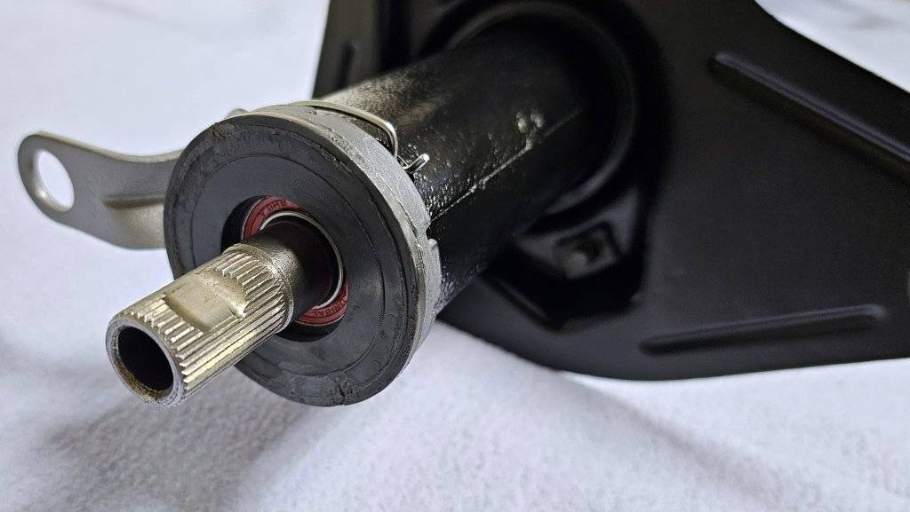

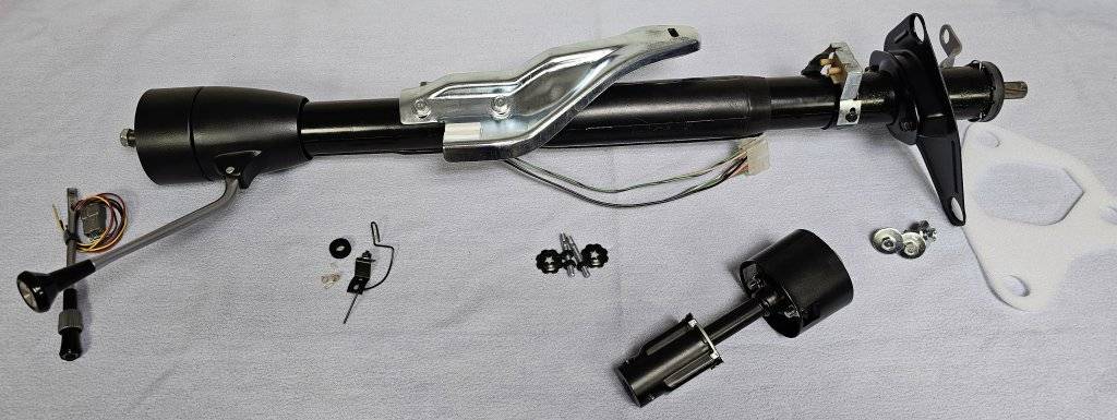

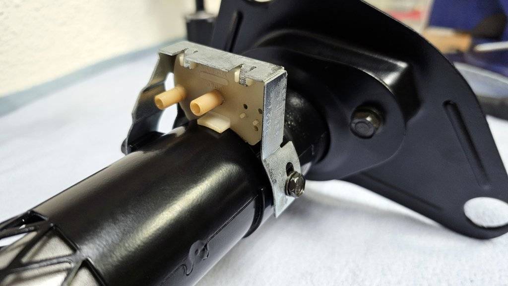

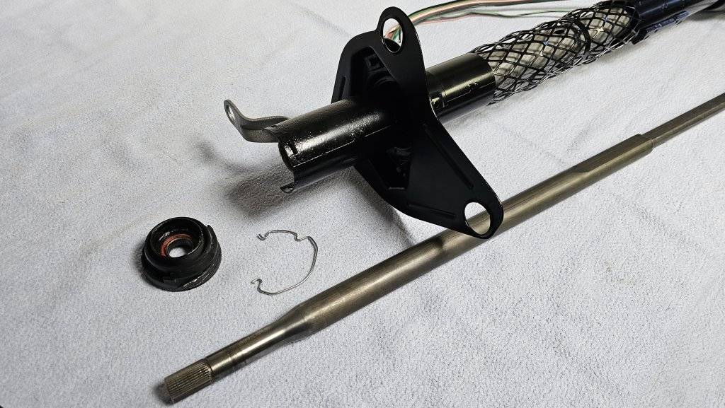

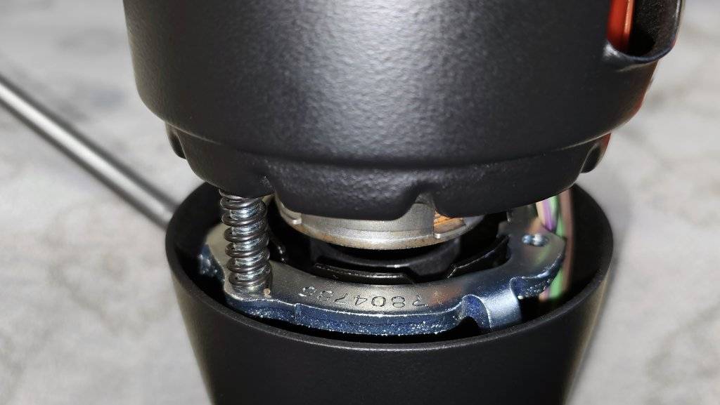

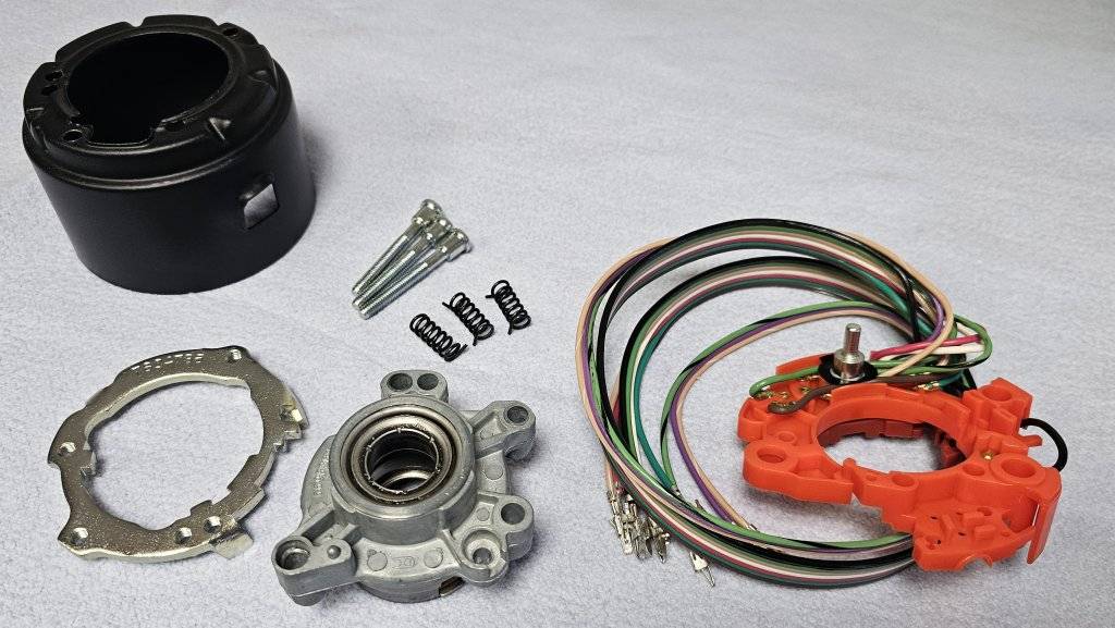

After waiting forever for some NOS parts I finally was able to reassemble the steering column.
As usual, all the otiginal parts were media blasted, zinc plated and painted to look as good as new or even better! :)

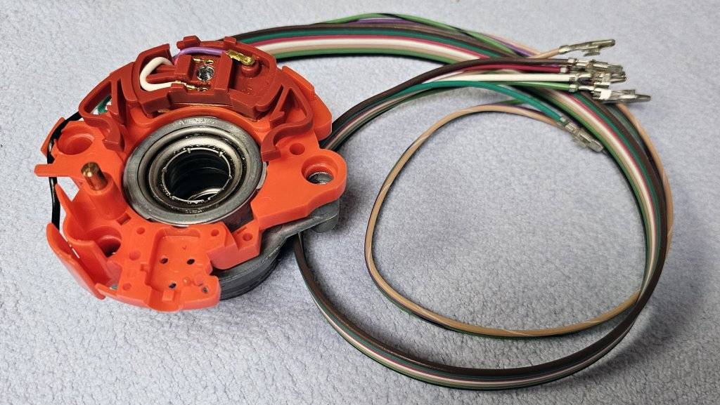

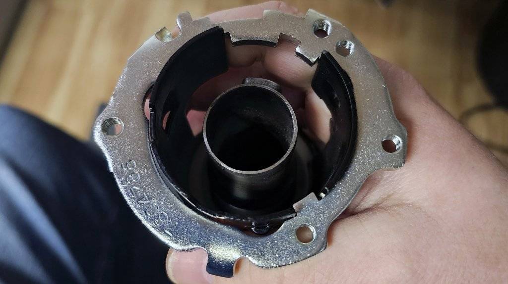

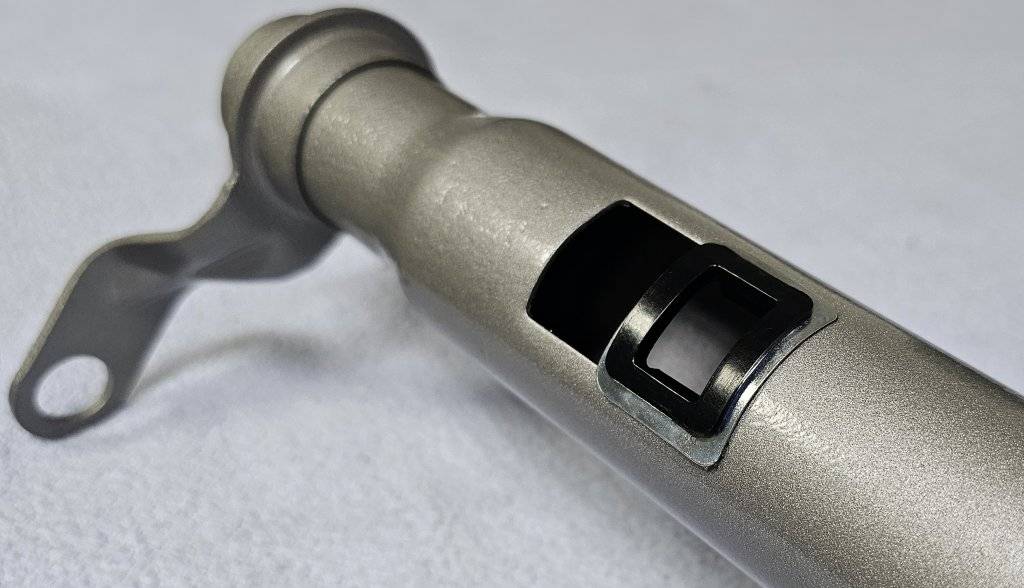

A new Turn Signal Switch (Shee-Mar SM-107) and a NOS Turn Signal Switch housing. Unfortunately, its original grease was all gummed up, so I removed it and filled the bearing up with fresh grease.

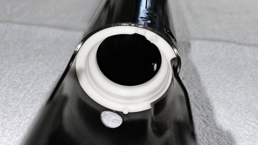

A NOS Shift Tube Bearing was installed.

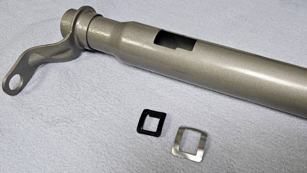

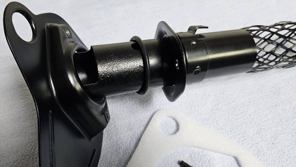

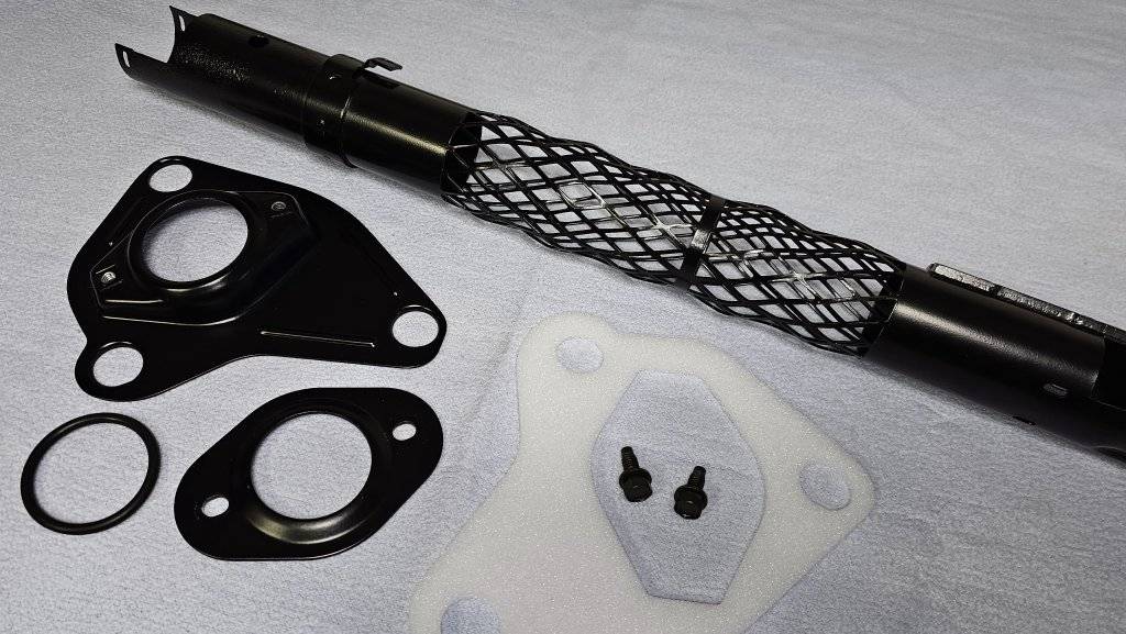

The O-Ring Seal is for a B-Body (DMT part# CHR6026275), but fits very well and a new Column to firewall gasket (DMT part#CXX6973SC01) is ready to be installed.
The original metal gasket was somehow too lose, so I added a layer of 3M Scotchgard Tape to the rear. Now it fits very well.

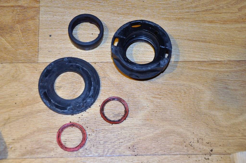

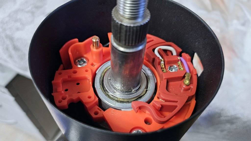

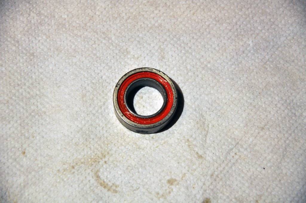

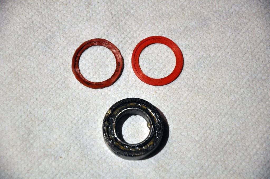

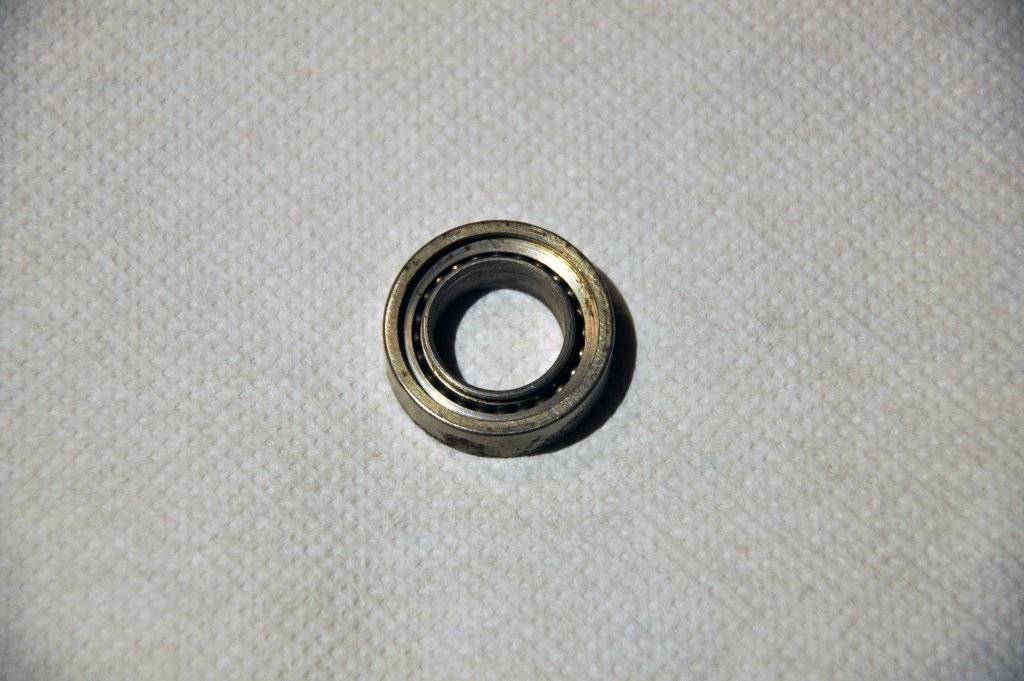

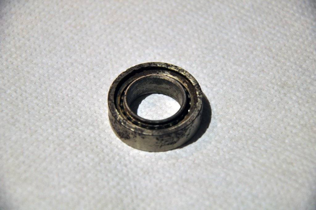

Unfortunately, I was not able to find a NOS Lower Bearing, so I took it apart to removed the bearing. It was very rusty, so I cleaned all the old grease out of it and then removed the rust with evaporust.
Then I filled it with fresh grease and reinstalled the seals. It's not perfect, but it will work.

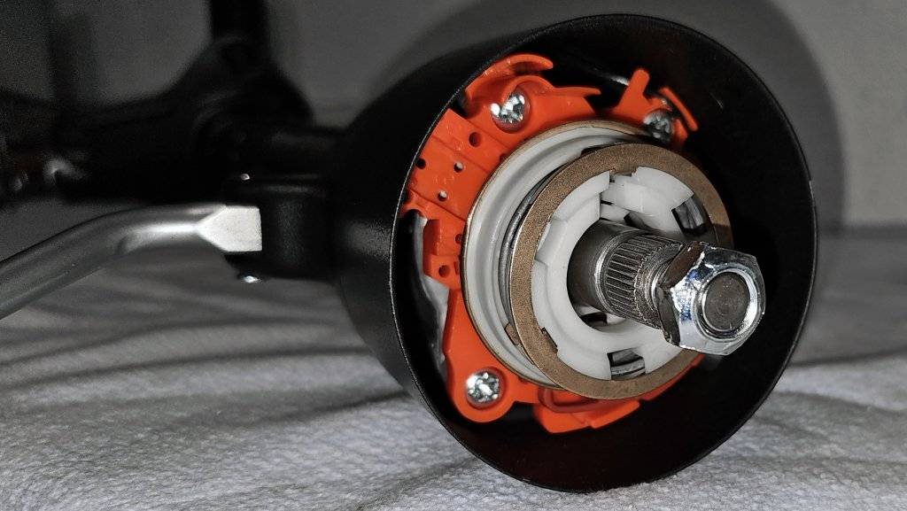

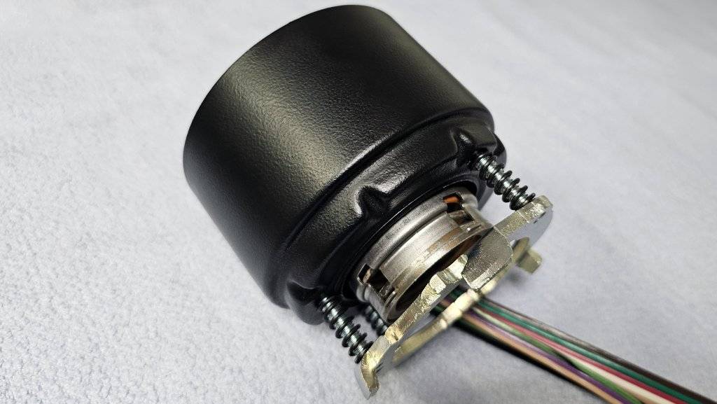

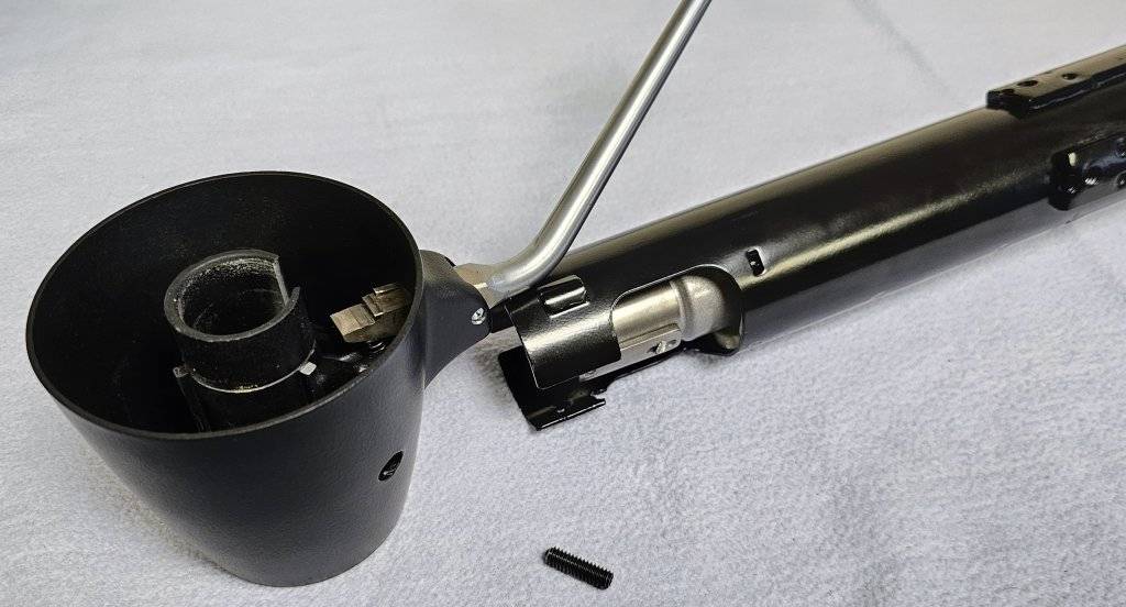

A NOS Horn Ring was installed.

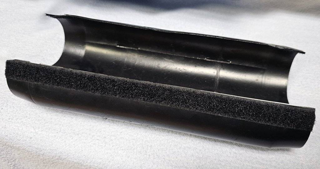

Since the Column Jacket is welded originally, I had to cut it off. To reattach it, I used velcro.
The result is looking pretty nice if I may say so.
What a disgrace! Forever and ever you will always know that rusty old lower bearing is helping to turn your wheels! :poke:
:rofl: :rofl: :rofl:
As usual, spectacular!
Who are you and what did you do with real Julian?:poke:

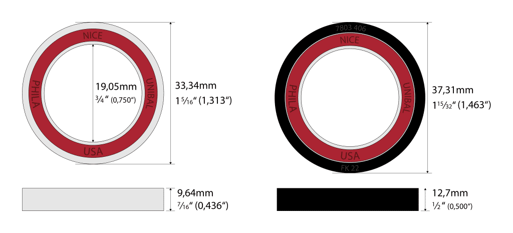

It's not that I haven't tried! I searched for years for a NOS one but there is none...
The part I need would be: 2950 504 - Lower Steering Column Bearing
My bearing is fine, just not like new. I makes very little noise.
I talked to a big bearing seller and tried to find a new ball bearing with the correct measurements but there is none available with the correct dimensions...
I even contacted the manufacturer of the OEM bearing in hopes of getting a new bearing from them, but they don't even list specially made bearing for the automotive industry...

The rust is removed and converted.
