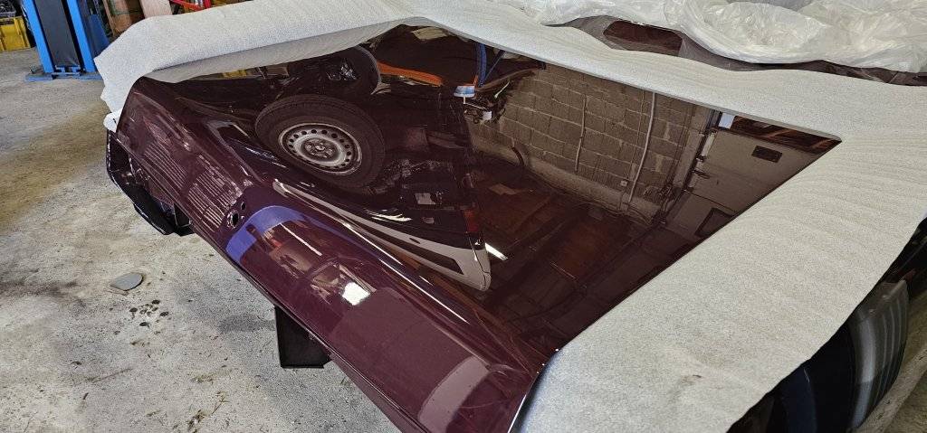

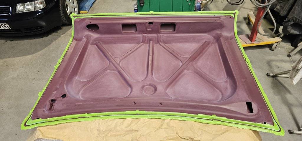

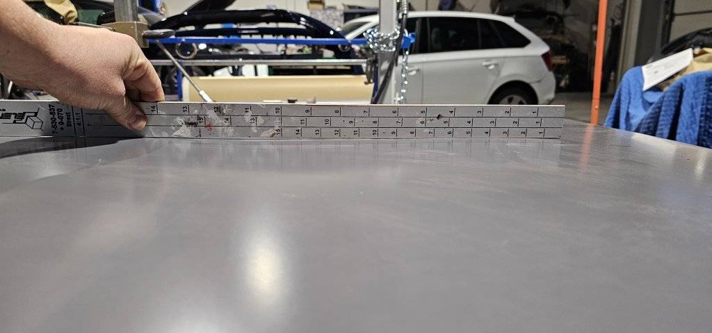

Some good news from my painter as well. He finished the Trunk Lid and Fender Skirts and is working on the Hood and Fenders now, which are the last parts he needs to finish!
Maybe you remember I had the debacle with the foam I filled the trunk lid with, which resulted in pulling the outer skin down where it shrunk....
The painter had to apply quite a lot of Bondo to correct that, and its still not perfect... Maybe I will buy another Trunk Lid later someday to correct that. But for now it is what it is..

I applied seam sealer 1 day before my flight so he could paint the trunk during my vacation.
I have to say, the paint came out pretty amazing again! It's only painted for now. Wet sanding and polishing will come when I have all the parts.

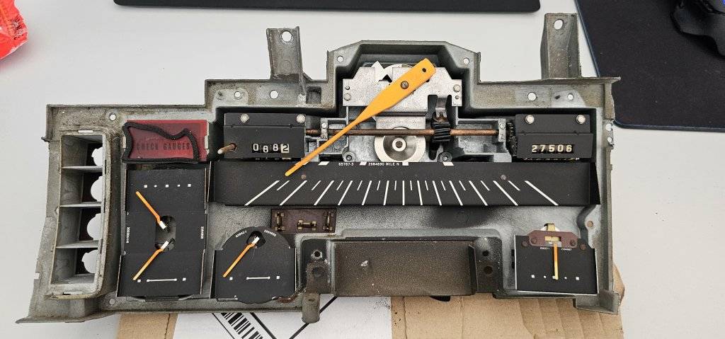

Next project I'm working on, is the instrument cluster. I just recently learned, that there was a mid year change on the '69 model year where Chrysler switched from the wood grain cluster to the black one. I always thought they did that for the '70 model year.
With the black cluster, they also switched from the self glowing, molded letters to solid, raised, white painted letters on the plastic cover. Since I prefer the later ones, I bought a complete cluster to get a black Speedometer and I also bought all the other gauges NOS.
So, now I can start and rebuild the instrument cluster. Unfortunately, the plastic cover I bought is in pretty rough shape...
If someone happens to have a very nice, black cluster face cover, I'm highly interested!

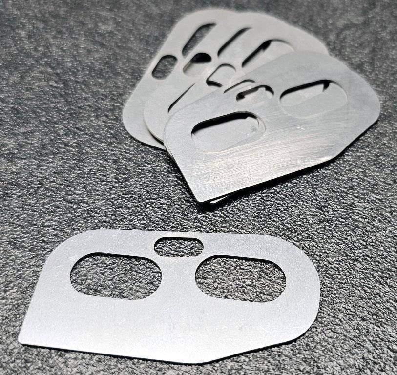

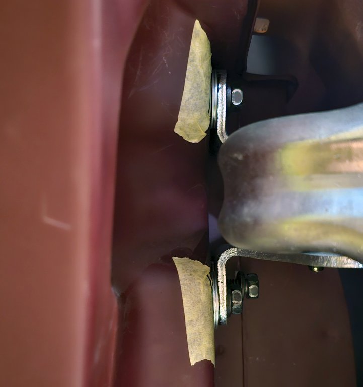

But next to these big projects, I also have to solve small problems. Like Door Hinge Shims for example.
To get the new passenger door to fit perfectly, I had to add 1,5 mm (0,06") shims between the body and the inner hinge half.
My body man used washers to align the door and it worked fine, but I didn't like how that looked, so I designed my own shims and had the laser cut from stainless steel.
If someone needs a set, let me know. ;)

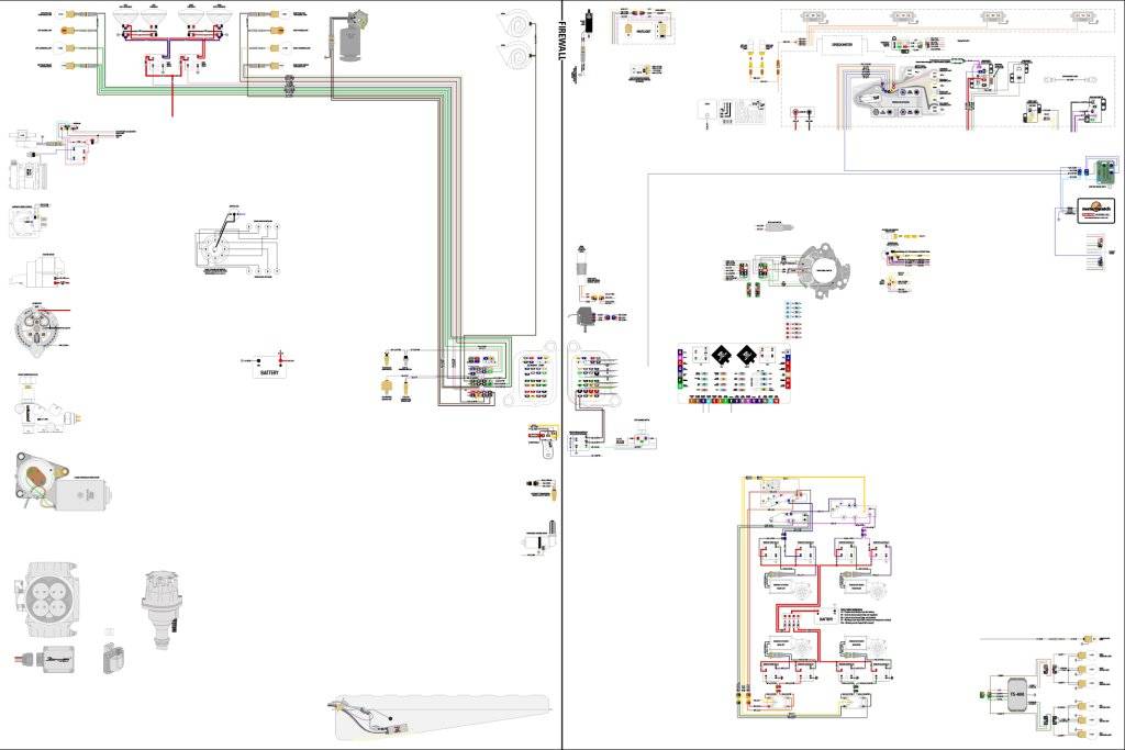

This brings me to what feels like my biggest project at the moment. Making a new wiring harness from scratch.
And before I can even start laying out some new wires, I have to make a new wiring diagram from scratch as well.
Wiring is not my strong point, so I have a lot of trouble doing that. It's soo confusing sometimes.
Sneak peak:
There is still soooo much to do on that.. :rolleyes:

I'm more of a visual guy. My head is spinning pretty often while drawing the wiring diagram. A lot of things simply doesn't make sense to me ;)
But as usual, I biting into it and get it done. But it's a major undertaking for me.

The trunk is only painted? It looks great, I can't imagine that it would look any better after being wet sanded and polished
Correct, the whole car looks like this. The painter did a really good job! But as soon as I have all the parts, I will wet sand und polish everything for sure! And then probably ceramic coat it. At least that's the plan for now.
