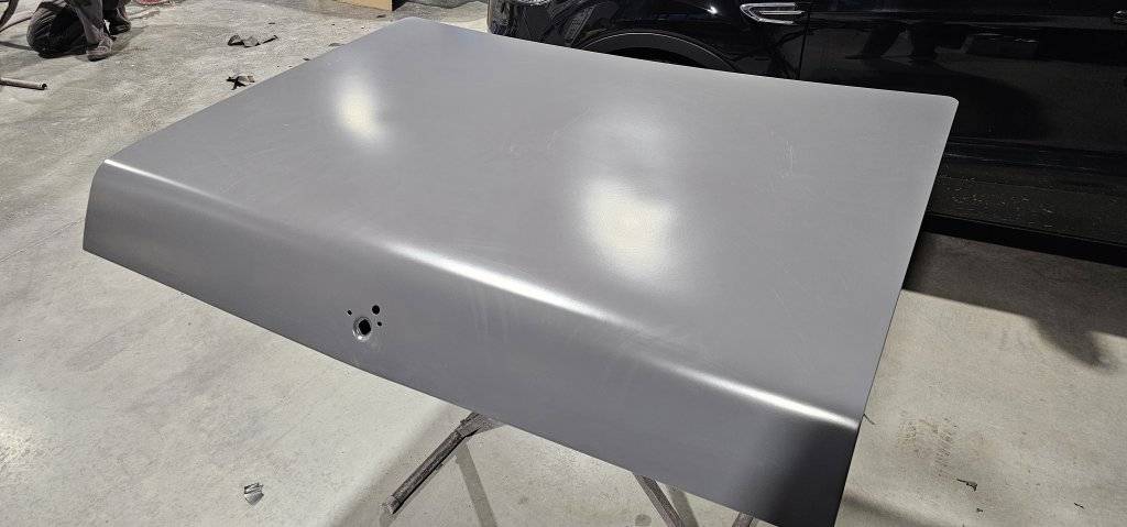

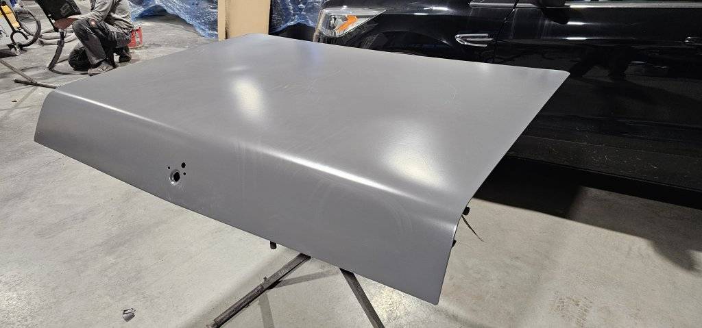

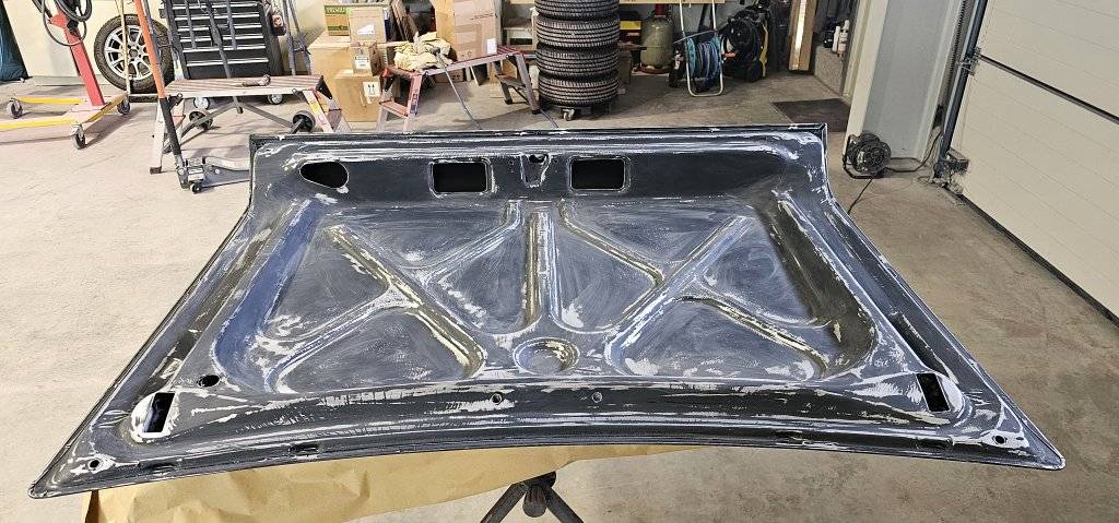

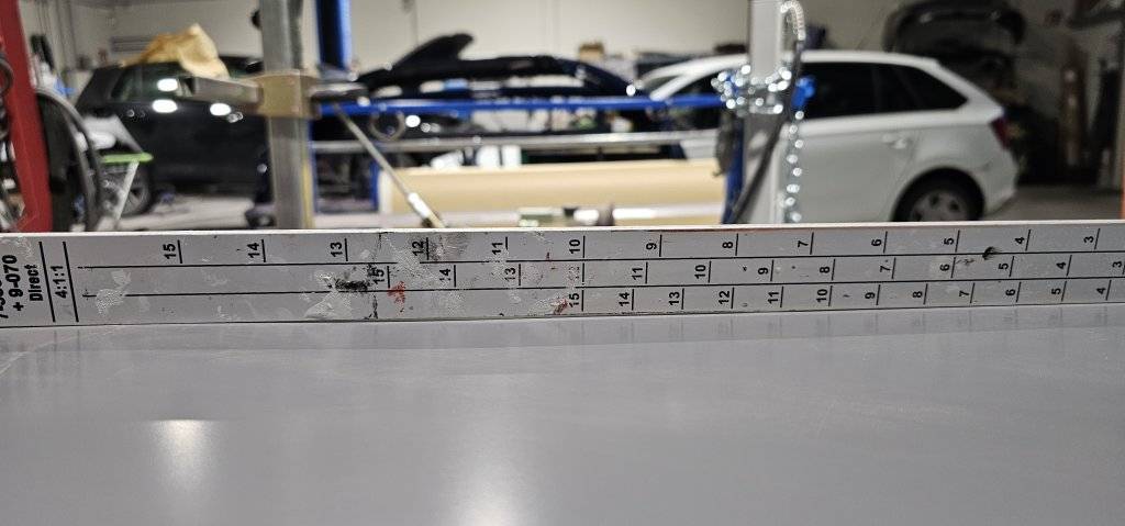

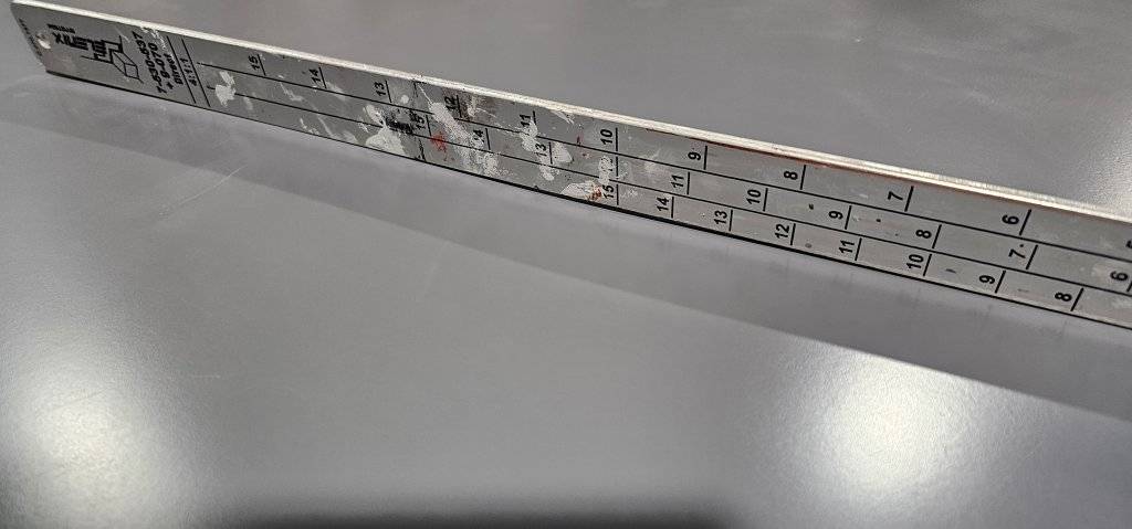

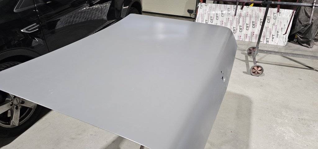

I seam sealed the entire car, but you can't reach inside the trunk lid with normal seam sealer.
According to the manufacturer, this foam is designed for this application and doesn't have any strength to push metal apart.
I drilled holes on the bottom of the lid to insert the foam application hose and filled the support ribs with foam. And exactly along these ribs on the bottom is the metal lower now...
My bet is that the foam got hot and expanded as it catalyzed, stuck to the sheet metal, then shrunk as it cooled.
I can't help but wonder if it's supposed to be used in enclosed areas... Or in areas that have to be straight. You have more sheet metal in that deck lid than any new car... and the sheet metal is flat with no curve to strengthen it.... It's also softer and thicker than new cars. In other words, this might have worked great on a floor panel in a new Toyota, but not that football field size deck lid.

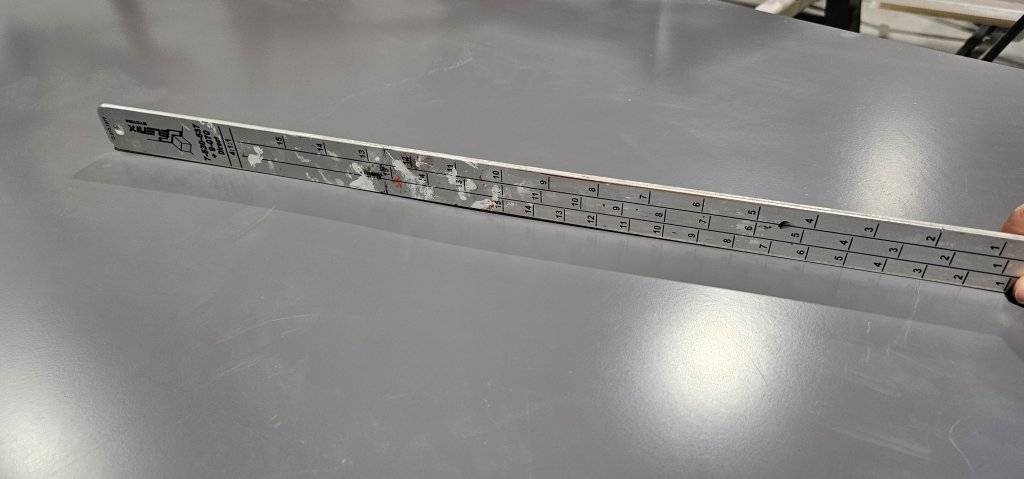

Did you check with a straight edge prior to application? Maybe the panel was that way originally? Maybe it needs a couple of hot/cold cycles to even out. I am not sure how far I would go to remedy that. Unless the German inspection requires panel checks with a straight edge to pass. : )

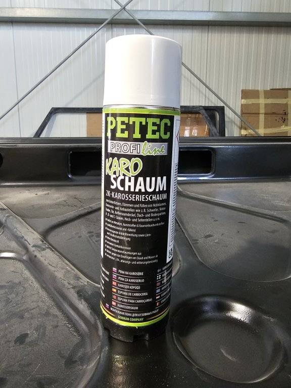

Well, **** just hit the fan...... I had to do something about the rattling and wobbling of the outer skin on the Hood and Trunk Lid. The original sealer had been washed out in the rust and paint removal bath.
After finding a product that sounded just like what I needed, I contacted the manufacturer and asked them if it's the right stuff for my particular case and they said yes, their product is made exactly for this application.
Well, I guess not, since it somehow shrunk and pulled the sheet metal down with it where the structulal braces are on the inside................... . . . . . . .
After mixing the two components and shaking the can, it got pretty warm, so that would be a possibility.
The can reads:
PETEC Karo-Foam is a two-component bodywork foam for professional accident repair, repair and restoration of body parts. Karo foam adheres to metal surfaces, wood ...
Bodywork and add-on parts such as sills, hoods, doors, A, B and C pillars, trunk lids, roof and floor sections as well as rear and side panels can be filled, padded and thus protected against vibrations and contact corrosion. The foam is also ideal for eliminating and damping sound, noise and noises in cavities and on the bodywork.
That's exactly what I wanted. And I still talked to a process engineer and he ensured me that it's good for my application. Unfortunately, that was everything I could do and still something obviously went wrong.
Now I have to deal with it by using bondo to correct it. And I hate doing that because there is no body filler on the car at all so far.

Yes, my body man repaired and straighten the trunk lid. It was fine before using the foam.

My painter will do its best to correct it and probably use bondo to straighten it. :/

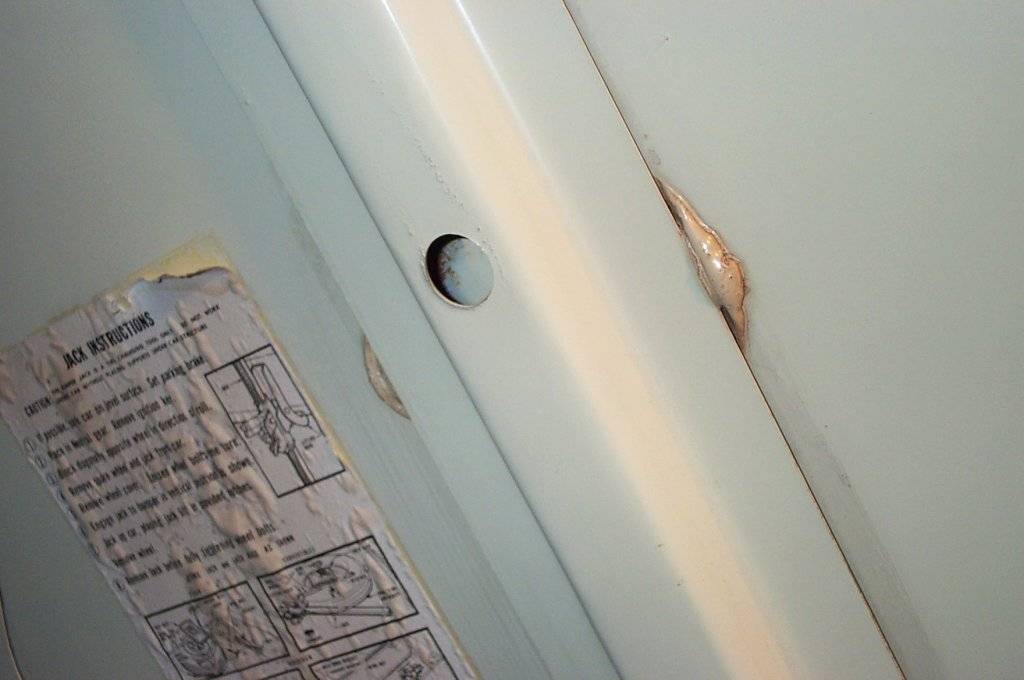

Isn't there some space between the sandwich of the inner frame & outer sheet metal? That's the way all my cars are built. Depending on how much space there is & how hard the material, you may be able to just physically cut & release. On one of my cars, a previous owner removed the original caulk material on the hood which caused it to flutter at speed. I bought some 3M stuff & injected it in the spaces where the original material was. While it doesn't look like the original, it solved the problem & did not expand or contract which 3M claimed in their specs.

This is the way Mother did it. Globs of dum-dum putty like stuff.
There is no way of redoing it this way on a 69 as the inside panel has no openings/cutouts, it is a FULL panel.
