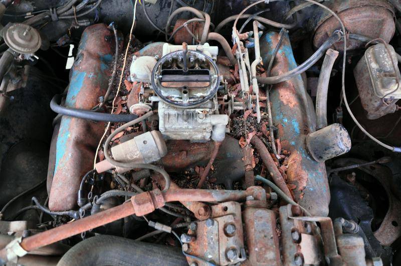

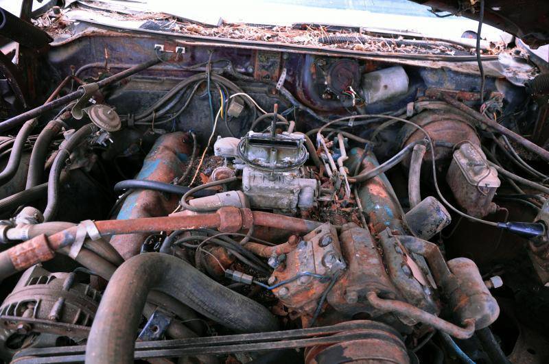

I started cleaning out the engine bay... Five full vacuum cleaner bag with dead rodents, nest building stuff, nuts, seeds etc etc etc. And there is much more...
Unbelievable how much stuff these ******* animals can collect in 30+ years of storage...

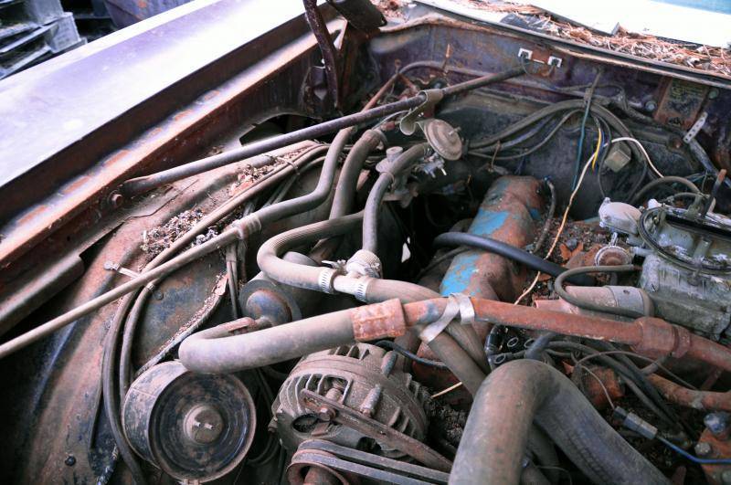

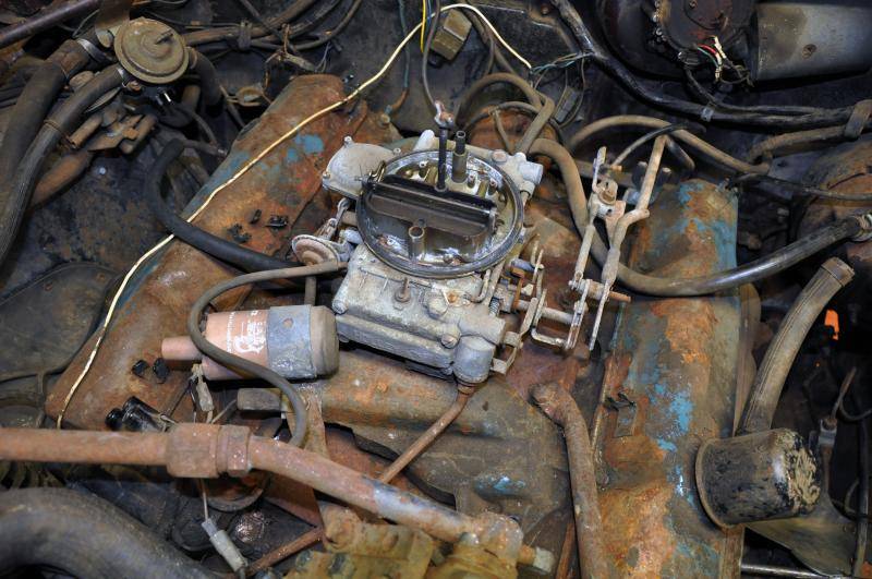

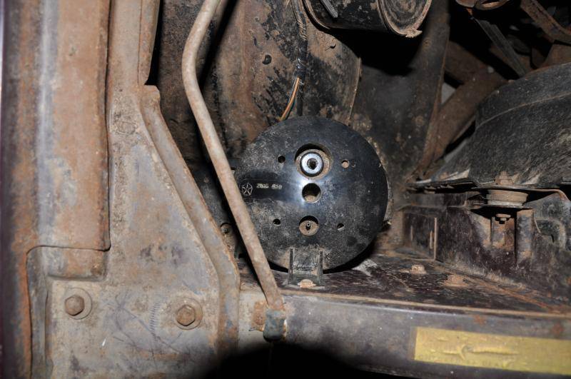

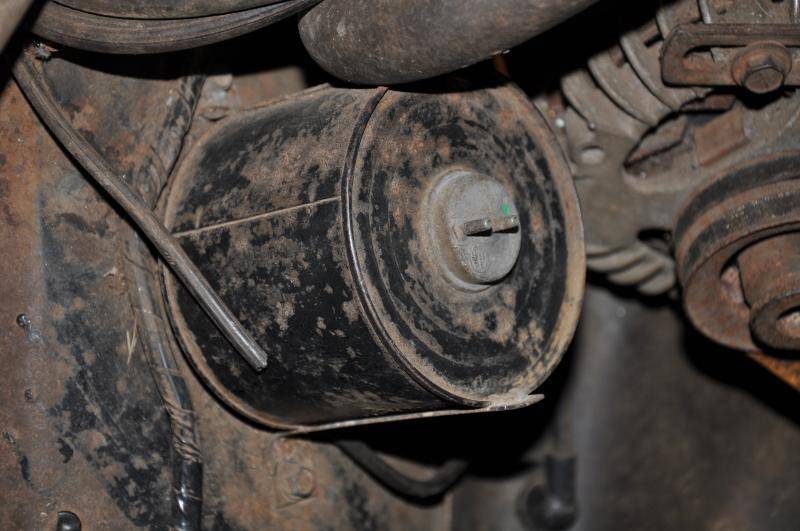

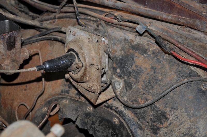

can anyone please name these parts?!
(1)
(2) there are two of these things, one above the other.

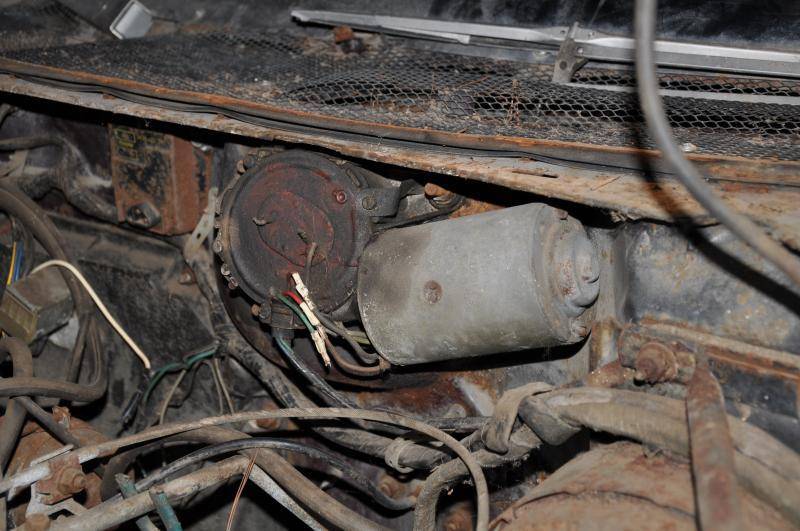

(3) wiper motor, right?
(4) cruise control?
Look like vacuum canisters to me. Were there any hoses attached? If so, did they go to the heater core? I think the Auto Temp ran on vacuum, so there were multiple reservoirs to provide power.
There are a lot of rubber tubes and lines. Not they were ALL disassembled when I got the car Oo
I will make photos of all lines I could find tomorrow.
View attachment 27814View attachment 27815View attachment 27816View attachment 27817
View attachment 27818View attachment 27819View attachment 27820View attachment 27821
Yeeesh, that is dirty. It's gonna look so nice when you clean it up.
Number 1 is the vacuum reservoir for the power trunk, number 2 are vacuum
reservoir`s for the auto-temp,one is for control vacuum and one is for the slave circut. You are correct on 3 and 4
