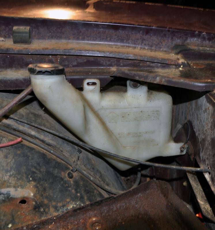

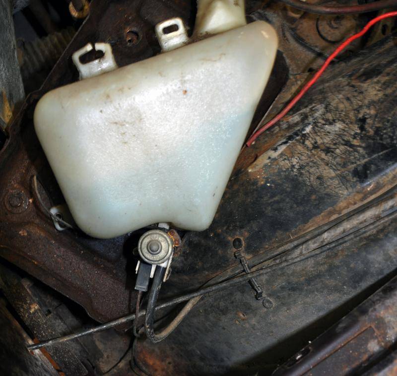

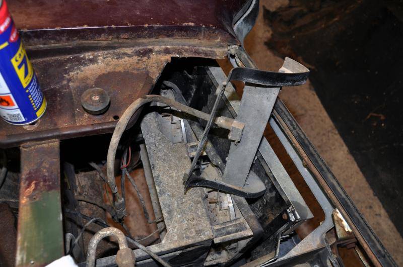

I was happy to find my washer tank unharmed after all the stories about troubles with finding new ones... But after I took it out, I saw it's not good anymore... I barely touched it and it got a lot of hair cracks :(
Are there ways to protect and "renew" old plastic?
