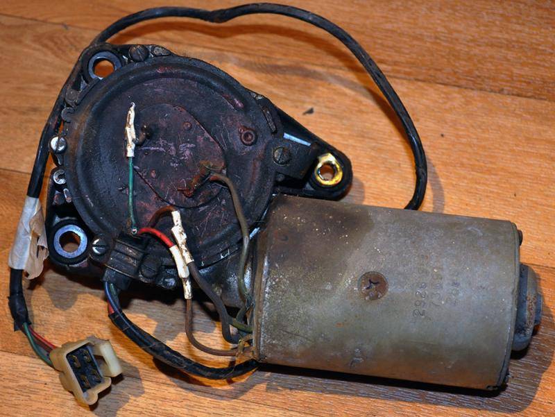

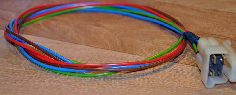

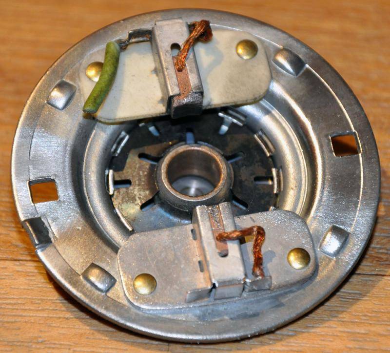

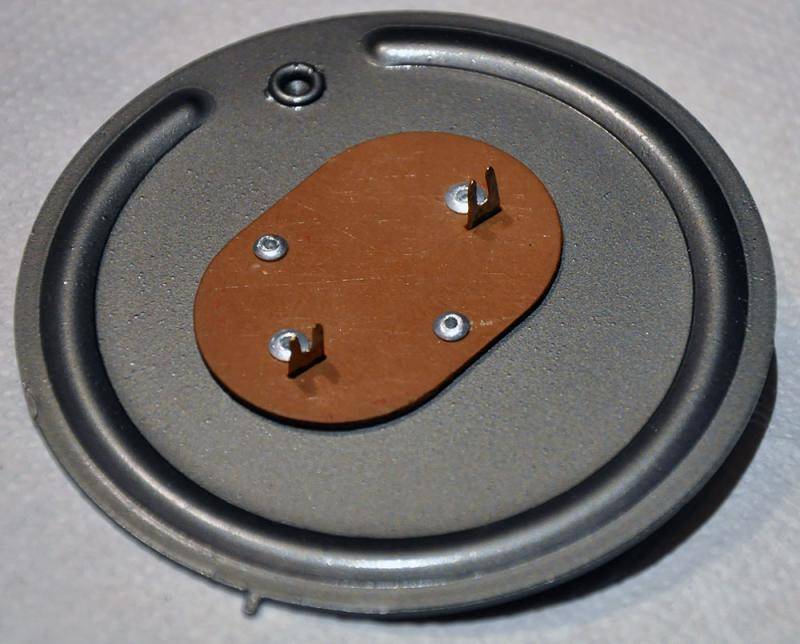

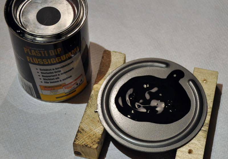

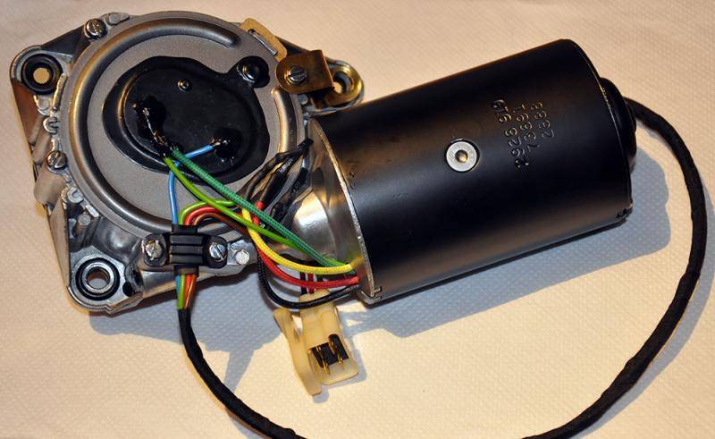

Windshield Wiper Motor: Done

And hey, I dipped the first part of my car ;)

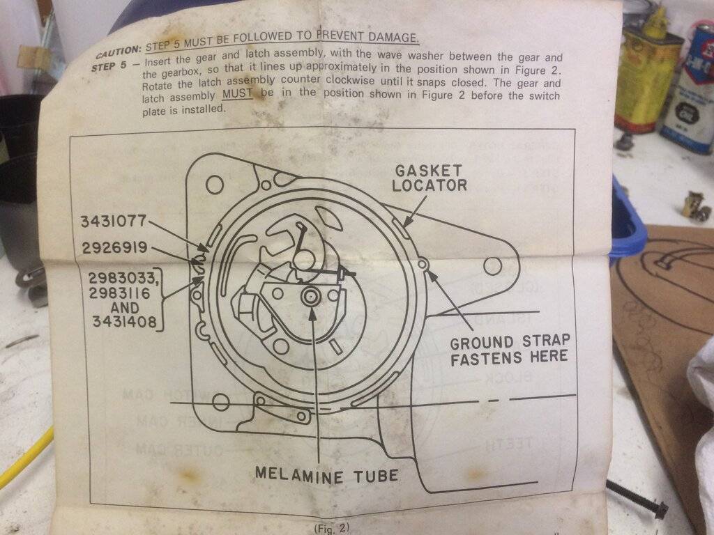

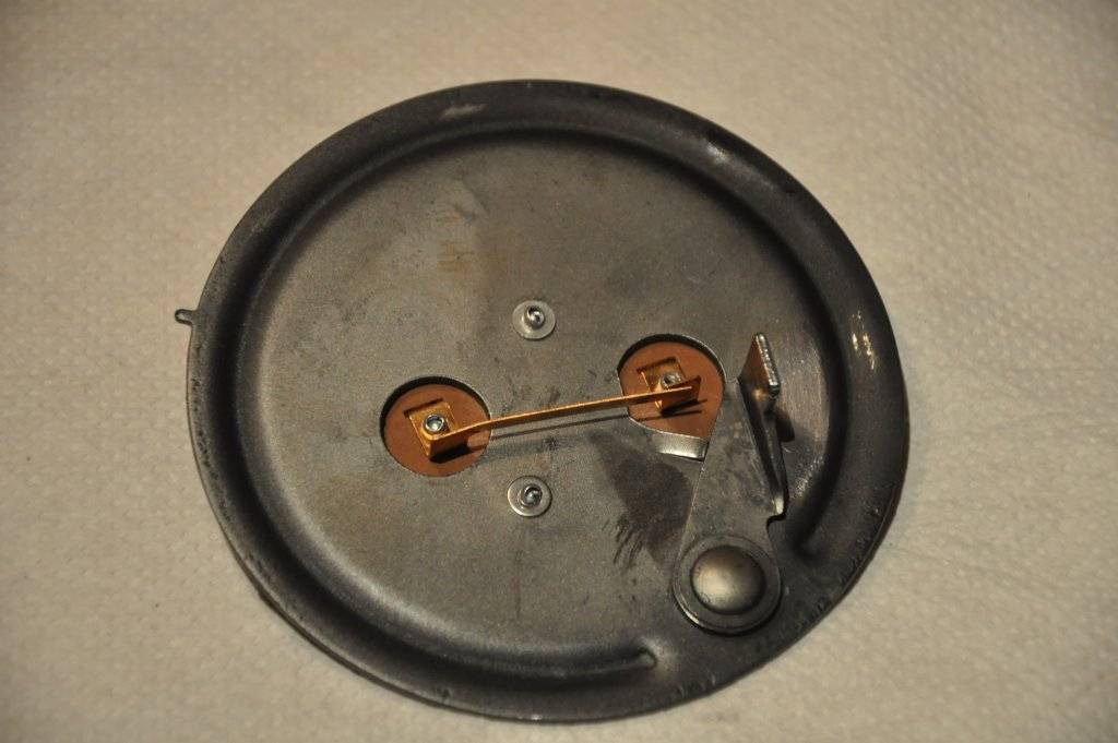

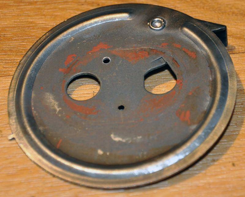

Are the contacts on the switch plate normally closed or open? I repaired all the wiring in mine but I have only one speed and no park. The contact arm was bent. I straightened it but don't know if it should be closed or open before putting it back together again

Boy, that was 10 years ago ;) Please check the FSM, that has a lot of good information on setting the switch plate up correctly!Are the contacts in the switch plate normally clos
Nothing in the 69 FSM but thanksBoy, that was 10 years ago ;) Please check the FSM, that has a lot of good information on setting the switch plate up correctly!
But "I think" they are normally close, yes.
Ah, mentally I was in the headlight door motor, right..!Nothing in the 69 FSM but thanks
Yes. Thanks. Something still not right. Appears I have no cam to move it. I took it loose and ran the motor and manually connecting the points did nothing either even when the switch was turned off. I tested the switch and it's perfect according to FSM but I still have 1 speed and no park. I'm going too order a rebuild kit and try that. I think the gear is the problem.Ah, mentally I was in the headlight door motor, right..!
The switch in the lid of the windshield wiper motor is riveted in place and not adjustable (or not able to get assembled wrong in this case).
If I remember correctly, it is normally closed and pushed open by the cam of the big main gear to stop the motor and then the cam moves the motor into the park position. I discussed that a while ago with @ceebuddy. Maybe he can confirm that.
Also, included in the repair kits Chrysler sold was a bit more information on how to set up the cam in different applications. Maybe that helps with your question?!
