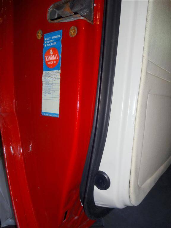

And why is the inside door skin white?

The white on the door frame is a filler so the body color dosen't show when the door is closed.
White interior had the inner door painted white. I had the same on my 69.
So this is a white interior only thing?
