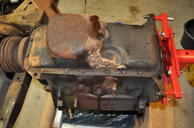

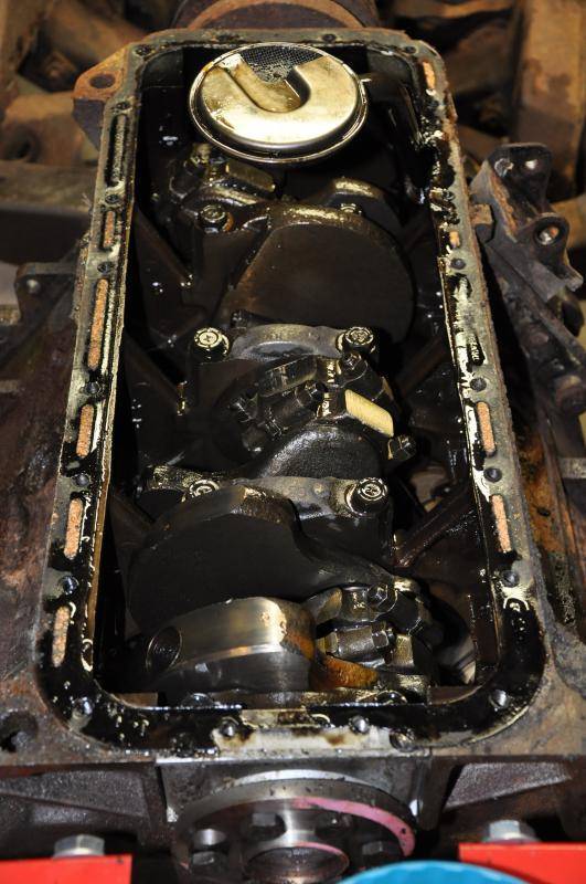

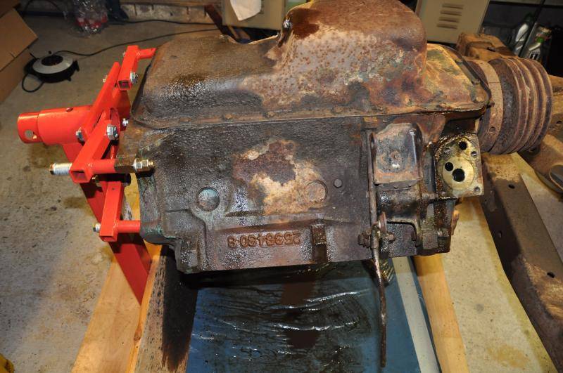

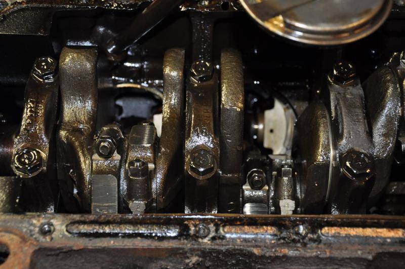

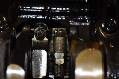

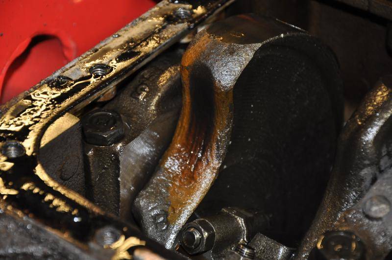

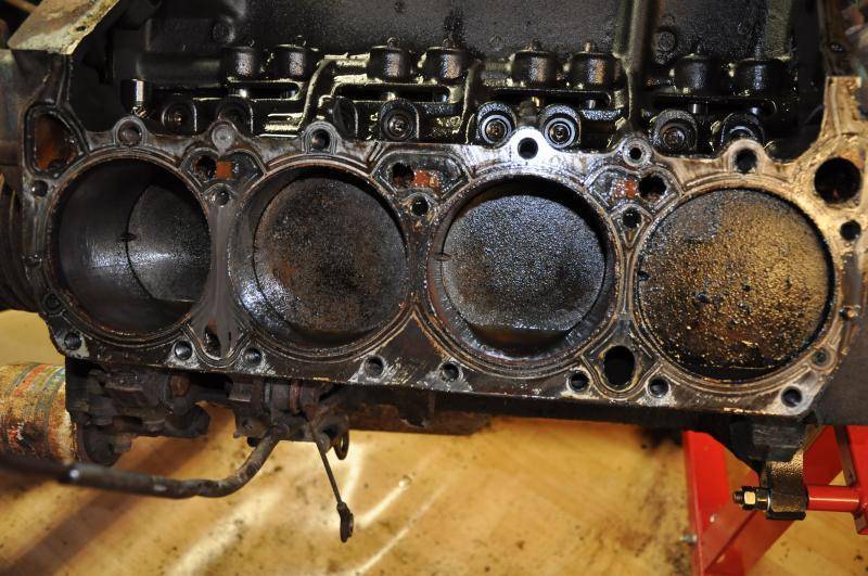

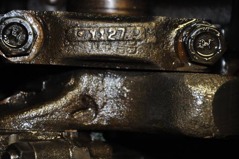

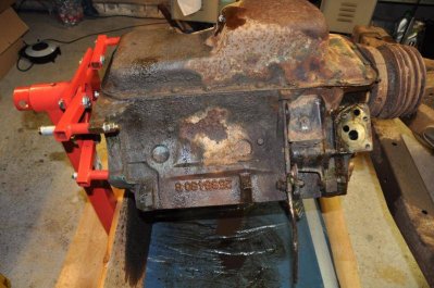

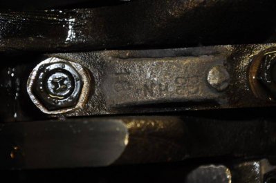

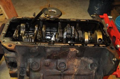

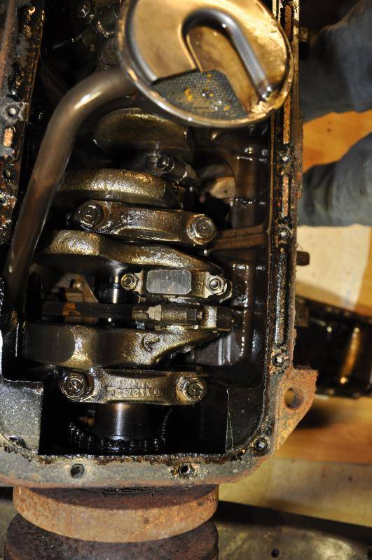

I had not much time this week for Jacky but tonight I took a couple hours to inspect the engine a little more.
No surprises on the bottom side, i think. Just one small "rust trickle" on the crankshaft.
Rest looks good.
