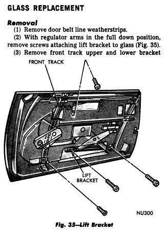

On a '67, you need to remove the motor assembly. Just be very careful to make sure and keep the spring captive, so it doesn't injure you.
Yes remove motor, do something to hold window up before your unbolt it as the large geared arm will cut your fingers off or open your palm like a soup can depending on where your hands are and how fast the glass falls, be careful.
wow, that sounds dangerous Oo
I like my fingers... I will do that today I hope. If I still have finders tonight ,I will report ;)
If you don't, use your nose to type out a post. But report either way.
I have some info on removing window motors in my threads. I think I put the process in my Imperial thread, and there was some discussion of it in a separate thread on window motors. I'm sure if you do a search on threads I've started, you can find it.
Also, there is quite a bit of discussion in the archives over at the Imperial club about window motors. A good resource.
My windows were glued in the up position with all the gunk.
Use caution as I don’t know that setup, may be best if you lay the door on the floor, take gravity out of the equation.
Alan
I remember the discussion about the windows on your Imperial, Joaquin! I will read it again and see if I can use this informations to not cut off my fingers ;)
I wanted to remove the window before I unscrew the door, but I agree that it's maybe a better idea to lay it down in order to remove the glass.
