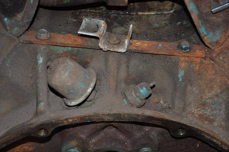

So is there something special about that socket other than the size? If I have a 1-1/16" socket will it work, or do you need that special tool?
I have an impact socket that would fit by size, but apart from the not fitting length, it won't fit somehow. It's another shape as you can see on the ebay picture. (if this is the right socket!?!)
I think it looks a little like the ball joint socket?!
A 6pt 1 1/16 wont work on the oil sender, a 12pt 1 1/16 socket may work has to be deep well, or get the oil sender socket you had pictured. yes that is the right socket and it is special

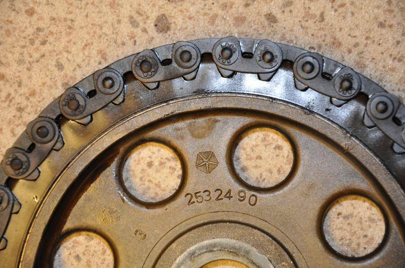

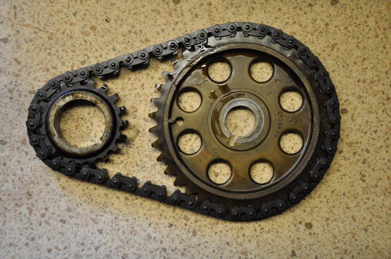

Oh these avatars I can't concentrate. Your bearings are 10 68 oct , 1968 standard clevite 77 bearings the timing chain looks very good for that crappy nylon covered gear its a shame it sat looks like it was well cared for.
