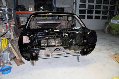

It was a busy "vacation" week but it was necessary to protect the carcase from rusting over the winter time, when I can't work on it because its to cold in my "shop".
After reading a lot about wash primers, I found a great product that solved two purposes. But let me start at the beginning.

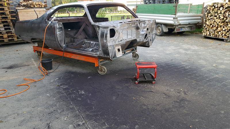

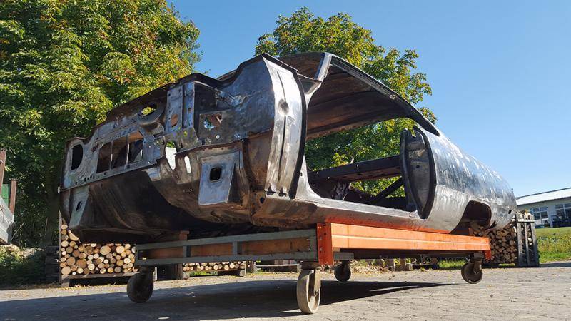

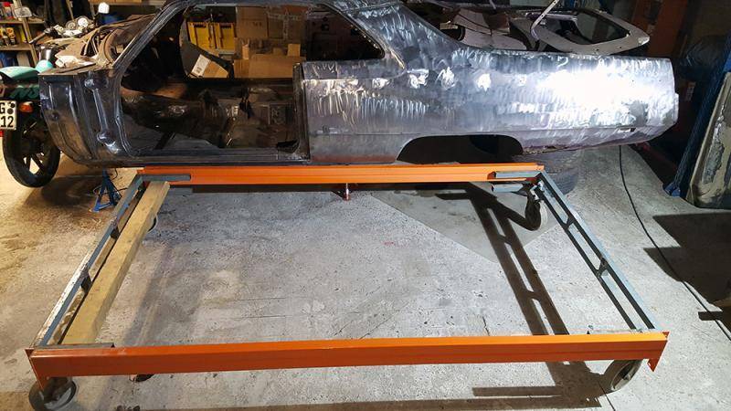

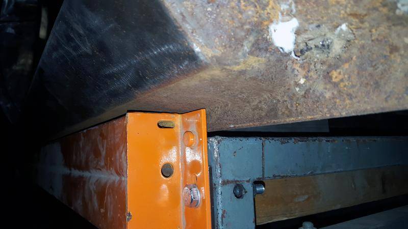

First step was to get the carcase rolling to get it out of my shop. And because special rolling boards are crazy expensive, I made my own from a scrap dolly and some heavy duty shelf posts.
It's a very tight fit, but it works flawless!!

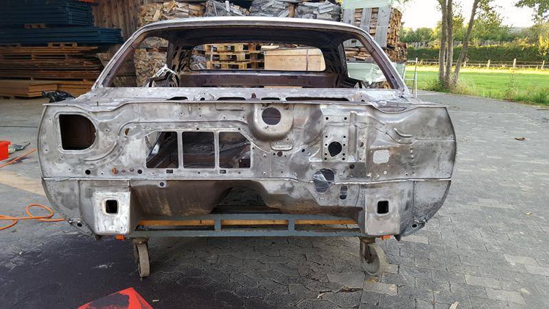

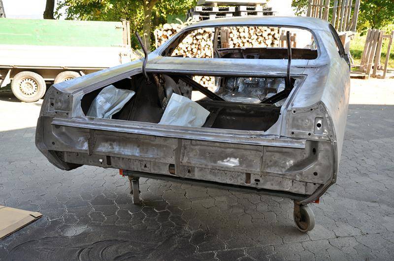

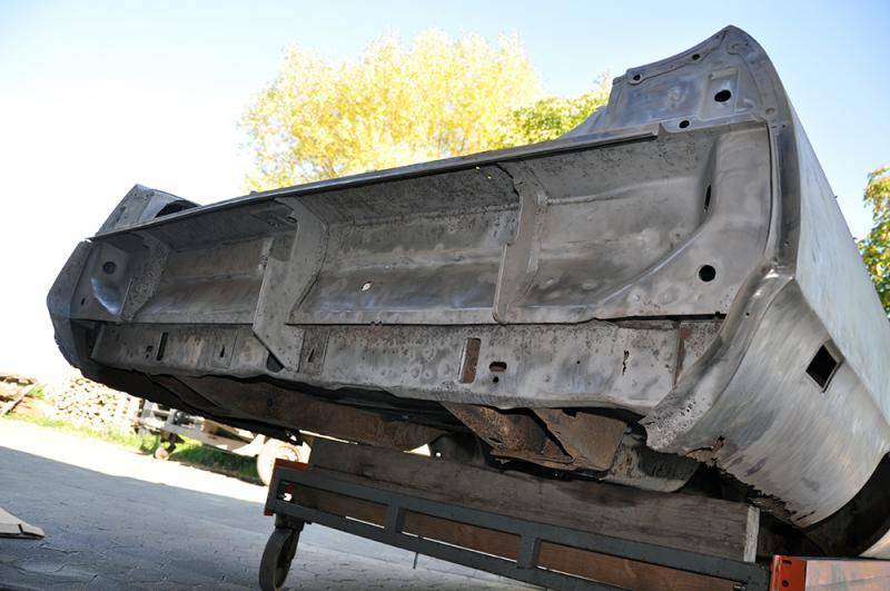

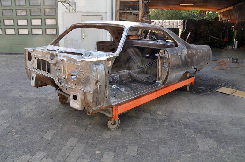

After that was done, I started to media blast the whole body (outer skin) on every spot I couldn't reach with the angle grinder.
I can tell you, that was a PITA! Especially the undersides of the panels on the rear..!

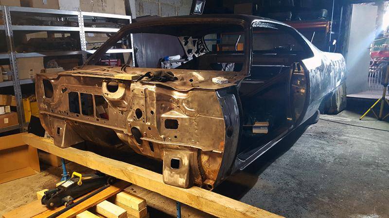

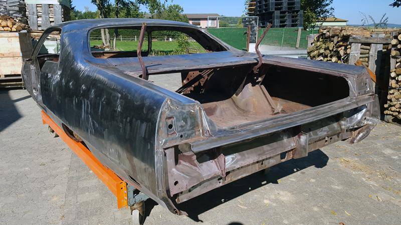

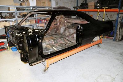

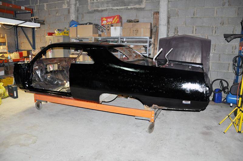

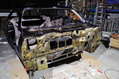

Finally, after 4 Days of blasting the hell out of the car, it was ready for the rust converter treatment. I used FERTAN, a really great product. It's a rust converter and wash primer. It creates a overpaintable protective layer of zinc oxide. I will apply epoxy primer directly on this coating next year after welding all the rosty panels I found.
It was a busy week, but now winter can come..! I'm really happy with my progress.

Correct, Matt. I will finish grinding the floorpans and treat them with BRUNOX, a european equivalent to POR15, this year because of rust protection. But when it's to cold to keep on working on the shell, I'm going to continue working on the carriable parts in my living room!
You can't fool me. . . You are using your bed frame. . . Aren't you ?!?
:laughing4: I would have, but my bed frame is wrapped in leather. Not good for that purpose ;)
I swear they're posts of the shelfs in my shop!

BTW, bed frame is a great and cheap source of material for stuff like that... I've used it many times. You just have to realize it's brittle in comparison to cold rolled angle iron especially after welding.

I made my dolly for the cost of 8 bolts. That's nearly unbeatable. Normally the casters are $250 easy to carry this weight!
