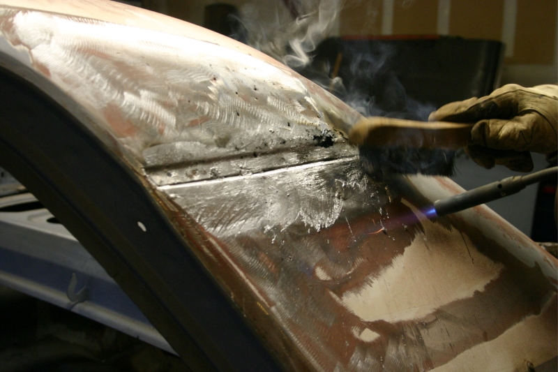

What's the best way to remove this leed stuff??? Is it the best way to use a torch? Is a propane torch good enough for this, because I don't have another one...

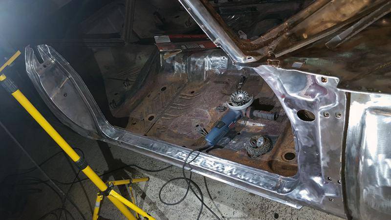

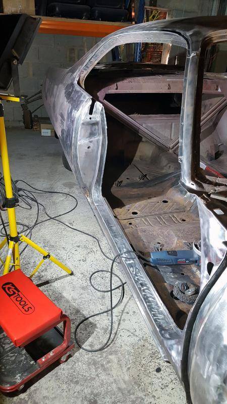

...still grinding ........ ........ ........ ........
All these small, tight places are not fun to grind... But the outside of the car is now completely stripped. (I just have the sandblast the small spots I can't reach with the grinder.)

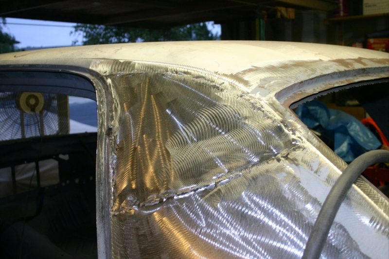

The lead can be melted out with a propane torch.

Ok, I will try the propane torch then!

If you do melt that lead, ensure you have a proper mask, as the lead fumes are bad, as I'm sure you already know. It looks like it's coming right along! Ich bin in Ehrfurcht vor, was Sie erreicht haben! (I had to look up part of that!)

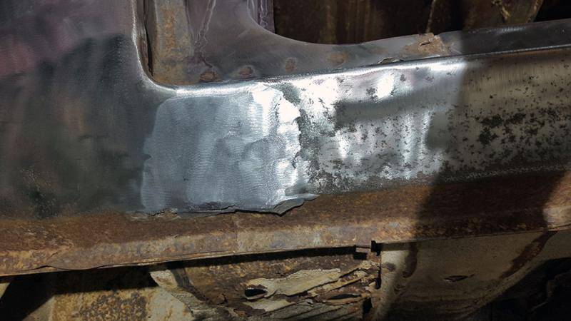

Thanks Alan. What did he use to fill the the spots afterwards? I've heard about tin metallic filler?! Is this the way to go?

Remove lead like Alan has shown, neutralize any rust in the seam with some sort of phosphoric acid then paint the seam with a decent paint not primer then use a all metal type of epoxy filler to smooth seam, plastic filler for final finish leveling. This is what I have done in the past. I am not a professional body man so don't take it as gospel.

With the amount of rust in the area around it we chose to just patch, standard body filler was used to clean it up as was it on the rockers.
Why the paint before using the filler? I've read that filler will stick best on bare metal?!
