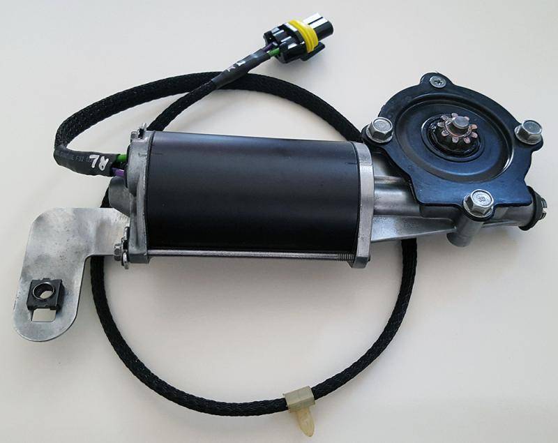

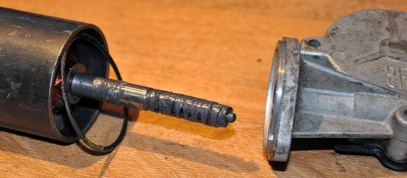

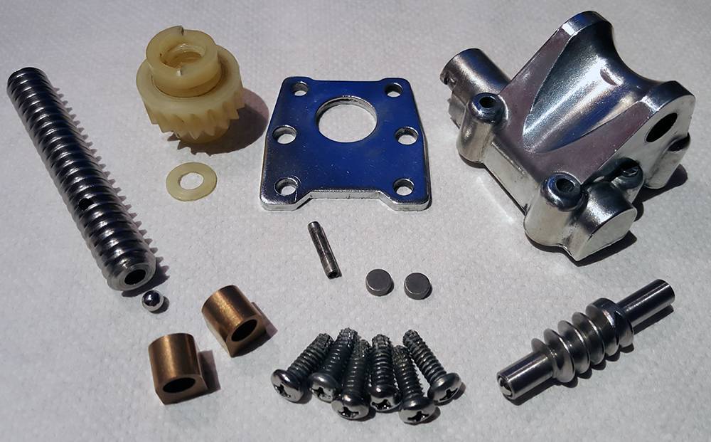

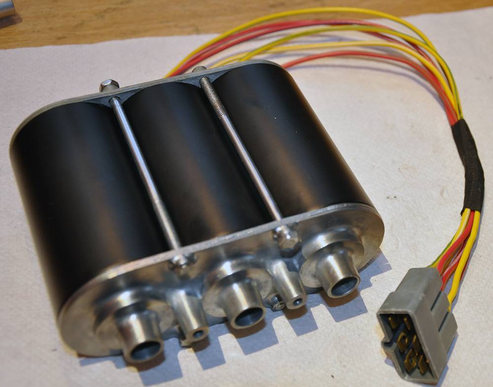

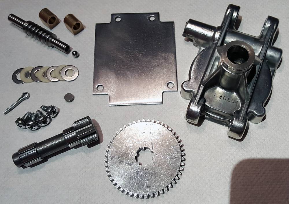

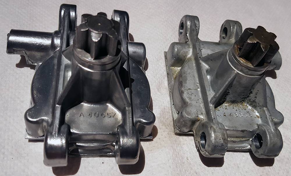

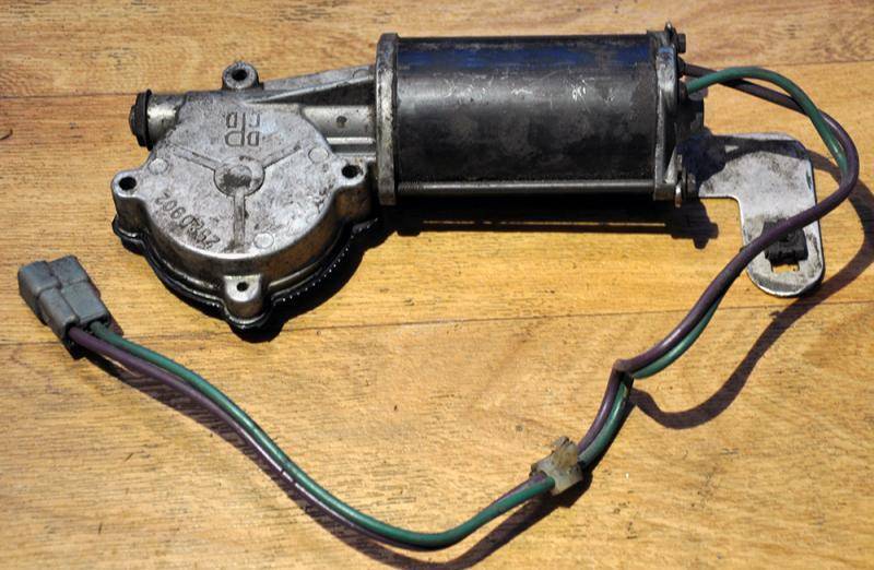

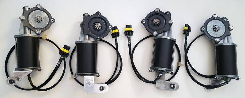

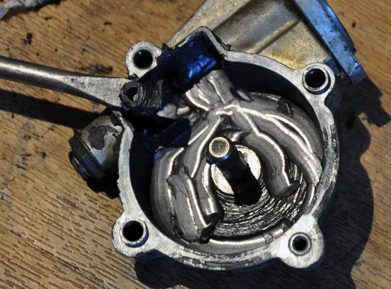

It took me a while because I had a few problems to sonve, but finally all 4 window lift motors are done.

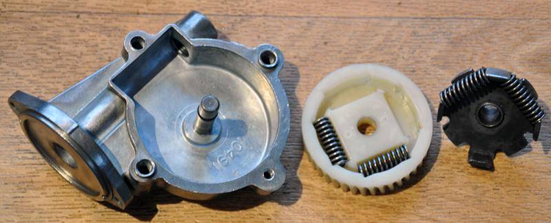

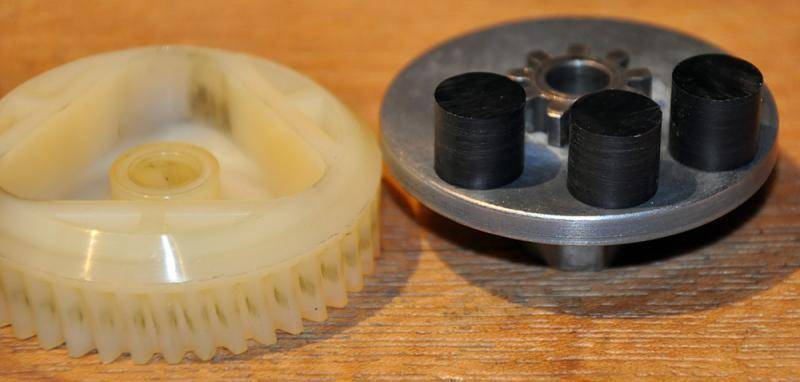

First, here is a stock configuration. Good to see what the base problem is on this motors.

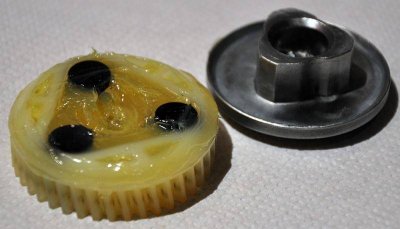

I used POM-C, which is a special thermoplast used on heavy duty industrial rollers, gears or guides etc.
I bought a 12mm stick of it on Ebay for under 2 bucks. The bummer was, that it actually was 12,6mm and would not fit. So I mounted it to my column drill and sanded it down to 12mm (+- 0.2mm). Voila, perfect fit.
Nice, durable and easy solution to fix the broken Puks in the Front Window Lift Motors.

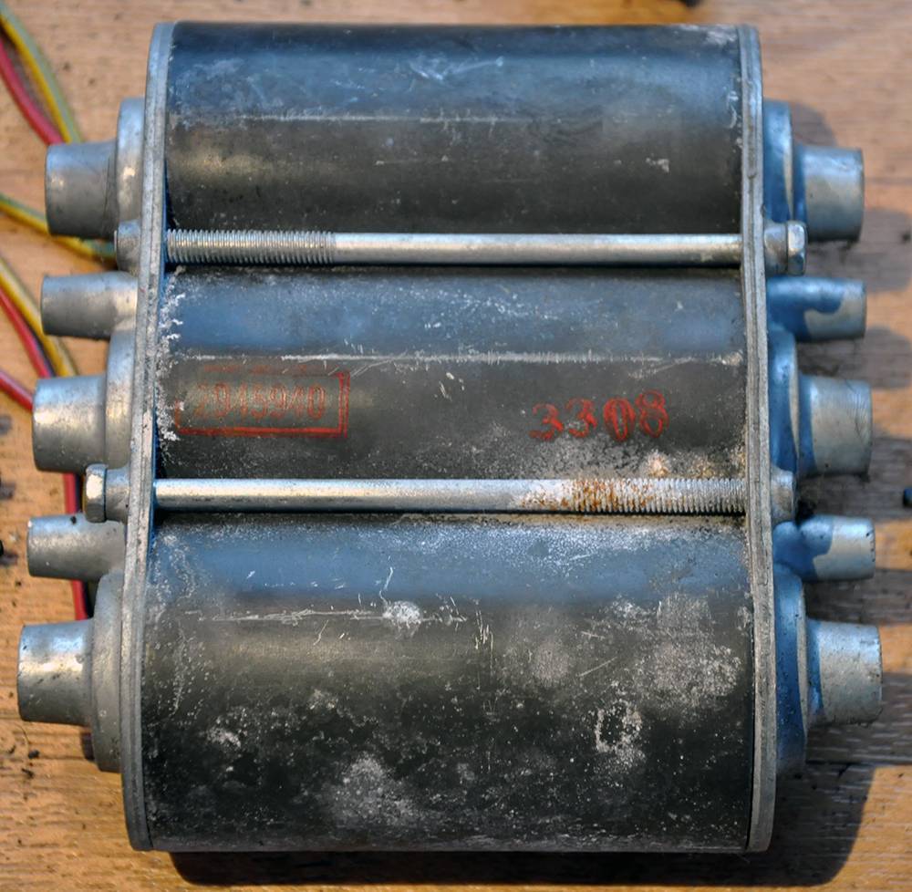

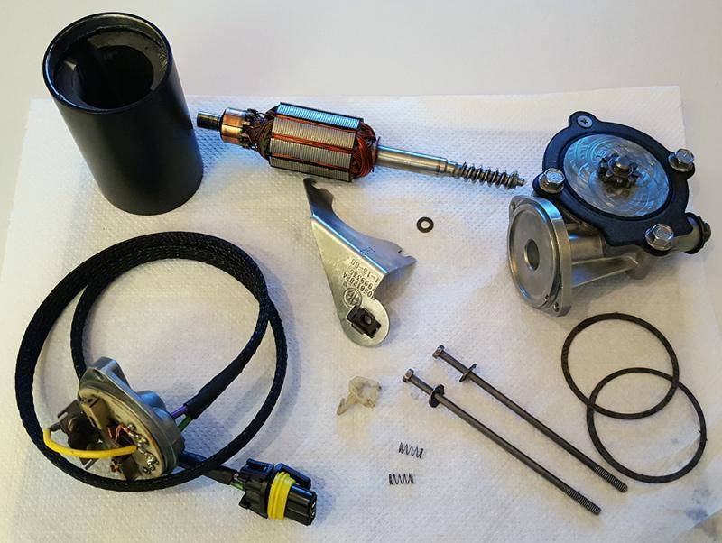

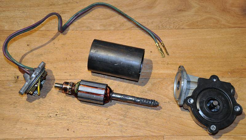

The two quarter window motors had different drives. So this part was easy.

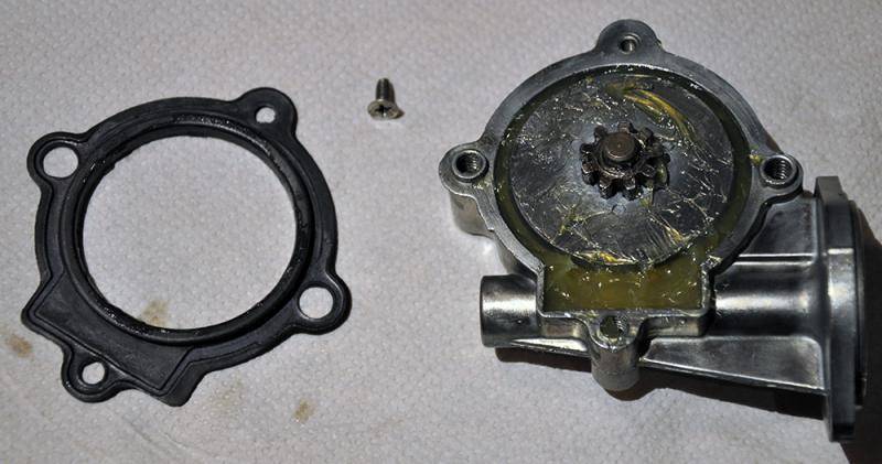

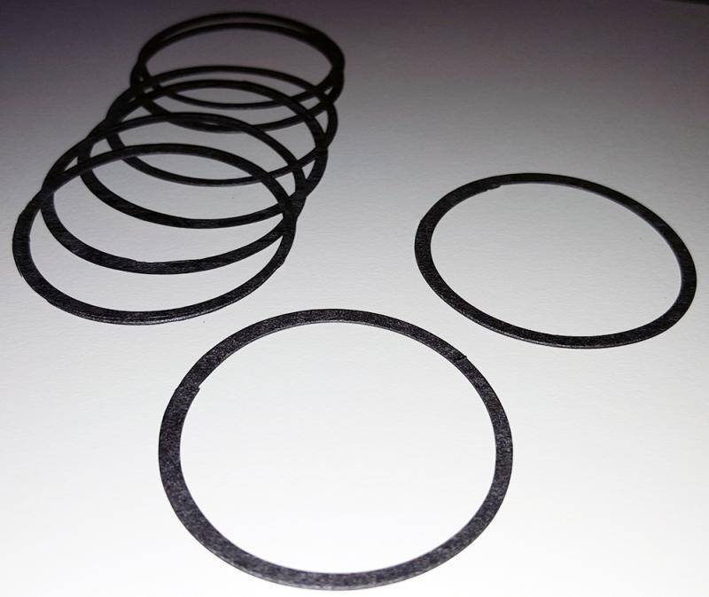

Of course, I had to make my own gaskets again, but these were simle to make with a circle cutting tool.

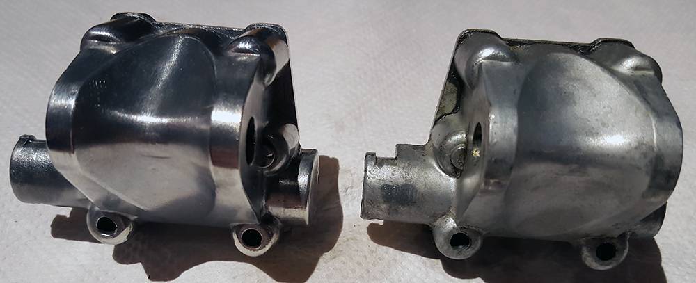

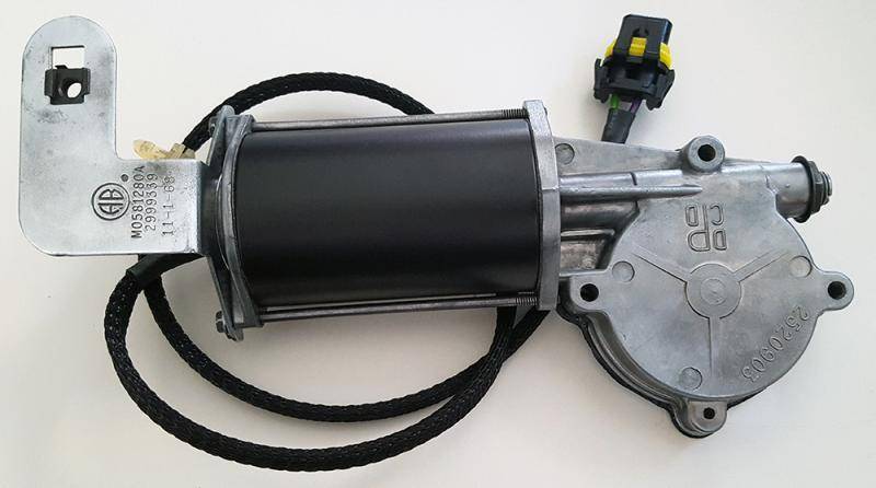

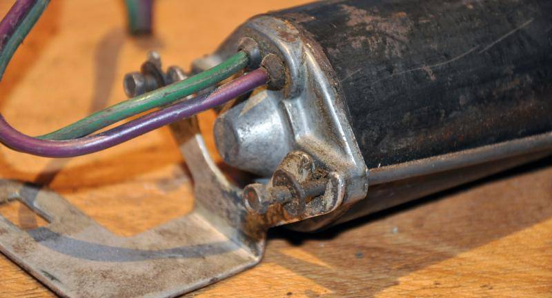

The rest was just cleaning, polishing, a little bit paint for the housings and a lot of grease removal.

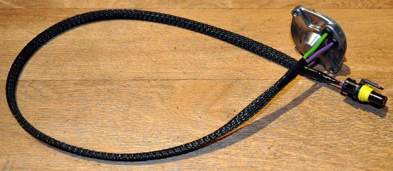

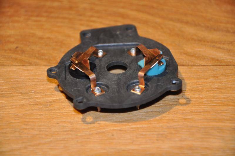

I soldered in new cables, added the superseal connectors and used braided sleeving to protect the wires against sharp edges in the doors.
Great job on the window motors! I think it's time for me to tackle mine too.

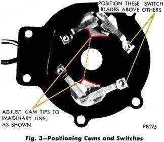

To step back a few pages.... I discovered that the 73 Dodge body FSM has more info on the headlight door motors and the cam switches then the earlier manuals. http://www.mymopar.com/index.php?pid=109
Thanks guys, I love all the small details and improvements I do on my restauration.
Next big things to do are the dashboard, HVAC box and the wiring harness.
Interesting, I will download it and take a look!
Now, that's exactly what I expected to find in my FSM!
Thankfully, I figured it out correctly by myself.

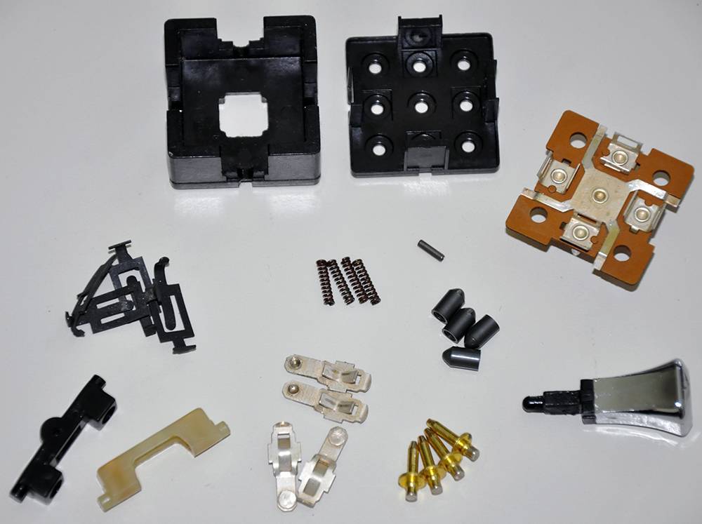

Things are going slow this winter because of my new Job and the lag of time... There are not many things I can do at home this winter, because most things require media blasting and/or paint, but I did a lot of small parts during winter. I haven't post updates yet, because its just small parts of bigger, not finished things.

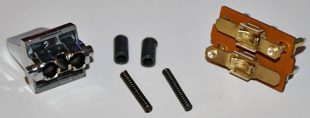

I did a lot of switches and dash parts, parts of the seatrails and other interior pieces, polished some trim and emblems. That kind of stuff.
Some small examples of seat rail parts for the picture addicted here ;)
