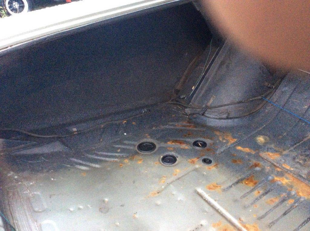

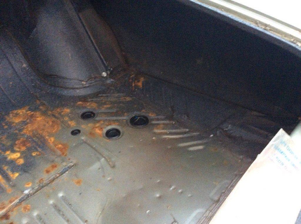

You did not miss anything. Those pictures were not there in the original eBay ad. I contacted the seller (as I like the car) and asked him for these additional pictures. He posted exactly what I had requested pretty much right away, which I take as a very good signal.

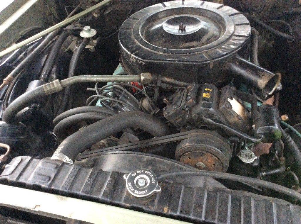

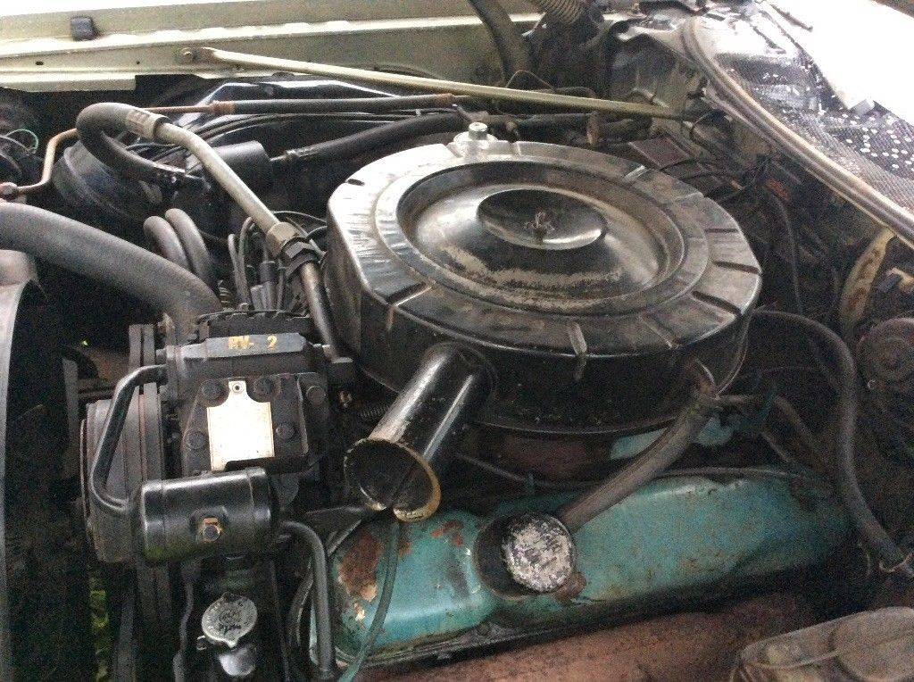

vs. Polara but whether I want to hold off for a 383-4 (or a 440) and for buckets with buddy seat.
One way to solve the engine riddle is answering the question of whether the 383-4 is more temperamental than the 383-2? I understand the latter has been called a "dog" vs. the former, but what I have in mind is ease with restarting the engine when hot, etc.
Comments/thoughts?

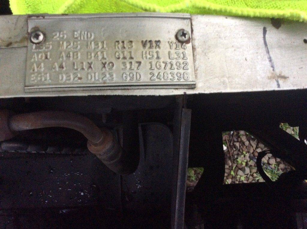

Decoding courtesy of
MyMopar.com:
D: Dodge Polara,Monaco
L: Low
23: 2 Door Hardtop
G: 383 290HP 1-2BBL 8 CYL
9: 1969
D: Belvidere, IL, USA
248398: Sequence number
E61: 383 cid 2 barrel V8 290hp
D32: Heavy Duty Automatic Transmission
A4: Silver Metallic Exterior Color
A4X9: Trim - Basic, Vinyl Split Bench Seat, Black
L1X : Unknown Int. Door Frames
317: Build Date: March 17, 1969
167192: Order number
V1X: Full Vinyl Top, Black
A48: Dress Up Package
B41: Front Disc Brakes w/Standard 10in RR Drum
G11: Tinted Glass (all)
H51: Air Conditioning with Heater
L31: Hood/Fender Mounted Turn Signals
L35: Cornering Lamps
M25: Wide sill moldings
M31: Belt Moldings
R13: Deluxe AM Radio (5 1/2 Watts)
A01: Light Package
Y14: Sold Car
25: Unknown
END: End of Sales Codes
