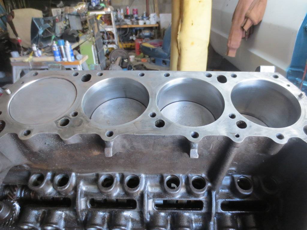

rechecked the ridges and they barellly catch a nail..thought that was a oem feature but is wear l guess..View attachment 296637
was actually looking at that tonight on the block and wondering how theyd go about it...looks pretty basic realy..pop them out one at a time through cam entrance and remove then put them back in starting at the back and working forward with some sorta hamer tool ect..more vids to track down...something like this ld be more inclined to tackle as it basicly knock them out and replace..no boreing sizeing ect needed..close?
Critter: Since you aren't doing a total engine rebuild, I wouldn't mess with the cam bearings. Cam bearings almost never wear to any significant amount. If you try to change them out, you may end up messing things up and be worse off than if you left them alone.
With all the crud in the oil and probability rust etc in the water jacket, it might make sense to pull the crank and frost plugs and then tank the block. Pulling the crank and reinstalling it will work provided every part, bearing shells, caps and bolts are reinstalled exactly as they were removed. In any case you should replace the rear main seal and the frost plugs.
I feel that once you go that far with dis-assembly, you are pretty much headed for a total rebuild: .030 over-bore, new pistons, bearings and perhaps (usually) a .010 regrind of the crank & mains. I'm just sayin. . .

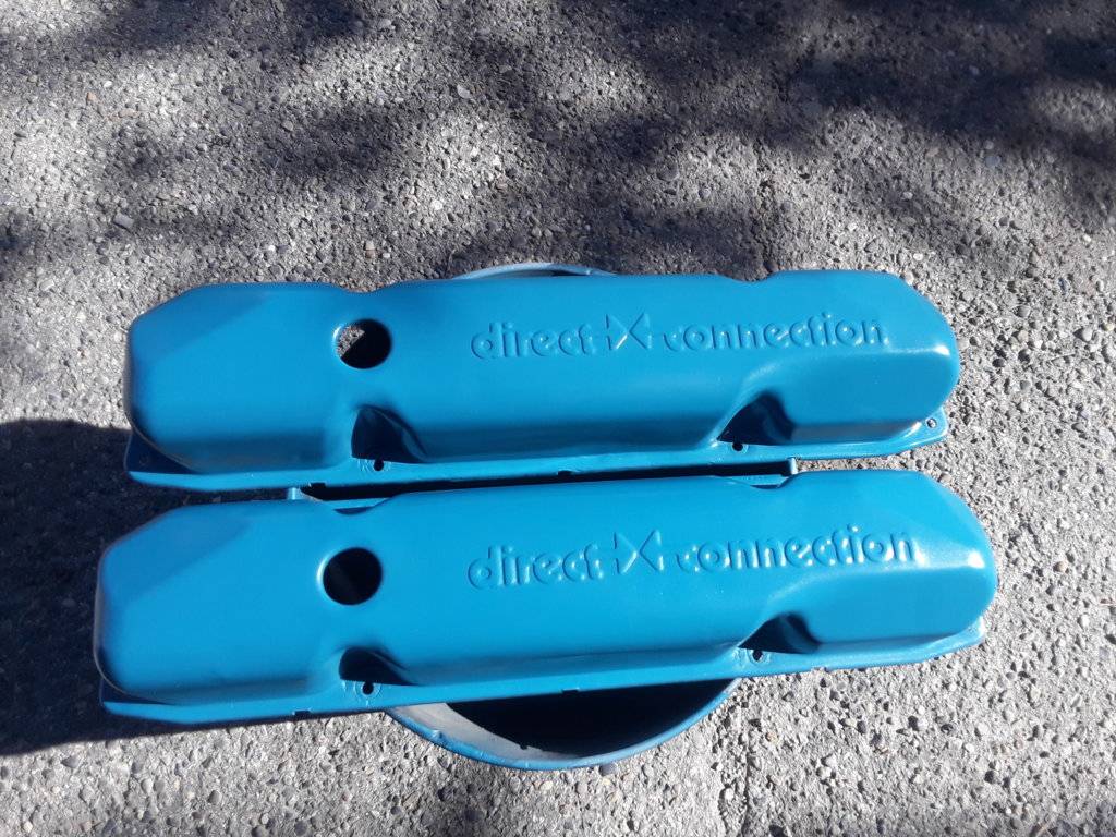

just finished cleaning up the original 906s..cleaned carbon offa valves with a little light port matching and valve laping..reusing valves and springs and locks ,but am replacing valve seals and getting ready to put them back together and have cpl questions..new to 440s
A. is good chance this engine wont be started till spring and will sit over winter
...what is usual practice when replacing valves..just oil them up and slap them in?
B. new cam...again engine will sit over winter probably...what do l use on cam...will be turning engine over with drill to ensure proper oiling through heads ect then engine will sit for 5-6 mnths before l start it to break in cam..little concerned about pushing cam break in grease out before cams broken in...looking for proper way to go about this and what l should be using re break in lube and engine sitting...just don't wana screw up anything as l only have one chance at this..thanx
