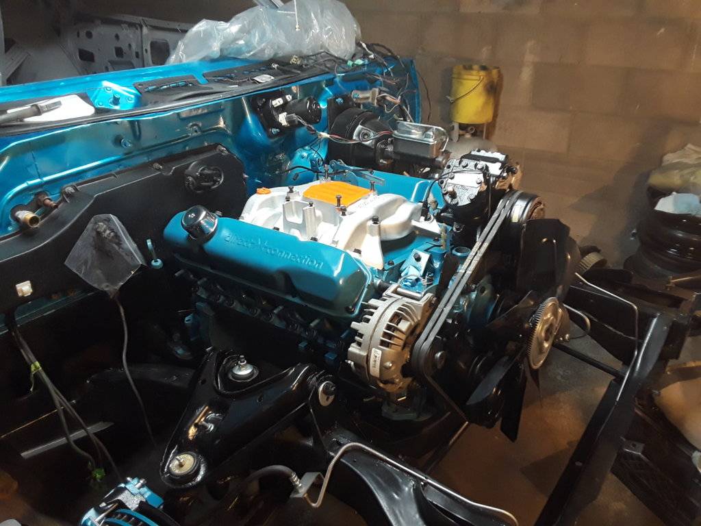

1970 B5 Sport Fury GT...Critters folly....back to basics

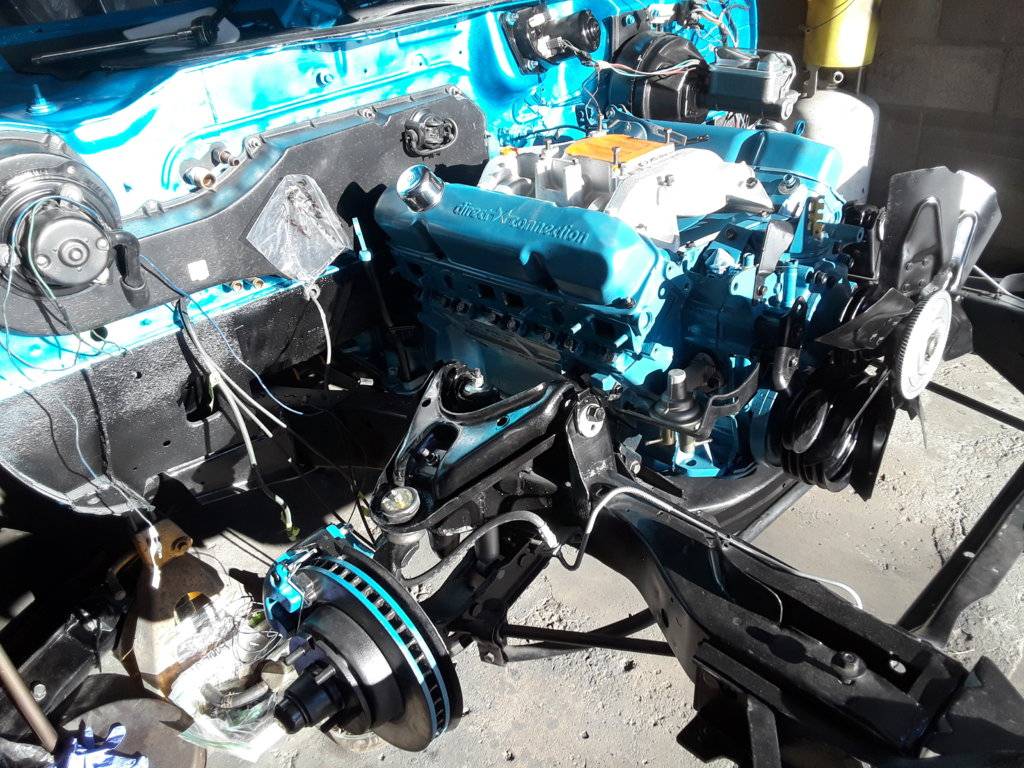

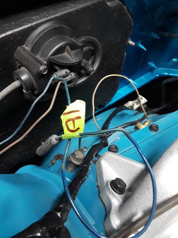

Have a Question.....time delay for a.c. that sits on engine side of a.c. box.....on one of the contacts have a pigtail leading off a it...where dose this lead connect to in the engine bay?
By the type of connector, it's 12V hot, so it's designated to power something independant of the time delay. It may be for an optional accessory your car didn't come with. Hopefully this will lead you in the right direction. What does the FSM Wiring Diagram say?
Sorry I can't be of more help...
Goes to the low pressure switch.
Check the A/C portion of your FSM- "Electrical Control Circuits" to see the connections.
Johns right...found a piec of harness that had time delay still hooked on it and that blue wire ran right to the low peasure switch which was still hooked onto wire...now l know where the preasure switch is...been wondering about that for a few days :O)

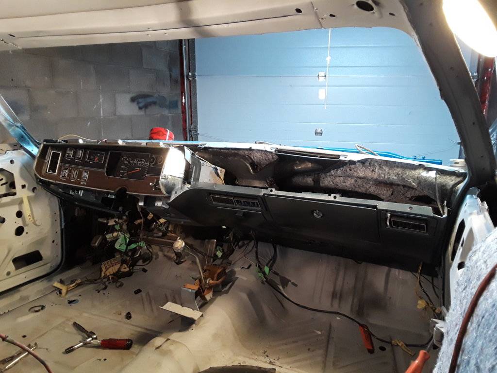

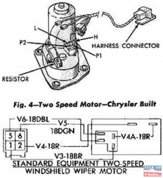

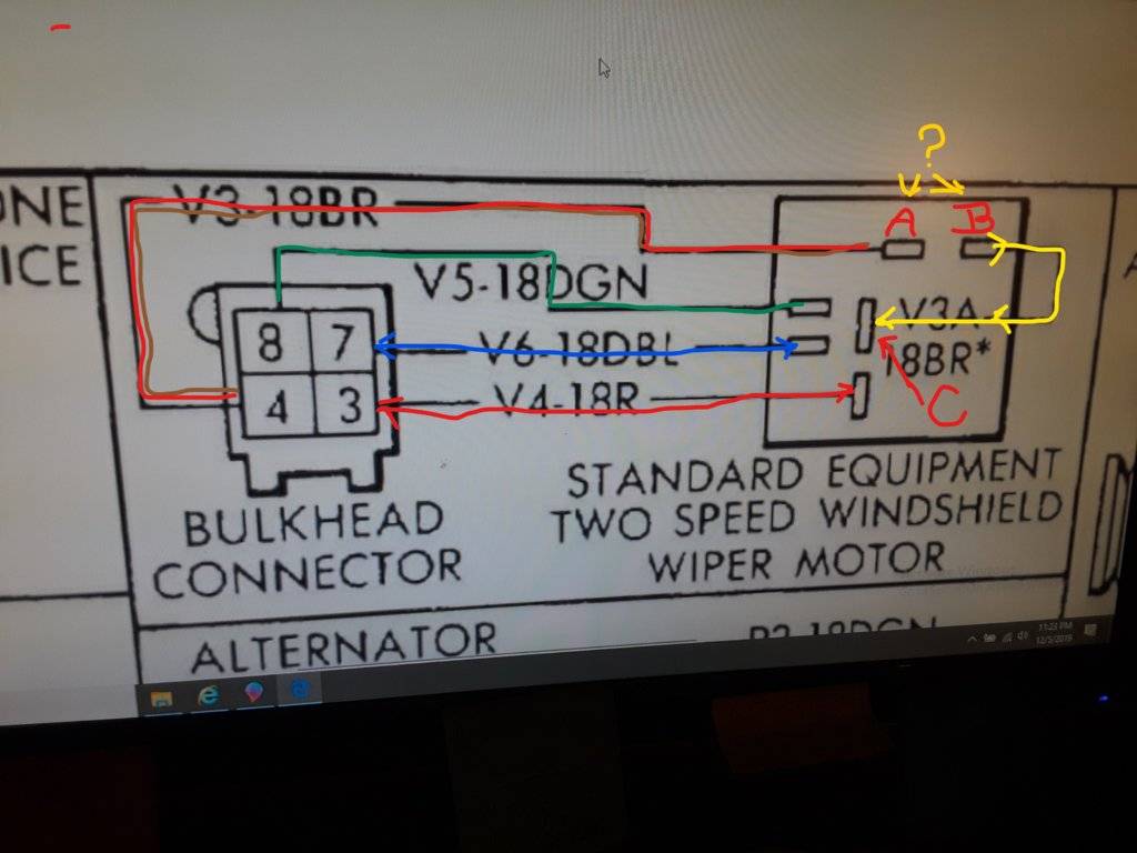

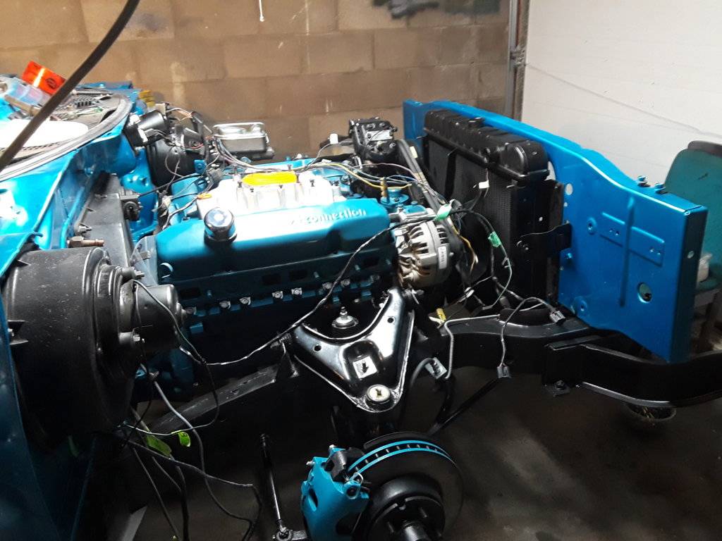

workin with old harness which was melted and harness outa the 70 newyorker and another harness that showed up from somewhere....in any case most of wireing in engine bay is done..little left on the dash to clean up and electricals done..haveing a issue with wireing for wipers l need to sort out...belive service manual only shows a 3 speed wiper and mines 2 argh
info sorted...tomorrows another day....now lm gona need to take off two connectors on there now and see where l screwed up......sigh..two steps forward one step back....:confused::BangHead:

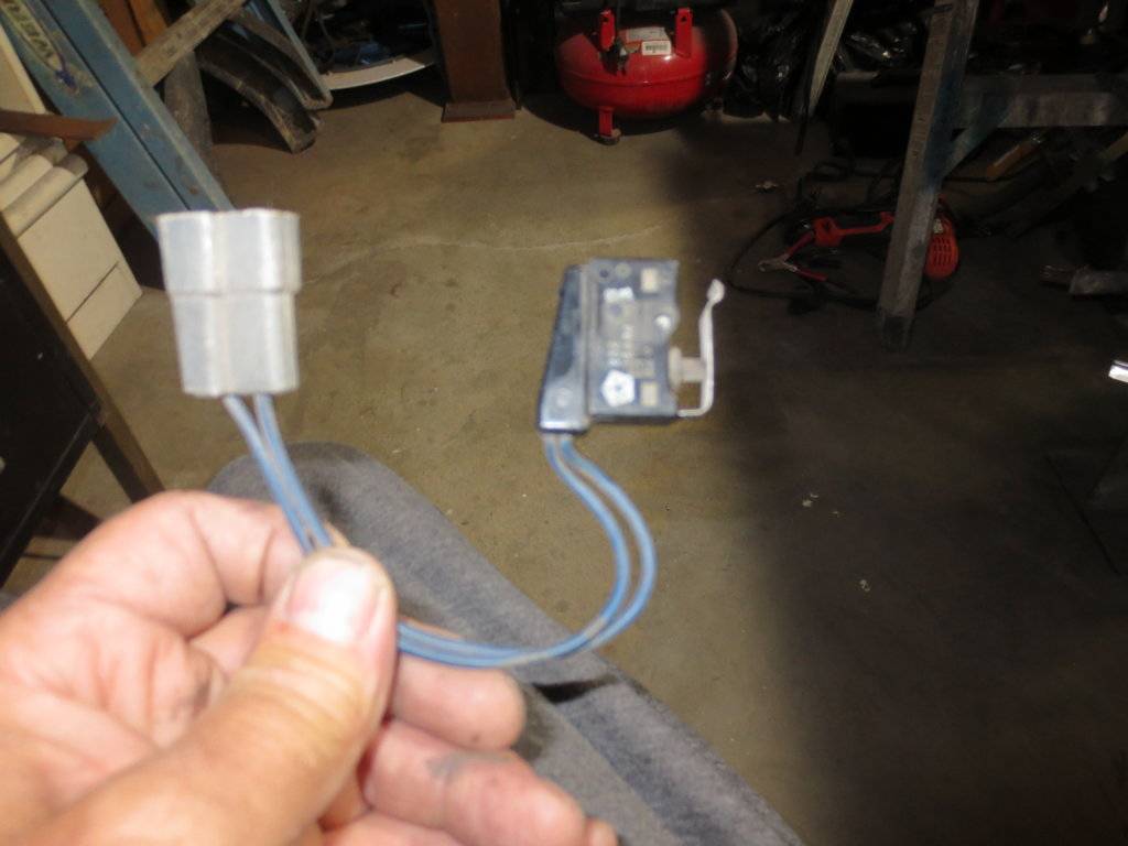

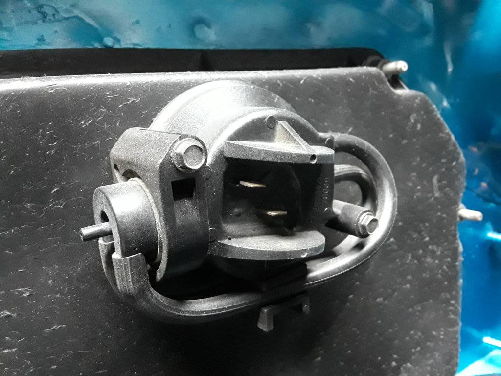

I am going to say no... I have no clue what the switch is.
Only thing I can think of is maybe a key in buzzer switch? maybe someone else can chime in
will grab a better pic..apologies'….bin wondering wtf this is for a few weeks now...thiers door switchs...accounted for...brake peddle switch..not accounted for and that's about it for theses cars as far as l know...only mopars that have been in this garage is furys….even wondering if its even from a Fury or followed me home offa the New Yorker...stumped
Can you read a part number on it D?
