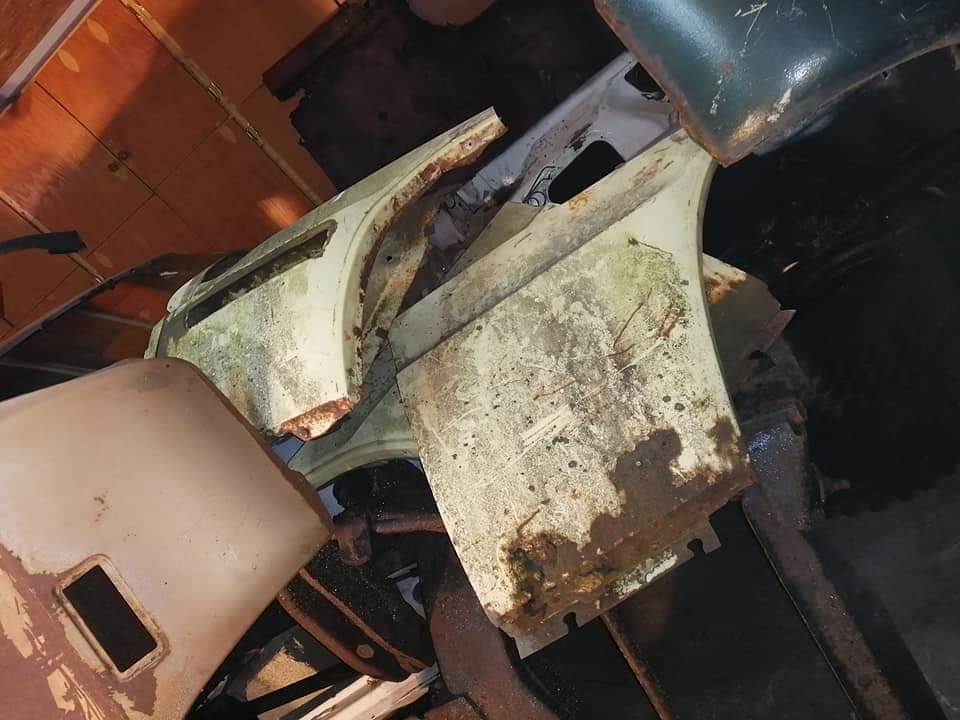

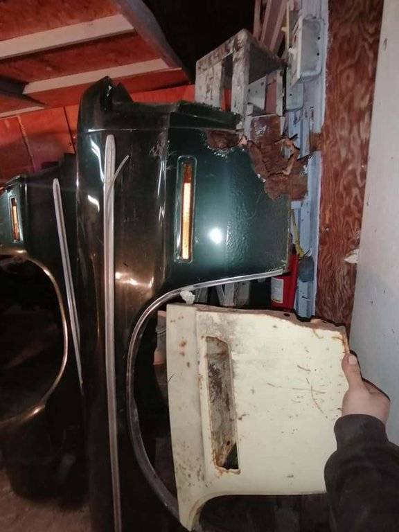

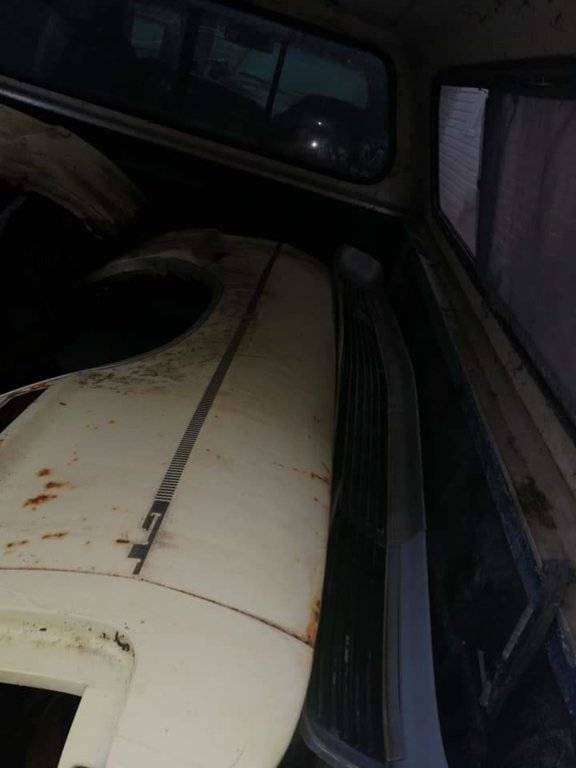

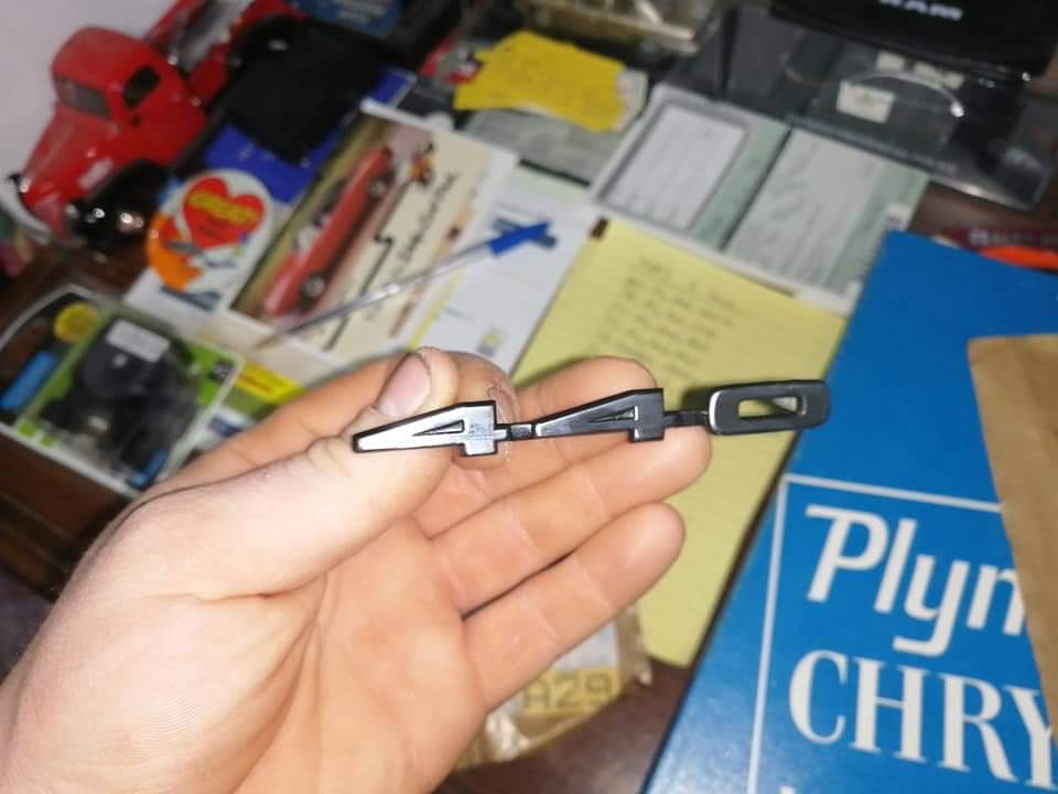

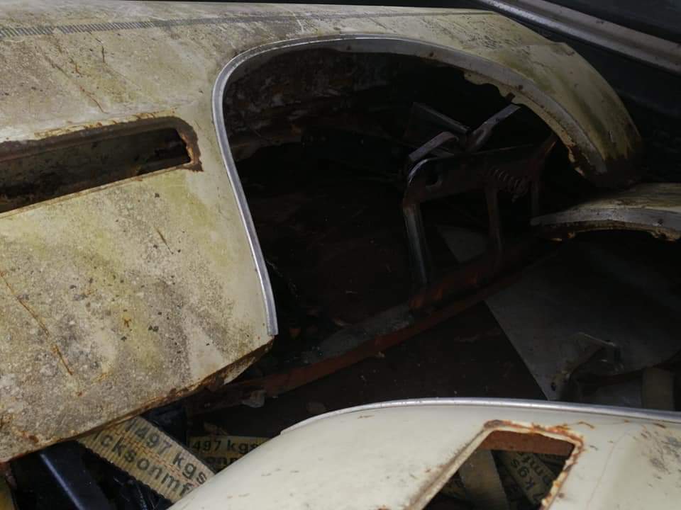

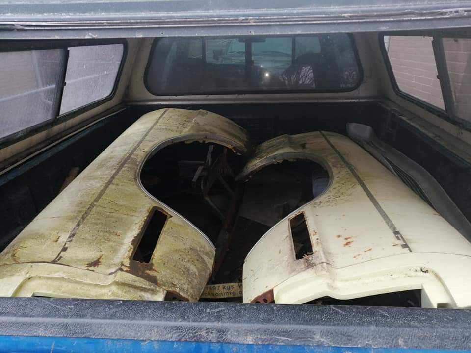

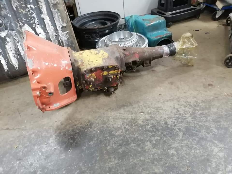

I've got a 69 383 road runner A833 trans, 70 big block bell, I stopped in and got my trunk lid off Dave after nearly two years of it in the corner of his shop, thanks to Manny I have a good rear valance, thanks to Wyatt I have NOS 440 hood emblems, and thanks to Nigel I brought home a set of GT fenders this week and a 26" rad saddle.

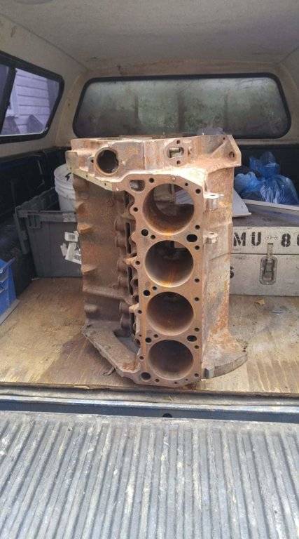

Late 69 440 block

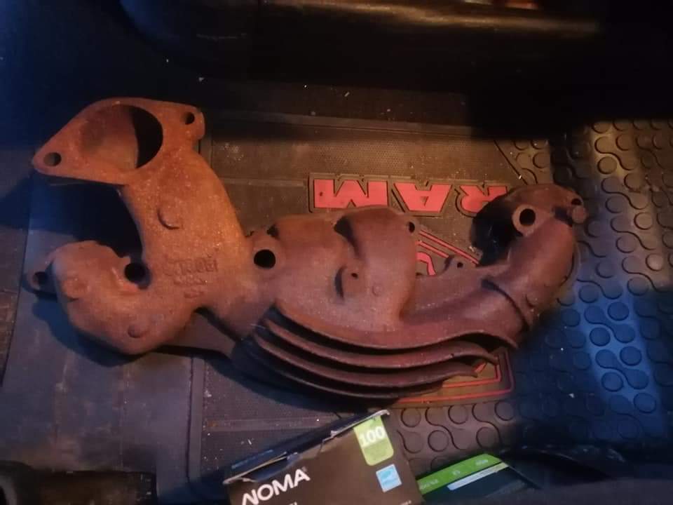

70 date coded HP manifolds

70 A833 B/E B/RB bellhousing
69 B body A833 trans

I'm debating some things on the car, as much as I like doing OE stuff, this car is my play thing, I've been debating whether to sleeve the block and rebuild it to OE 440HP U code specs, but..... I've been reading a lot of Mopar mags lately and I'm starting to desire to build Atleast one big bad machine, I'm throwing around the idea of stroking that 440 and maybe doing 4 wheel disc...

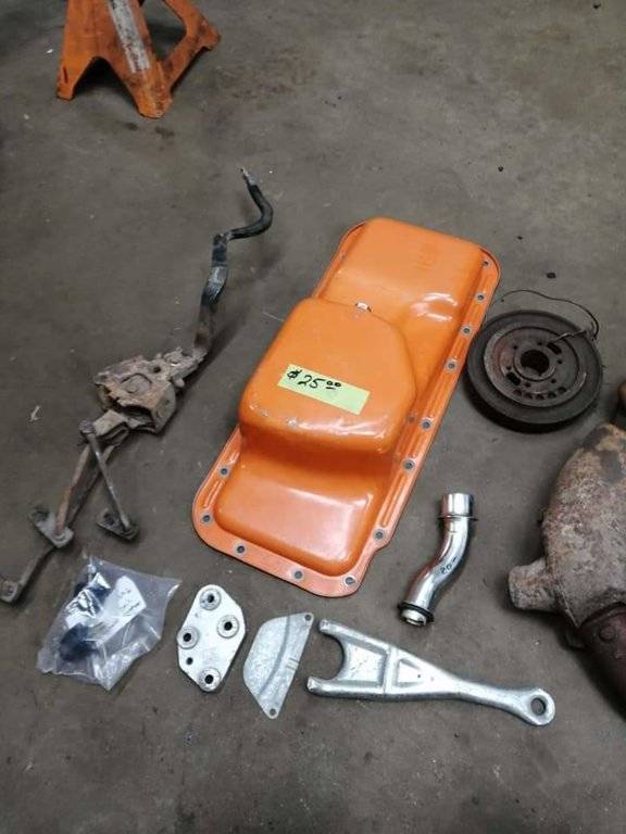

Oh, I bought NOS 440 hood emblems off @71Polara383 a while ago when I was at his place, I chopped up the GT fenders to get the cornering lamp sections to graft into my relatively decent 70 fenders I kept from my green 70....and this weekend my patients paid off, I got an oil pan for the 440 for $25, got a balancer for it for $20, got the fork, mounting plate and shifter assy for $125. I'll have to buy a correct bench seat shifter, but that's okay as I think I want to go with a pistol grip... Oh and I stopped at Dave's shop on my way home and picked up my drivers side manifold that I traded Dave a spare pass side HP manifold for.

Note that your balancer is for a T-Code internally balanced engine. That balancer is fine for that application. Check the casting number on the crank as the forged steel HP cranks are externally balanced and will use a different balancer. That was a good buy on the pan. The 440 HP pan has a baffle at the bottom, the T-Code pan does not.
Dave

My plan is of course to keep it iron headed, I have a set of Aero prepped 452 heads, they've been worked and would be perfect for a big cube 440.
The exterior of the motor I want to look like a bone stock 70 U code 440, now I know what you're thinking, you couldn't get a U code in a 70 Sport Fury, including the GT, well guess what, you couldn't get a 4 speed either, so if I'm doing a what if, I might as well go waist deep.
