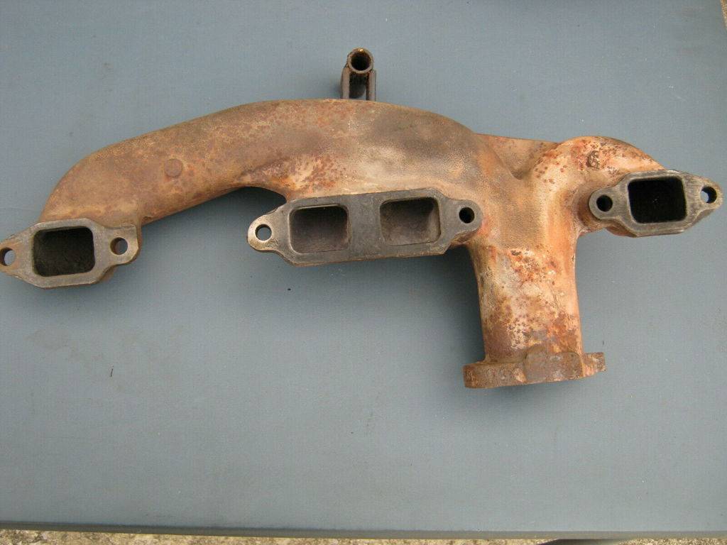

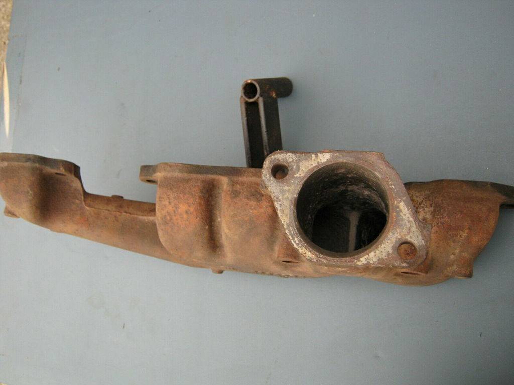

it appears that me and @cbarge have the same right manifolds, 3751071.

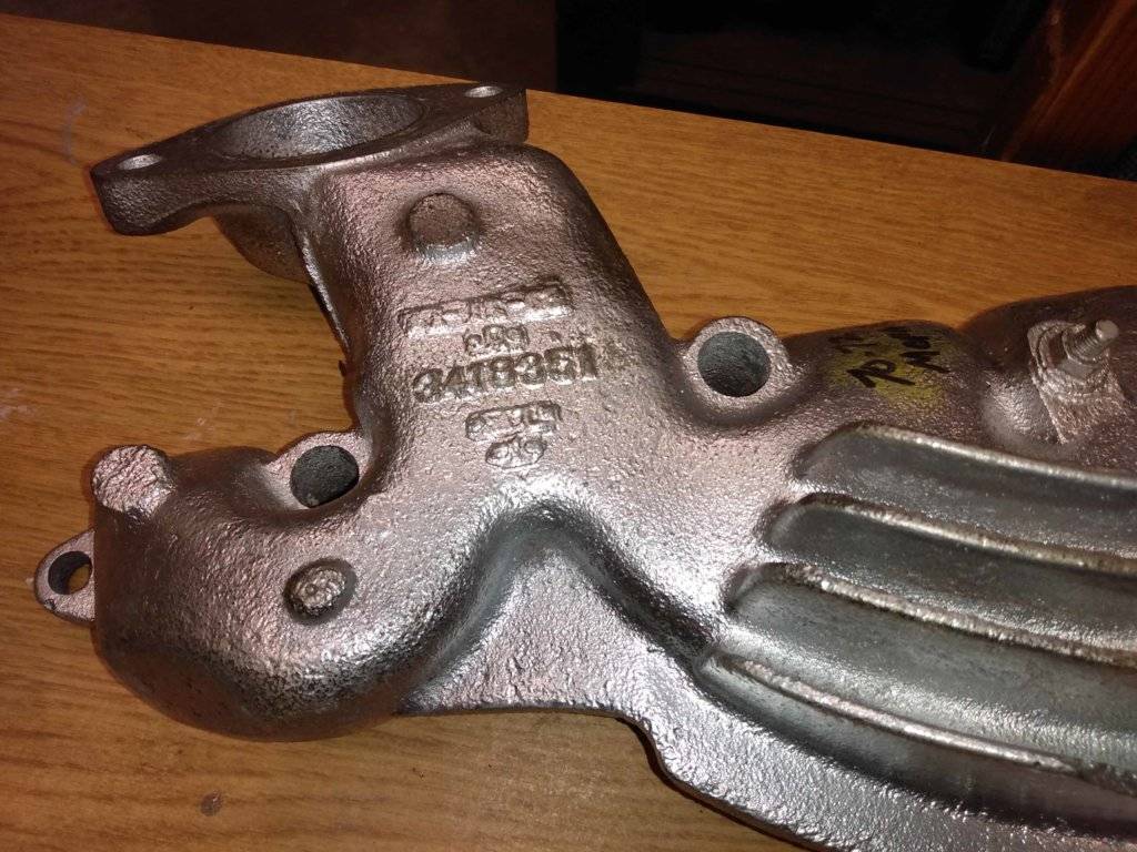

here's a picture of the rear outlet left side in my '69 newport, #2951865-2. according to the list, it's a b-e unit, but it fit the hole. coincidently cleared the hydro-booster.
manifolds purchased from different vendors, same day, swap meet at stafford springs circa 1994. prices lost to memory.

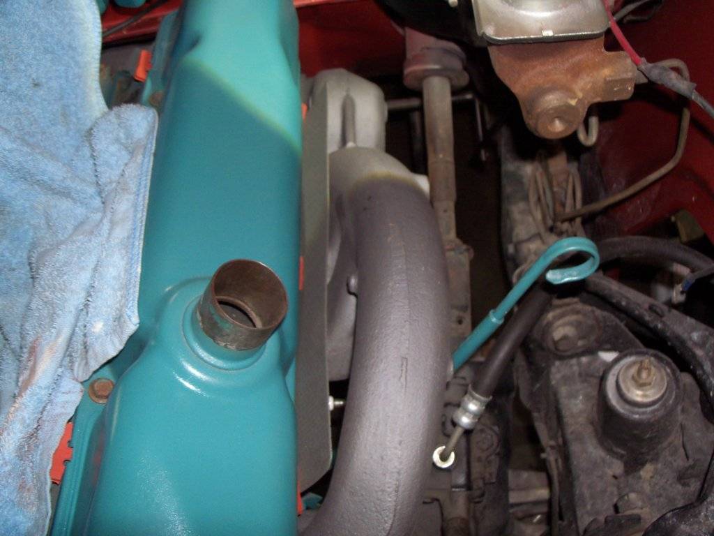

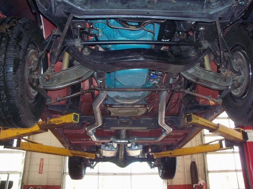

For reference..the left TTi pipe mating up to the HP manifold. Note thick flange and lots of clearance near the torsion bar.
Not seen from the top but here you can see the spark pug heat shield bootie on #7 wire. HP's can and will burn wires!!
Mini-starter equipped,I moved the wire harness outa the way of the larger than stock pipe...

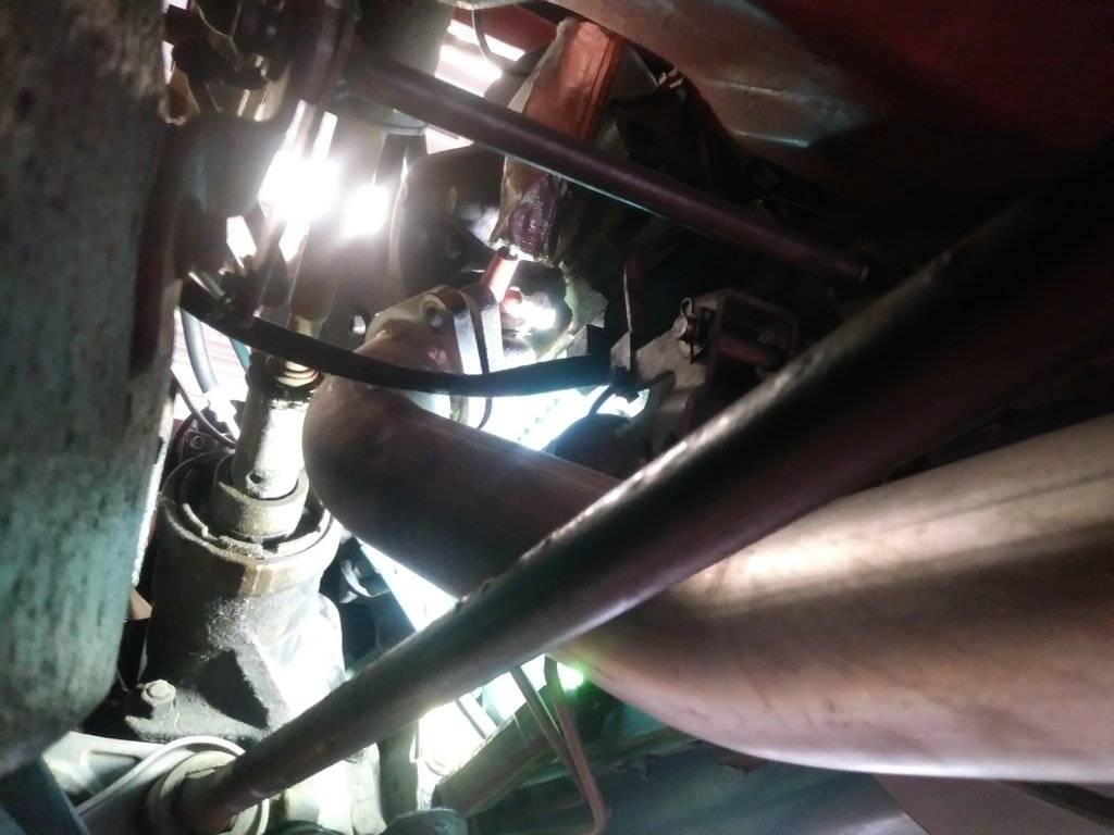

View of the front pipes from under the front...

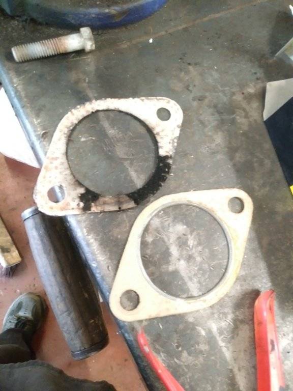

Also get good quality flange gaskets that have a metal ring around the inner diameter..
The el cheapo paper ones that came with the TTi kit burned out..

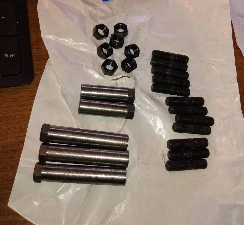

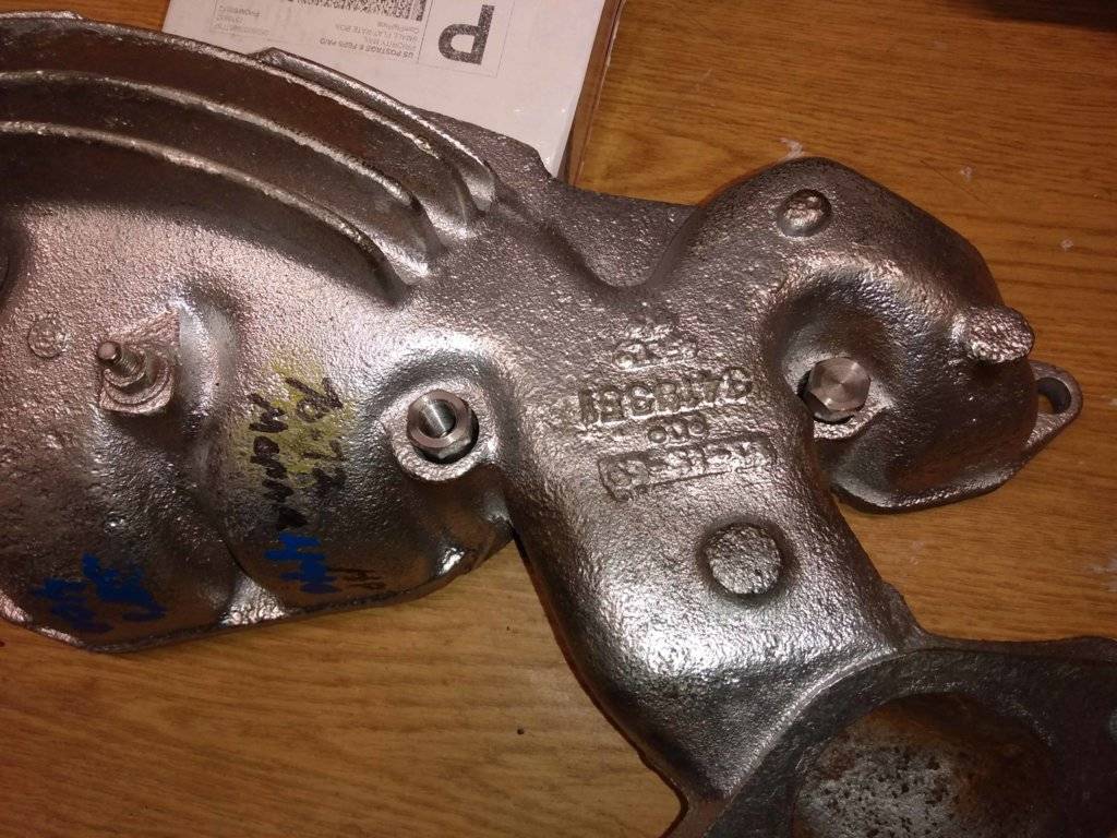

Washers for Manifold Attaching Fasteners?
@cbarge, @CanCritter, Brian, Scott and others. Do you use washers with the long hex head sleeve attaching nuts? If so, what kind? Looks like holes in LS HP manifold are too wide for small hex to seat against. Thanks, Ben
Hex head nut/sleeve/adapter holes do not look smooth like drilled out. (ebay seller applied cheap aluminum spray paint)
Kit from Tom Hergert, Rocket Restorations, Olympia Washington
As Lea says no washers needed on the long barrel nuts, but do put a bunch of high temp copper never seize in there though. ;) If I was to do any type of washer I would use a copper washer.
