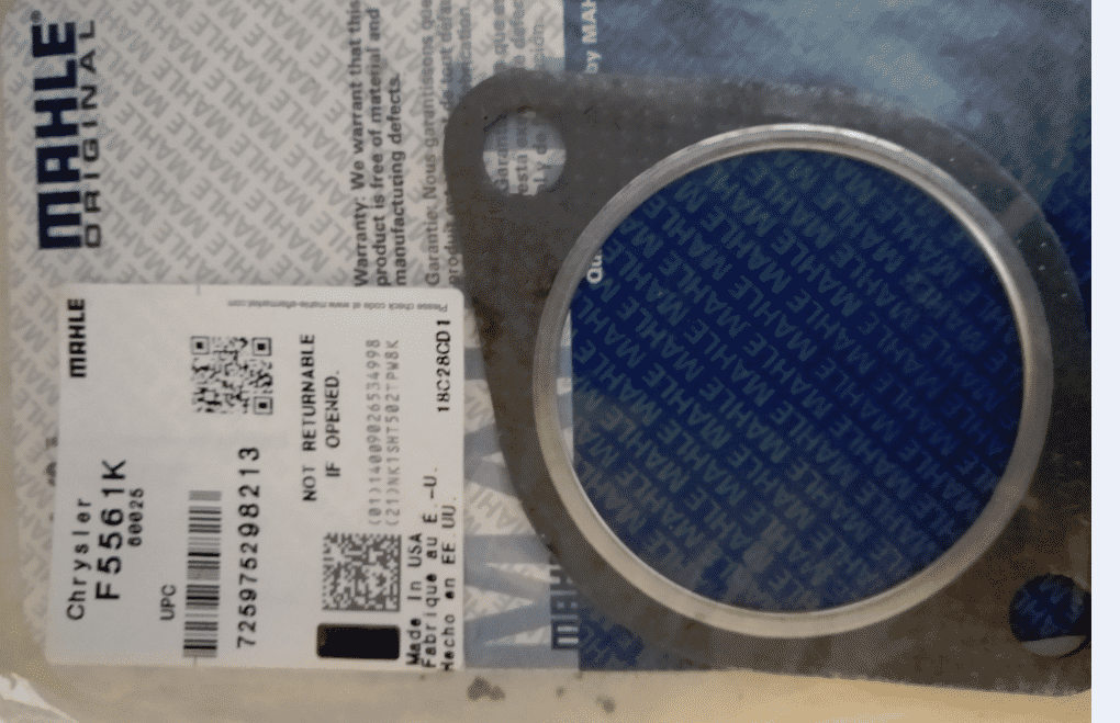

I've had some issues getting a proper gasket for the manifold to head pipe connection of late, they kept blowing out. Think I finally found the good ones again, now I just need to get it on the road long enough to make sure it lasts......
What part brand and number did you find?
Mahle F5561K
It has the stamped metal ring that I hadn't seen for a while. These are the usual finds and you can see the typical old one vs the new one on the countertop:
