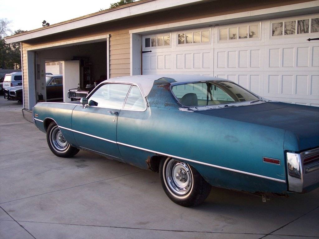

My body/paint guy didn't flinch at the rust repair needed, and he thought it was a cool car - so the project is off to a good start!
They say it never rains in California, but it does snow.....................just before the Newport arrived.............. :wideyed:

Do we have any progress updates yet?
Yes, I have been spending a little time here and there while I work on other projects as well.
To date, I now have it running very well and had to replace the starter and I used the smaller high speed/torque starter type that I don't care is not original, I just like them a lot better than the originals and they are not so obvious to see.
I also changed the coolant which was pretty good already and changed the dirty oil with some Valvoline VR1 20-50 racing oil and anti-drain back filter, and changed out the fuel.
I also replaced all the brakes/lines as needed for now on the car so I now have full working brakes and replaced the brake light switch with a new one.
I fixed all the oil leaks as well which included replacing the front shocks (I have never had one of those leak before!) and also replaced the input shaft and lower sector shaft seals on the power steering gear - no more leaks - nice.
Cleaning the interior was also a priority since it was very dirty and there have been mice in it in the past, so now I don't have to grimmace when I get in the car.
The sunroof tracks were also cleaned out and some graphite grease was used to lube the tracks and chains as well. It works just like new now, and better than the one on my 71 New Yorker. I do have to replace the headliner but that can wait until I do the full restoration.
I also had to replace one of the window regulators so now it works properly and the windows go up and down easily, like new after cleaning and greasing the mechanisms and while I was at it, I put on the correct outside review mirror - I couldn't stand looking at the incorrect one a previous owner put on the car.
I also found a build sheet in good condition under the rear seat!
The transmission was replaced somewhere along the line but when I took it out for a spin, it worked fine. The steering is precise and tracks nicely and there are no squeaks/rattles or other significant issues. The engine is original. There is no doubt this car is its original 41K miles though.
I also located and bought the last piece of NOS driver side rear quarter molding in existence that I could find so all the trim is now present and accounted for.
Here are a couple photos of what it looks like now, but not too much different on the exterior since it will be fully restored later, but I did put the trim piece in place so it looks normal, but did so only temporarily until the body is restored and when I will have all the clips on so it aligns correctly with the door trim.
So that is all I will likely do for now until the full restoration is started. I just wanted it to look OK and the interior clean and have it running nicely before storing it for awhile.

That is awesome that the sunroof only required some cleaning and a lube and now works like new! Car looks great even now...Congrats again on the acquisition.:thumbsup:
Gee... what happened to the nifty hood pins? :lol:
This car has won the lottery AFAIAC, good to see her in the right hands. :thankyou::thumbsup:
That is one bad *** newport.
Any idea when you will do the restoration?
Looks great now!
Thanks, as I really love the car and especially in turquoise!
I was actually out driving it today - with the sunroof open. It was my birthday so I enjoyed myself! The experience of a 383-4 bbl package is unique and very enjoyable. :steering:
The timing of its restoration is uncertain but I do want to do it sooner rather than later.
It may look great now to you but it is the most rusty car I have ever had, and it isn't really that bad either (i.e., that I am going to keep - I have had more rusty parts cars). We are just spoiled out West in that regard.
