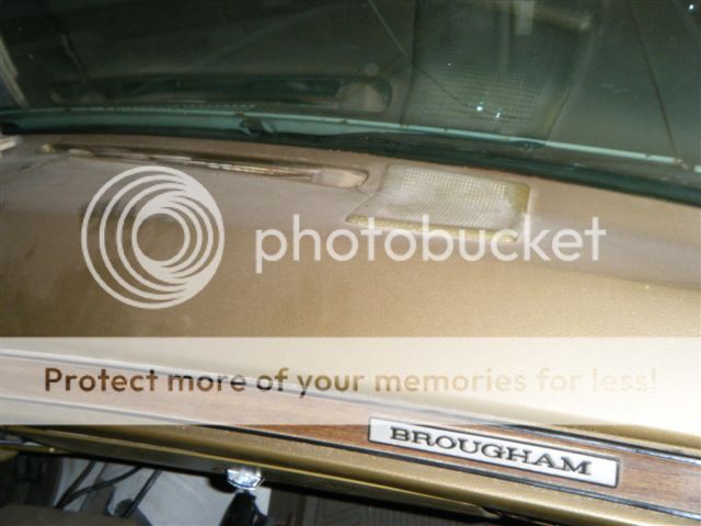

k ..small set back...woulda sworn interior paint color was ember gold 666 but Paul just tried paint l had sent and wasn't even close....need to nail down this color and hopeing someone heres had to deal with it at some point
after dash color thanx...actually is probally faded mayby...where can l find interior paint color code?...will it be part of Tag?

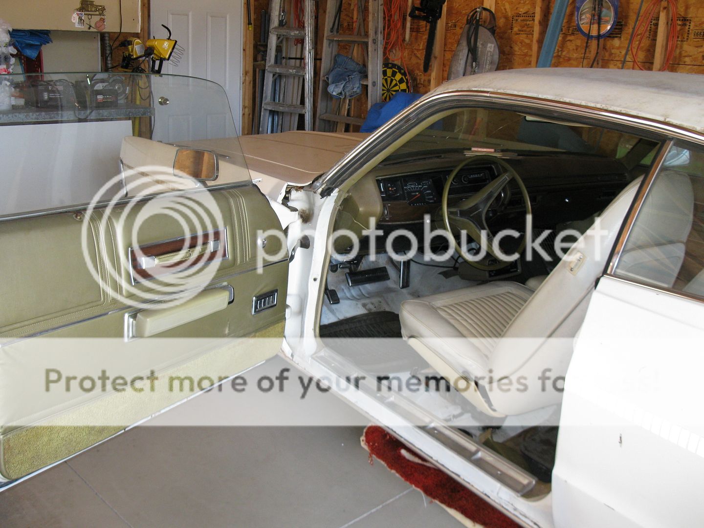

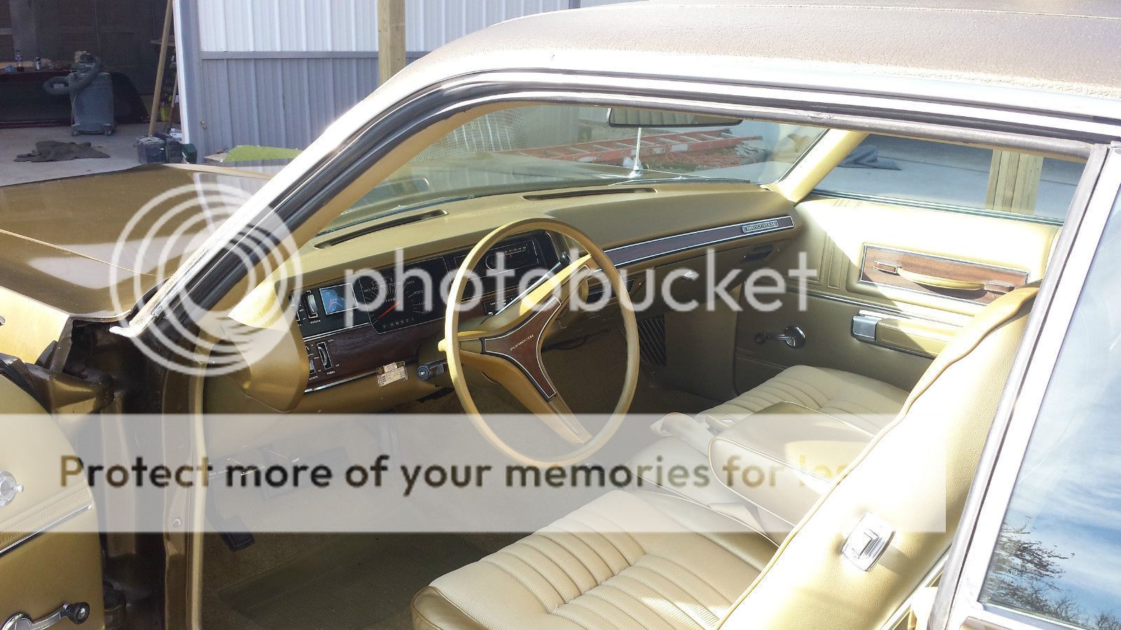

this pic below was from another 71 fury that was posted up in the forum last summer..is pretty well what my interior should look like and color...anyone have a color name or code? thanx
I went through this trying to match the interior colors up on my 300. After several false starts and $$ later, I went with an alternate color.
What I did find out was SEM will give you a custom formula based on a sample. They told me to send in something for them to custom match and they will send it back along with the formula. The issue is then you have to find someone that can mix the SEM formulas.
I'm told that a really good, well equipped paint shop, that sells Dupont, may be able to do it too.
I didn't do any of this because so much of my interior had already been painted/dyed/faded, and I had no really good sample to work with. I ended up with an off the shelf rattle can that I like.

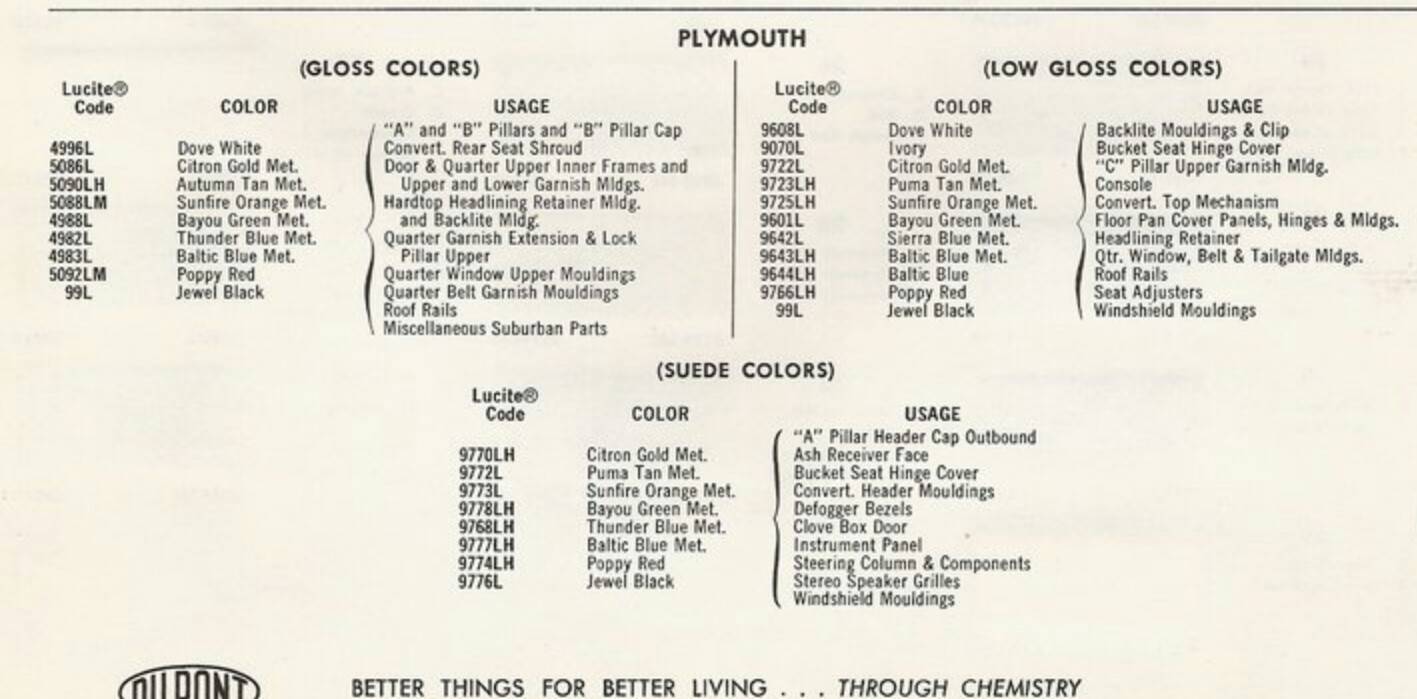

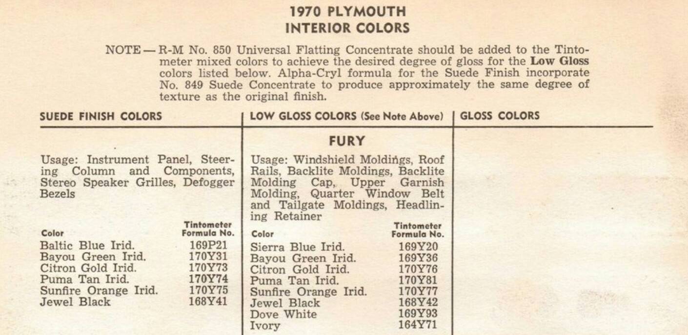

see the used on parts above they mention what color to go where and on what piece..unshure of door panels

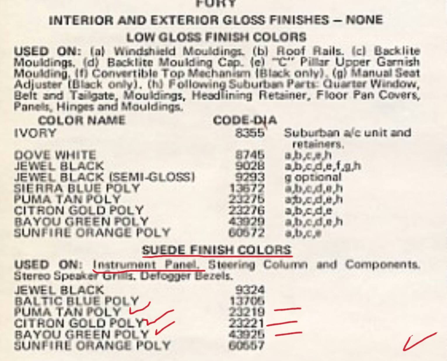

No, I'm reading that the dash is suede, not, lo-gloss.
Unfortunately, I can't find one damn sample of 1970 interior colors.
