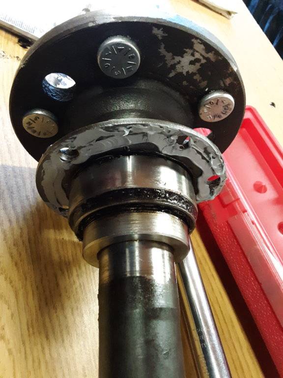

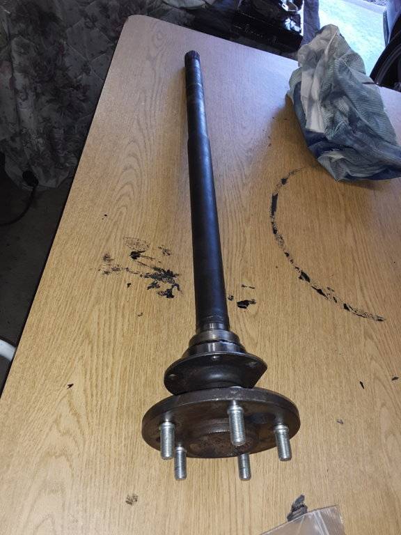

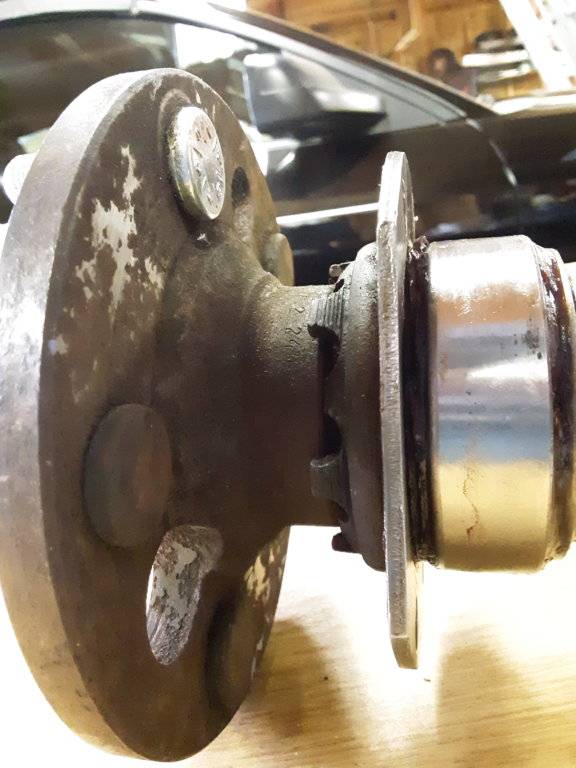

Axle Shaft , LS. Bearing previously greased. Took shaft out of the 2 old pillow cases I had wrapped around it. Removed plastic bag around studs, flanges, and bearing. Wipe bearing flange with rag.
LS, non-adjustable bearing
Permatex Ultra Grey RTV on inside of bearing flange. I had previously wire wheel cleaned 5 NY 9/16 nuts.
Axle housing: lube axle shaft oil seals and bearing race mounting area with light coat of wheel bearing grease.
Axle Shaft: took a few taps with hammer and punch, but LS shaft flange seated OK., 9/16 ls, 10 ext, 3/8 SR. Tighten nuts to snug and wait for an hour to torque. Permatex requires that time to set up. Axle Shaft Nuts: 35-35 foot-pounds, 9/16 ls, 10 ext, 3/8 TW
LS Drum, we're getting closer. Gotta fight impulse to rush things.

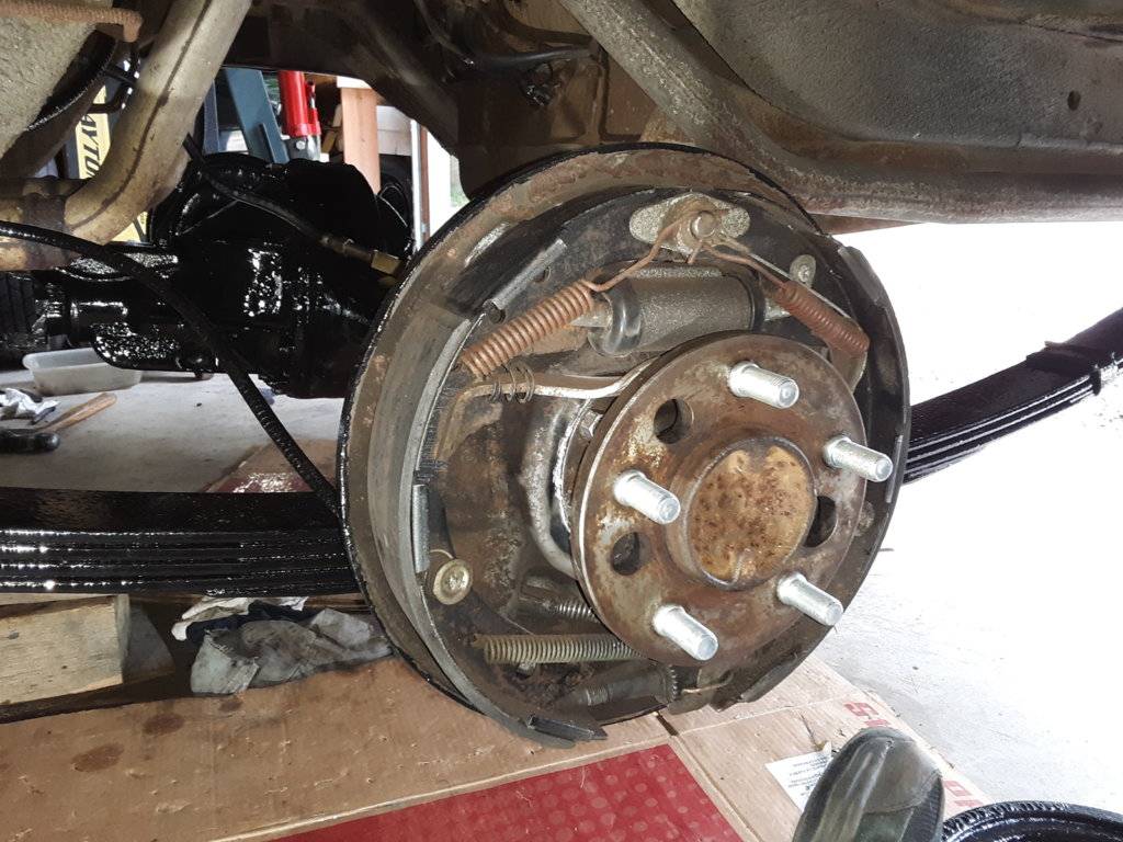

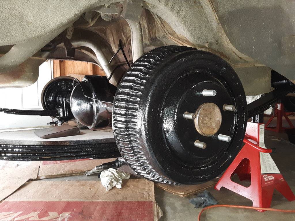

Axle Shaft, RS: same as LS, except while torquing, turn adjuster clockwise to eliminate all play in-and-out in the axle shaft. Then back off adjuster (turn counter-clockwise) in small increments until smallest amount of play present. Try torque nuts. 1st few tries, play will go away. Keep repeating process until very small amount of play still present after torque at 35’lbs.
Adjuster

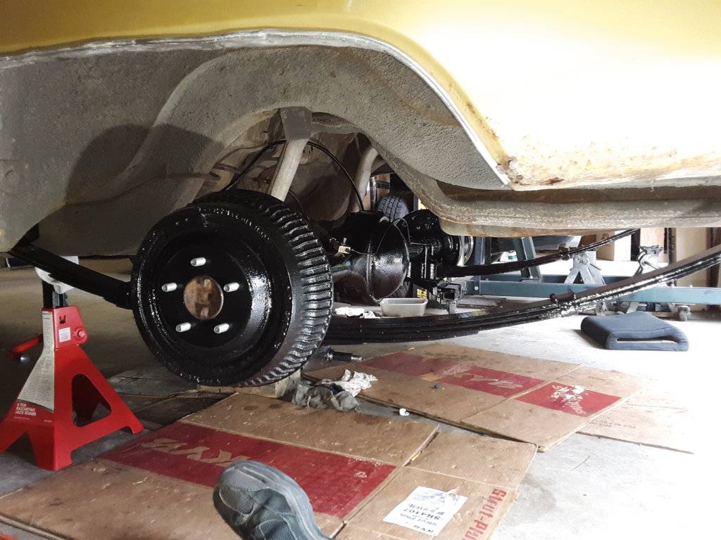

Axle Shaft, RS installed. Can see bottom of adjuster clamp
Adjuster & Clamp close up. Mounting nut has built in washer.
RS Drum

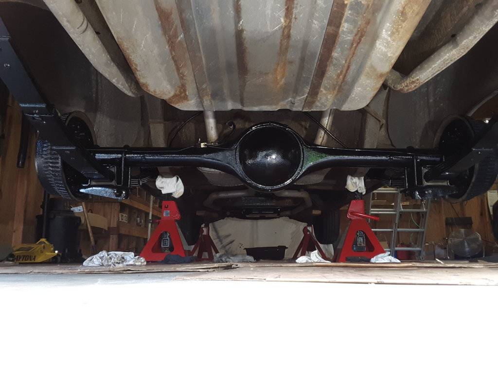

Rear View

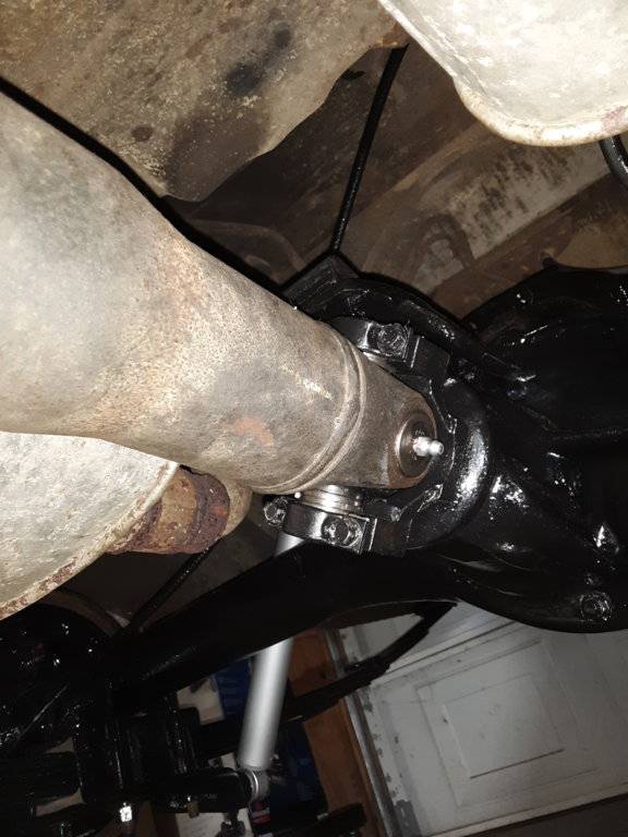

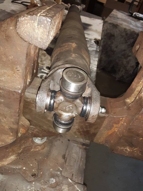

DRIVESHAFT

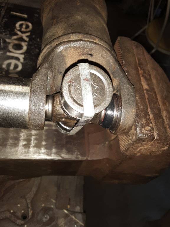

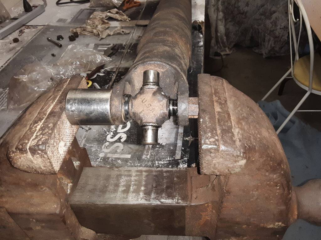

Rear U-Joint Remove
· 1st Cap Remove:Vise Set Up: 1 1/8" short socket around cap, ¾ nut against opposite cap
· Close Vise: 4 light Hammer strikes on forward vise arm, dislodge cap. After cap moves slightly inward, 2 FBSD to remove C-Clip on ¾ nut side. Flip driveshaft 180° so c-clip removed side facing 1 1/8 socket. ¾ nut side to move 2nd cap slightly inward and remove 2nd C-clip. No hammering. Also, 5/16 ls, ¼ R to remove grease fitting. Otherwise, it blocks movement of u-joint cross.
· Continue to tighten vise until 1st cap moves into 1 1/8” socket. Open vise & Remove 1st cap from driveshaft yoke
· 2nd Cap Remove: rotate driveshaft 180° so that 2nd cap faces 1 1/8 ss, ¾ nut on opposite end of U-joint cross. Repeat above. Remove cap and u-joint cross

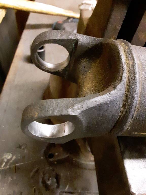

· Sand & grease: 240 grit sand paper to sand driveshaft-yoke u-joint cap mtg areas smooth. Grease

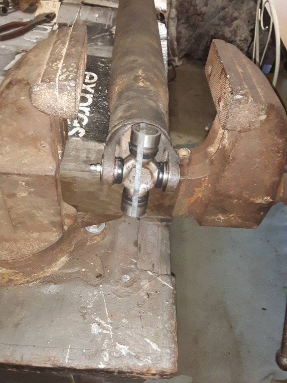

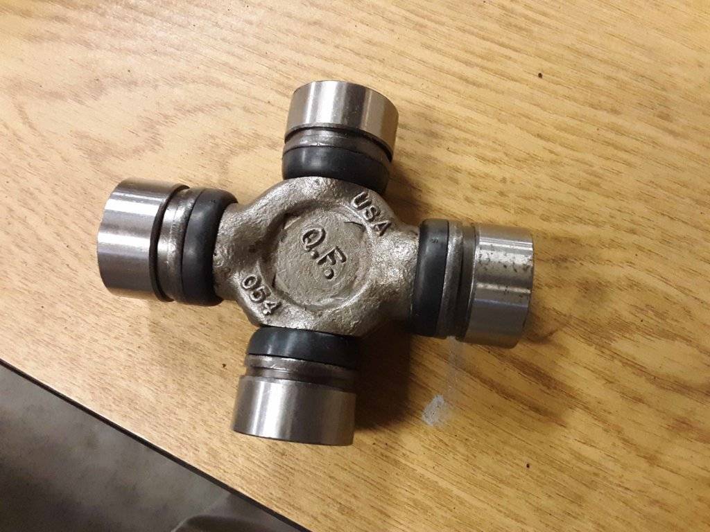

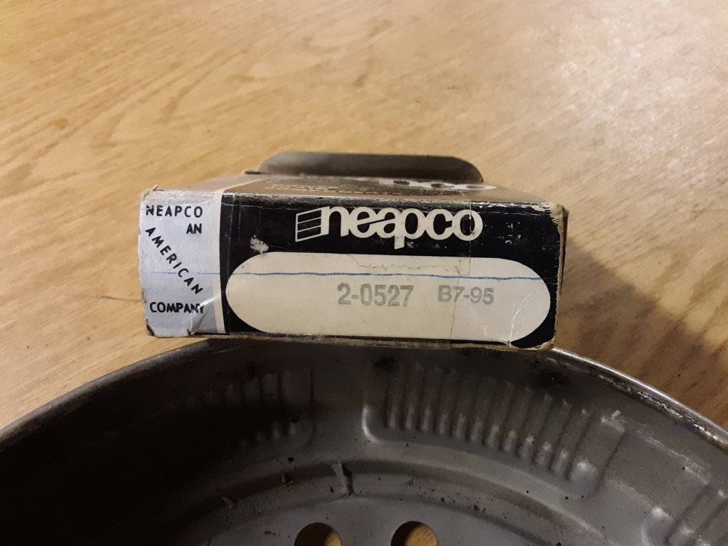

Conversion U-Joint Neapco 2-0527
· Driveshaft Yoke: u-joint 2 1/8” inner lock to inner lock: Neapco spec 1.078” smaller diameter cap
· Pinion Yoke: u-joint 2 5/8” inner lock to inner lock, larger diameter cap, Neapco 1.126”
IOW: 8.75 set up for larger width Mopar u-joint. 8.25 set up for smaller width Mopar u-joint. (There was nothing wrong with old u-joint. It just didn't fit 8.75 pinion yoke)
Made in USA
· Remove caps from new U-Joint. Pack caps wheel bearing grease, coating around inside of cap roller bearings.
· Place narrow width side Neapco U-Joint 2-0527 in center of driveshaft yoke and finger press smaller diameter cap, (2 1/8” inner lock side) into driveshaft yoke. Gently push cap into end of cross. I did grease fitting side 1st. While holding cross against cap, vise to press cap in place, with 1 1/8 socket on other side. Stop cap press as soon as c-clip can be installed. Install c-clip
· Install grease fitting on cap just pressed in, 5/16 ls, ¼ R.
· Repeat press for 2nd Cap. Had to use ¾ nut and 4 light hammer strikes to get 2nd cap to seat enough to install c-clip
· Install c-clips on pinion yoke side of u-joint
Driveshaft Installed

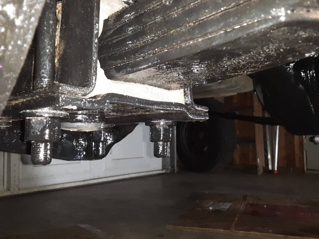

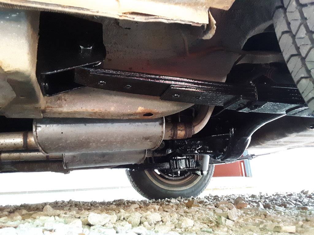

U-Bolt Threads, POR-15, 2 coats, rust prevent

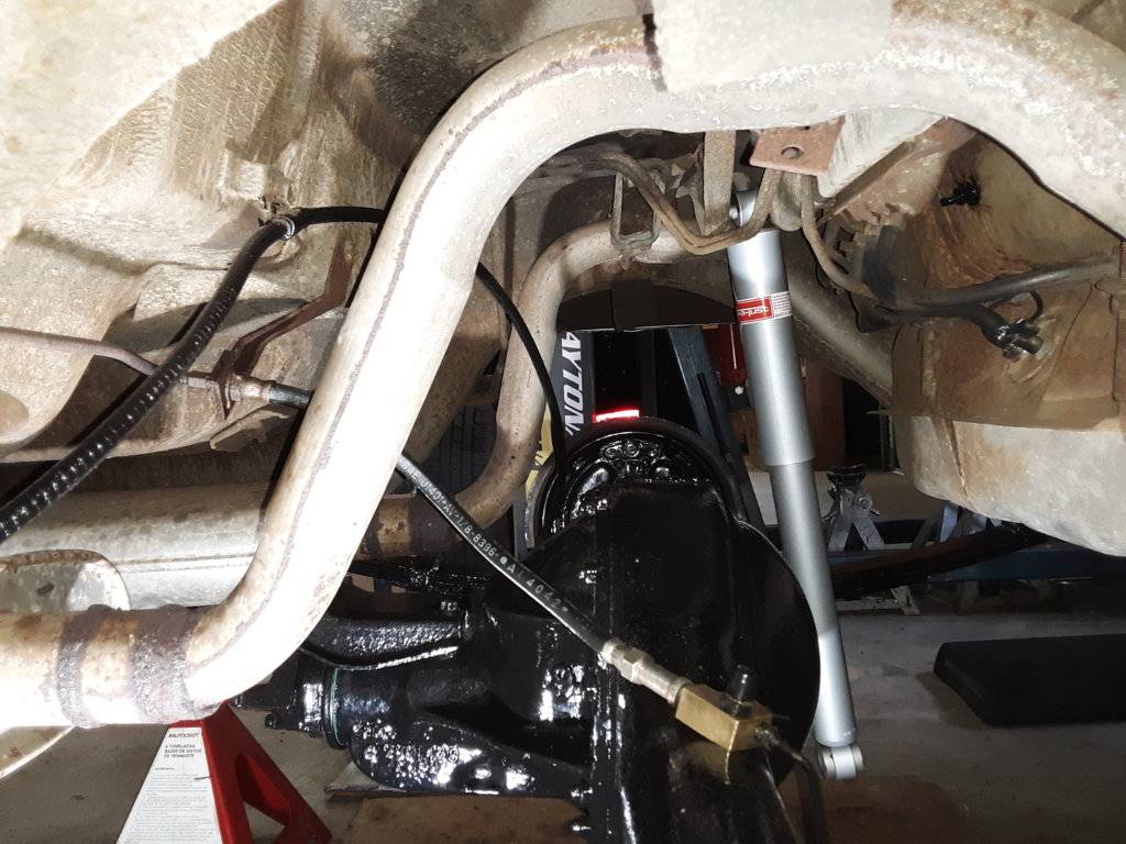

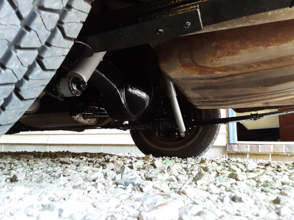

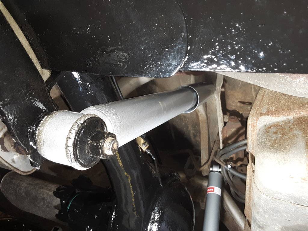

KYB KG5512 Shocks: a problem
Rear Shocks
· Shocks: upper mount: bolt head forward, 19mm ss, 1 & 3 ext, ½ BB, nut ¾ ss, ½ R, ½ TW @ 70’lbs.
· Shocks: lower mounts, ream front washers, drill. Install front washer, shock, rear washer, nut, ¾ ss, ½ R & TW @ 50’lbs.
Right side, jack under spring to install. Shock at full extend is 2-3" to short to reach mount.
Rear view
The Problem
· Tires, install: left side tire installed normally. Could not install right side tire because of interference from the rear wheel well.
· Shock Absorber, right side: hydraulic jack under leaf spring. Three-quarter long socket, 6 inch extension, ½ ratchet to remove nut at lower bushing. Pull shock to rear, so it’s disengaged from its lower mount. Lower hydraulic jack so that leaf spring is at the bottom of its travel. Shock absorber is about 2 inches short of the bottom of the leaf Springs travel, as it was at 1st install.
· Tire, right rear: install, no problem
· Shock absorber, right rear: reinstall with hydraulic jack under leaf spring, ¾ long socket, 6 inch extension, ½ torque wrench a 50 foot-pounds. Remove hydraulic jack. With rear axle hanging free both shocks were 24 inches end to end.
Distance edge of bead seat upper center wheel well lip, 3/16" shorter on RS.
Rock Auto may get these shocks back, although they ride really well.
GOOD NEWS
· Test drive, 12pm: no clunks when shifting into gear, including reverse. No noise at 70 mph on highway or any other speed between zero and 70 mph. I yelled OWWWOOOO & AWLRIGHT several times and drove home after 5-mile 360 loop.

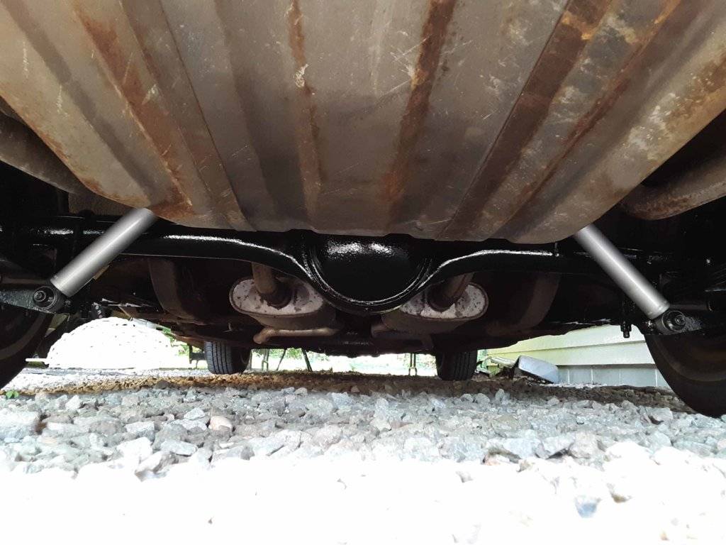

All you can see from below

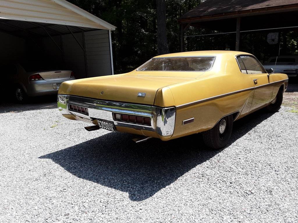

Stance (rear slightly raised by shocks?)
Front (nothing changed, but it's still cool looking)
A Welcome Sight
@LocuMob, you might not say it looks like a different car, but it makes less noise and it's much better looking underneath. Also, I don't get greased by working near the rear axle. Hope you get some encouragement out of this.
